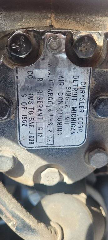

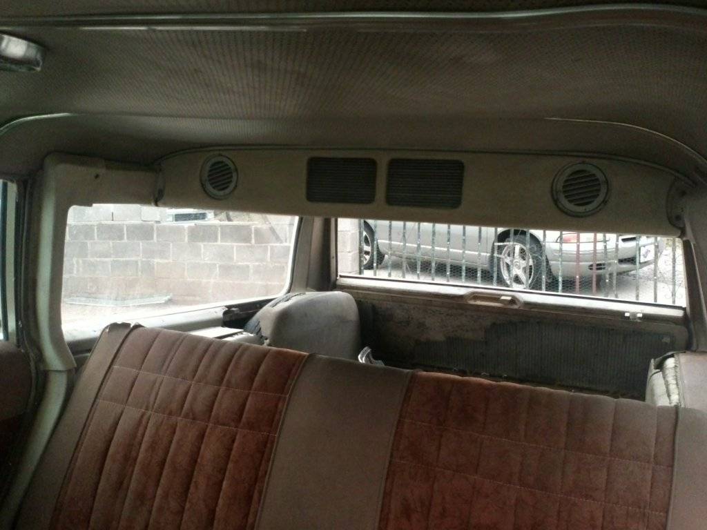

How do I read on this rear air conditioner in my 1968 plymouth sports suburban station wagon c-body 383 4bbl and how easy is it to convert or should I look for someone that adds R-12 to recharge
R-12 dual evaporator units will usually fail if you convert them to R-134a. It is really difficult to get all of the mineral type oil out of a dual unit R-12 system prior to converting to R-134a. Any oil left in the system will turn into a jelly like snot that will not circulate and the system will likely die of oil starvation. Even with the old oil removed, R-134a is a less dense refrigerant that does not circulate oil very well, especially on dual unit systems. Ideally, you should find a shop to evacuate the system, replace the filter dryer. check for leaks, recharge the system with fresh oil and recharge it with R-12. There are also some R-12 replacement gasses available that will work better in these old systems than R-134a. R-134a is in the process of being phased out anyway. R-12 replacements are a mostly Propane/Butane blend, so there is a potential fire hazard if the gas were to happen to leak out around an electrical arc or an open flame.
Dave
Decipher the remains of the tag on the a/c compressor as to how many pounds of R-12 the full system takes. Nothing on the vehicle data plate for this.

Dual AC systems such as that have their charge weights on a tag on the compressor - there is no information for that on the fender tag you posted. Typically, the dual systems in our C bodies used roughly 4 lbs of R12, but that's really not required information - yet.
First, the system has to be evacuated and see if it holds a vacuum. If it doesn't, there's a leak which needs repairing. This should be done by an AC shop - they can fill the system with an appropriate gas with a dye in it that shows leaks with UV light.
Once the leaks are repaired and the system holds vacuum (AND the compressor is able to do its job, and the pressure valves function), then you can charge the system.
Most charge weights are generic - meaning one size sort of fits all - but the best way to charge the system is to put in about 50% of a charge and start watching the temperatures at the vents. Gradually add a bit more refrigerant, and as the temps decend, watch for when they bottom out and start to rise. Take a bit of refrigerant out and that's where your system will operate the best.
