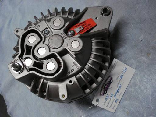

It's mostly a matter of changing the stator. The stator is the piece that's sandwiched between the case halves.
IIRC, the higher output stators might be a little thicker so, yea, it does make the alternator slightly thicker. The split bushing on the mounting ear on the back half slide to compensate though, so it all mounts the same.
This shows the split bushing.
