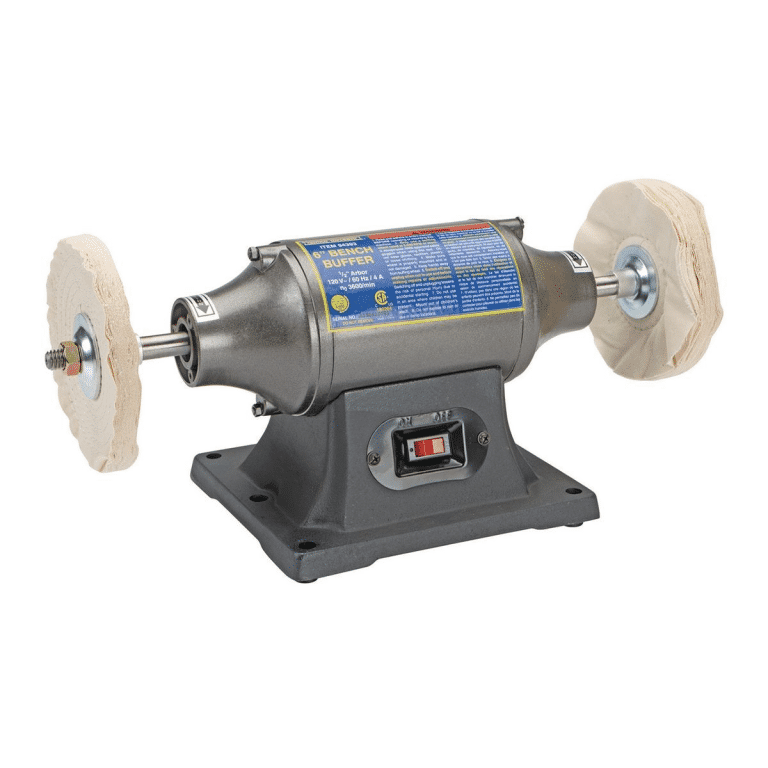

I use a Harbor Freight buffer and buy supplies from Polishing - Page 1 - Caswell Inc Don't waste your time and money trying to use a drill... They have some "how to" guides and there's books available too. I used to have a good PDF guide, but it must have gotten lost in the shuffle...
The trick is using the correct wheels and compounds with wheels dedicated to certain compounds. Hang on to the part... Anyone who has done this and says they never launched a part across the shop is lying.
When done correctly, it looks as good (or better) than new. It does require some protection, like a good coat of your favorite car wax.
BTW, you can also do the stainless steel this way... Just no need to strip anodizing (obviously). Just can't do plated SS, but I haven't seen plated SS on cars since the 50's.
My buffer... If I had to do it again, I might buy the larger version as that swings a larger wheel. The larger the wheel, the faster the speed at the periphery of the wheel. I do use 8" wheels on mine, but it doesn't like it and gets a bit warm.
