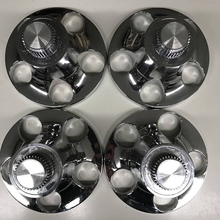

The AMC cap is one piece, not two pieces like the Chrysler road wheel center cap. The dimensions are very different as well as seen above.
Motor Wheel produced the AMC caps for the aftermarket as well at the time without the metal bands used by AMC. They also made the similar looking but completely different center caps for our Road Wheels. The greater volume from the aftermarket plus AMC and the fact that they were a one piece part made them much less expensive to produce than the Chrysler caps.

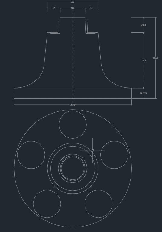

I'm looking at the comparisons and thinking about how they could be made into Chrysler centers. I need to know a couple things first.
Is this dimension the same on AMC and Chrysler caps? Is the height of the center "cap" the same? Overall dimensions the same (or close)?

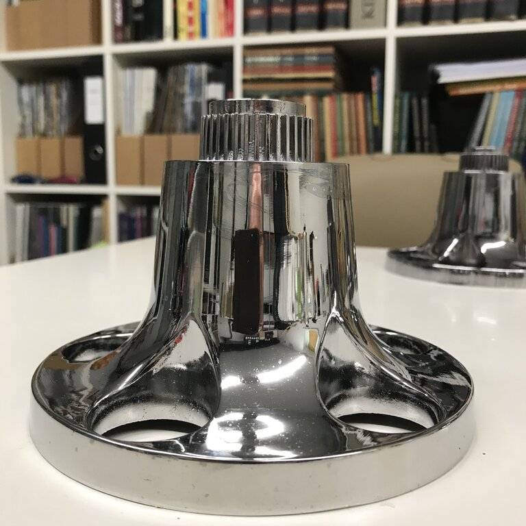

@Samplingman, could you please measure height of the serrated part of the Chrysler dome? (The AMC ”axle end” is 15mm high, with a 37.5mm diameter. The height of the dome is 86mm, from the bottom to the level part where the serrated ”axle end” rests.)

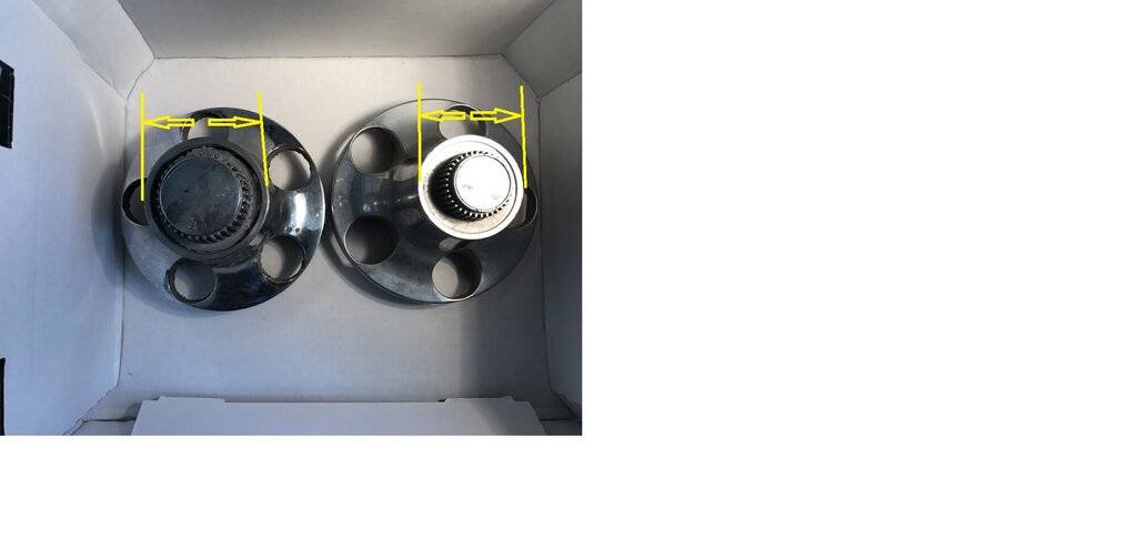

Would you you please take a diameter measurement per the yellow arrows in this photo?
