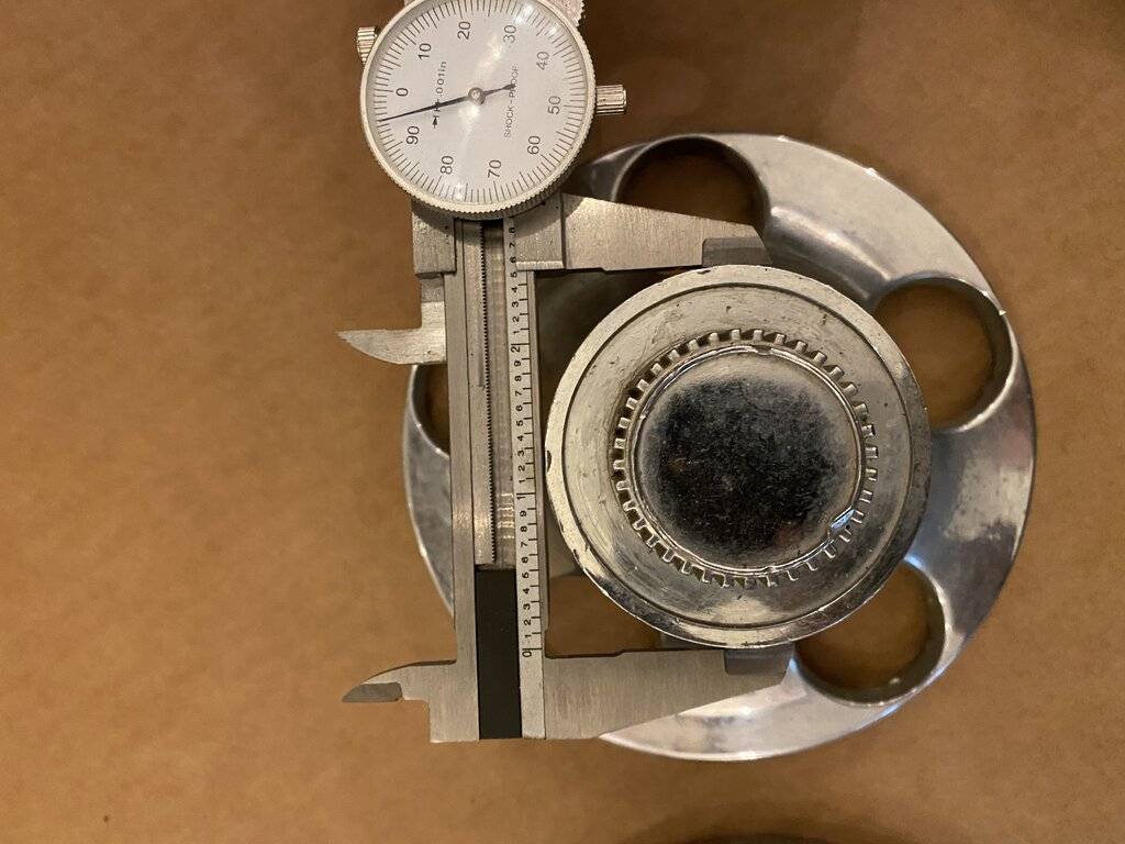

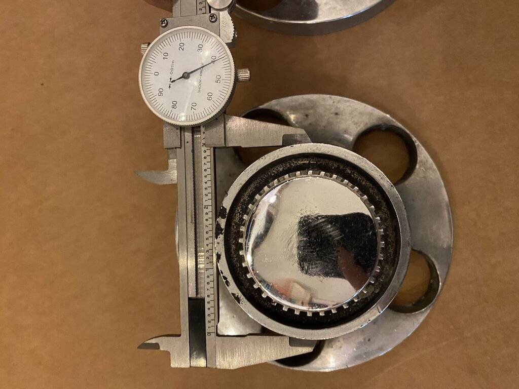

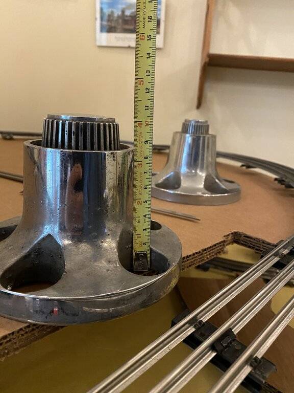

@Big_John , could you please measure the height of the Chrysler dome? The same measurements I gave of the AMC cone. I can make the silhouette dwg’s, and my friends can work from there to 3D Rhinoceros. Once we have the Rhinoceros model, it can be 3D-printed anywhere.
Mine is on the car, so it's a little tough to get an accurate measurement. I'll try tomorrow, but maybe someone else with one off the car can do better.
Hope this helps.
