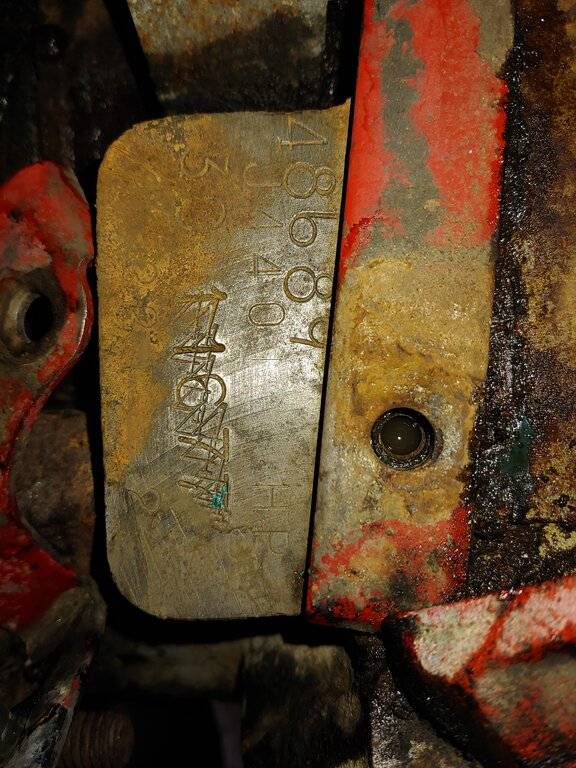

Ok, finally found some numbers.
My 66 has a number on the top of the block front right by the valley pan.
My 68 had no number there but was one bottom of block by the starter.
The 66

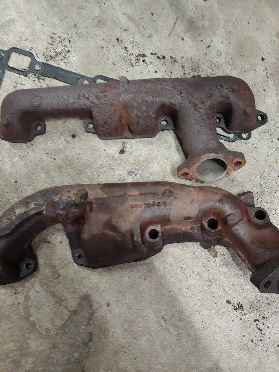

The 66 has HP stamped in the second line on the right? Also the exhaust manifolds look slightly different
So I guess the first question is are these the same? My intention is to send the 68 block out for rebuild and swap it in. That way I can still stay driving all summer...))

Well, my project got stalled..driving the son to his girlfriend and my muffler dropped to the pavement...looked good underneath but it has rusted at the rear connection to pipe. Sooo...I'm swapping exhaust manifolds right now to the ones off the 68 and getting a full dual exhaust put in. 2.5 true dual with flowmaster 40s
