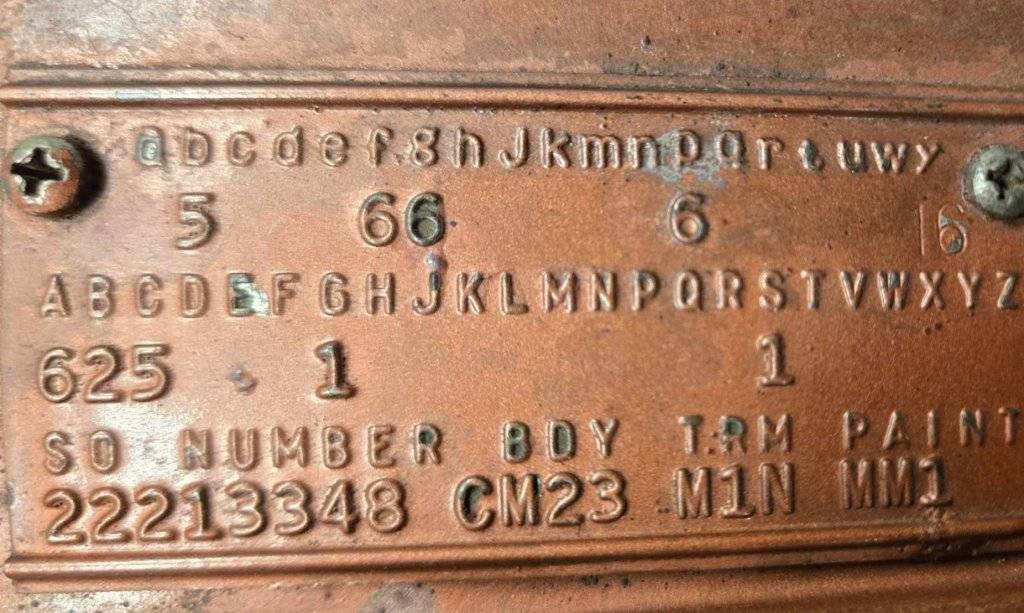

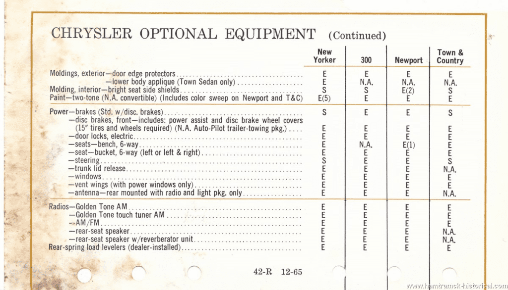

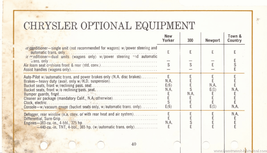

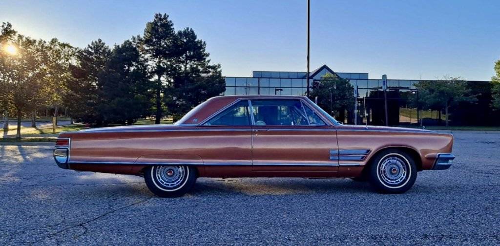

Hi and thanks for posting the great pix of the car and, especially, the fender tag. I am in the midst of adding 1966 Chryslers to my decoder and would appreciate your taking a minute to review my decoding of your car's fender tag. Please confirm or correct my entries. b5: 455 power bucket seats LH & RH (others say rear armrests & ash tray); f6: 426 Rear speaker; g6: 546 Front bumper reveal molding (thought to be the thin SS moulding around the ends of the front bumper); p6: 536 Outside LH rearview mirror-remote adjustable; "16": Body inspector's stamp; AB62 383 4-bbl; C5: 395 TorqueFlite; G1: 26" radiator opening; S1: 411 Air conditioner & heater; SO: 222-Scheduled assembly date February 22, 1966; NUMBER: 13348-Shipping Order Number; BDY: CM23 Chrysler, 300, 2 doors, hardtop; TRM: Medium/300 Grade cloth & vinyl seating in white with black insert (gorgeous!); and PNT: MM1 Roof and lower body color are the midyear Turbine Bronze Metallic-Monochromatic styling (also gorgeous). Thanks in advance.
