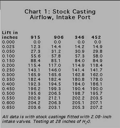

The 452 heads are a late 70s smog head. I don't see 375 -400 hp with those heads. An earlier 915 or 906 casting will get you closer to your hp goal if you want to save some $$$ by not going aluminum.
The only downside to the 452's, which I consider the best heads of any BB, is the C.R.
New pistons solve that real quick.
They flow the best of the stock iron heads and a CAD port and polish will get them right up there with Eddie E_heads
Before this turns into a pissing match, we're talking about a 5% difference in flow @ .450" lift. :laughing7:
You may notice a difference on the dyno, but not on the street.

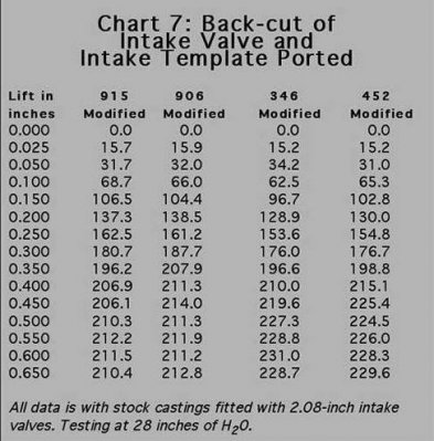

Look how much the flow increases with a non lipped stock valve (back cut) and a bowl cleanup at .150, .200, .250 lift
Modern one piece valves don't need back cut because they don't have this lip hence a increased flow for free. This is also a reason why alum heads flow better.
