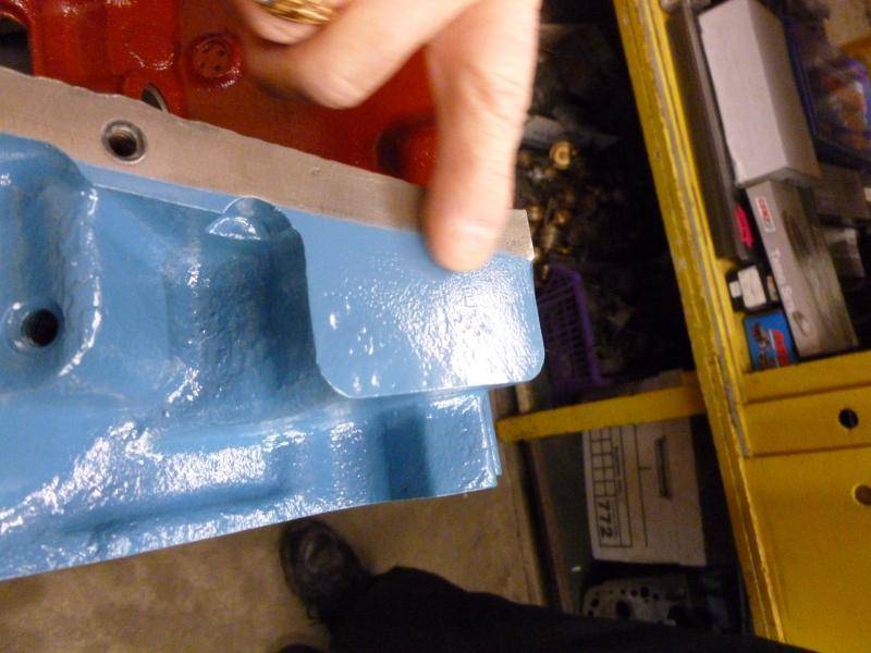

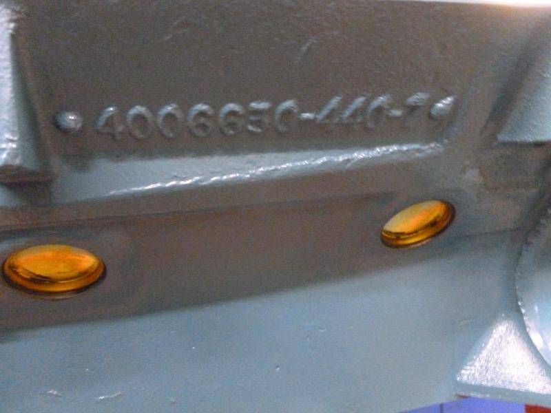

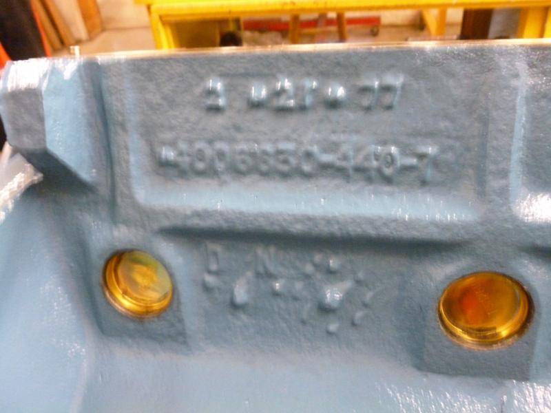

Another few pics from today. Block is bored another .010 (total .040 over) and confirmed adequate. The forged pistons ordered and moley rings have been ordered but due to back order likely won't be in until New Year. Shop still figures we will be on target for factory 440 HP specs. I was hoping to drive the car home but it likely won't happen on mid-January roads around here.
Are you planning on painting your motor turquoise when it's all one assembly???.......it looks corporate blue on my monitor.
Not sure what the colour is but it does seem darker than turquoise. Pretty sure the spray cans are still available from the dealer parts counter.
I love the paint on the inside of the motor and heads, helps with oil flow back to the pan. Do you know what type of paint they used?
It does look good but I don't know what it is. He won't be doing much with it until the New Year. I'll try to remember to ask him when I go back to visit then.
Better get the rattle cans ready that is definitely Chryco blue, I catch all sorts of **** for leaving mine blue instead of turquoise from the know it alls...look at my car boys and girls, anything scream factory concours restoration here...your mileage may vary...
Knowing Fred, there is no way in Hell that is Corporate Blue.
