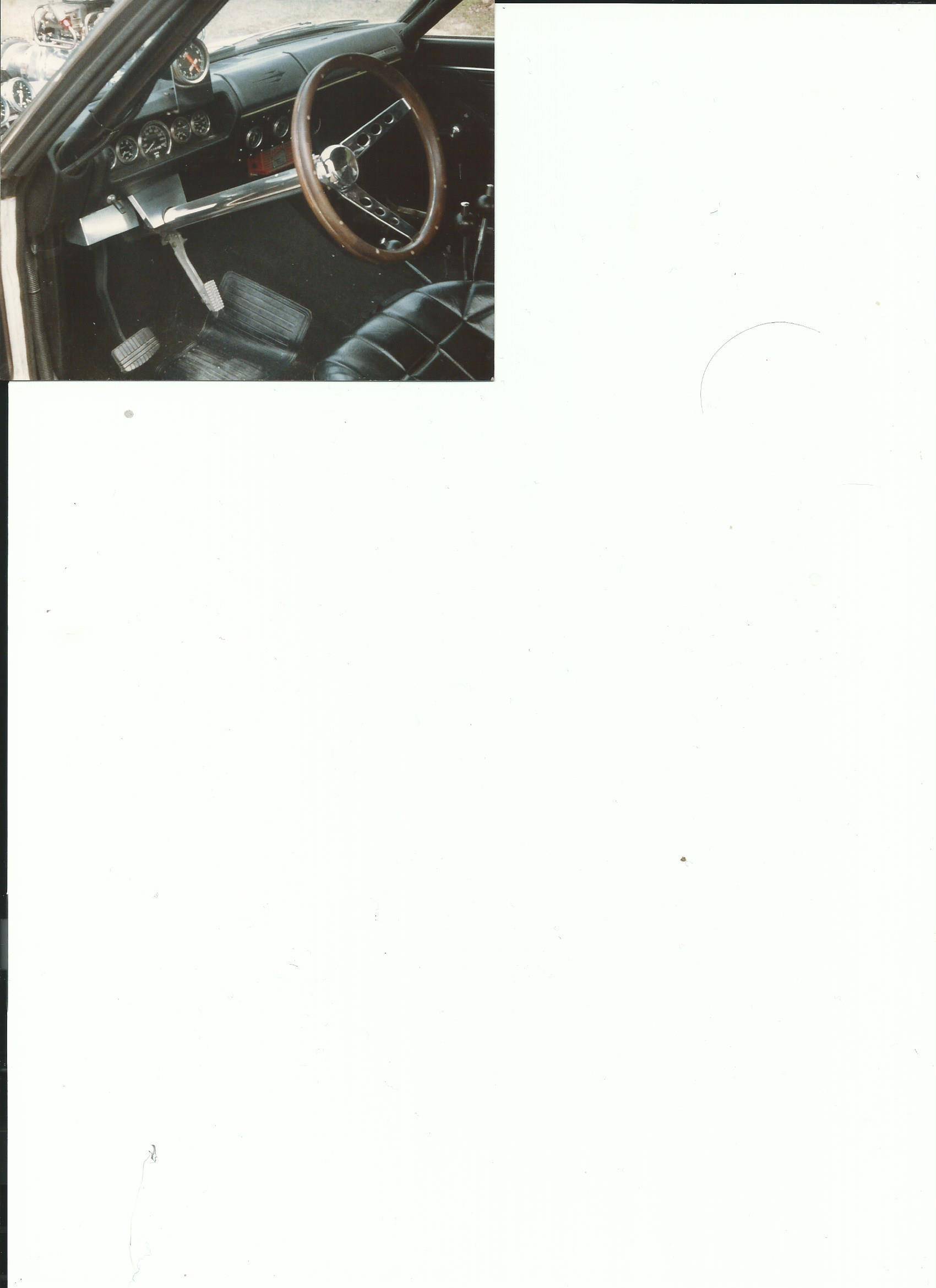

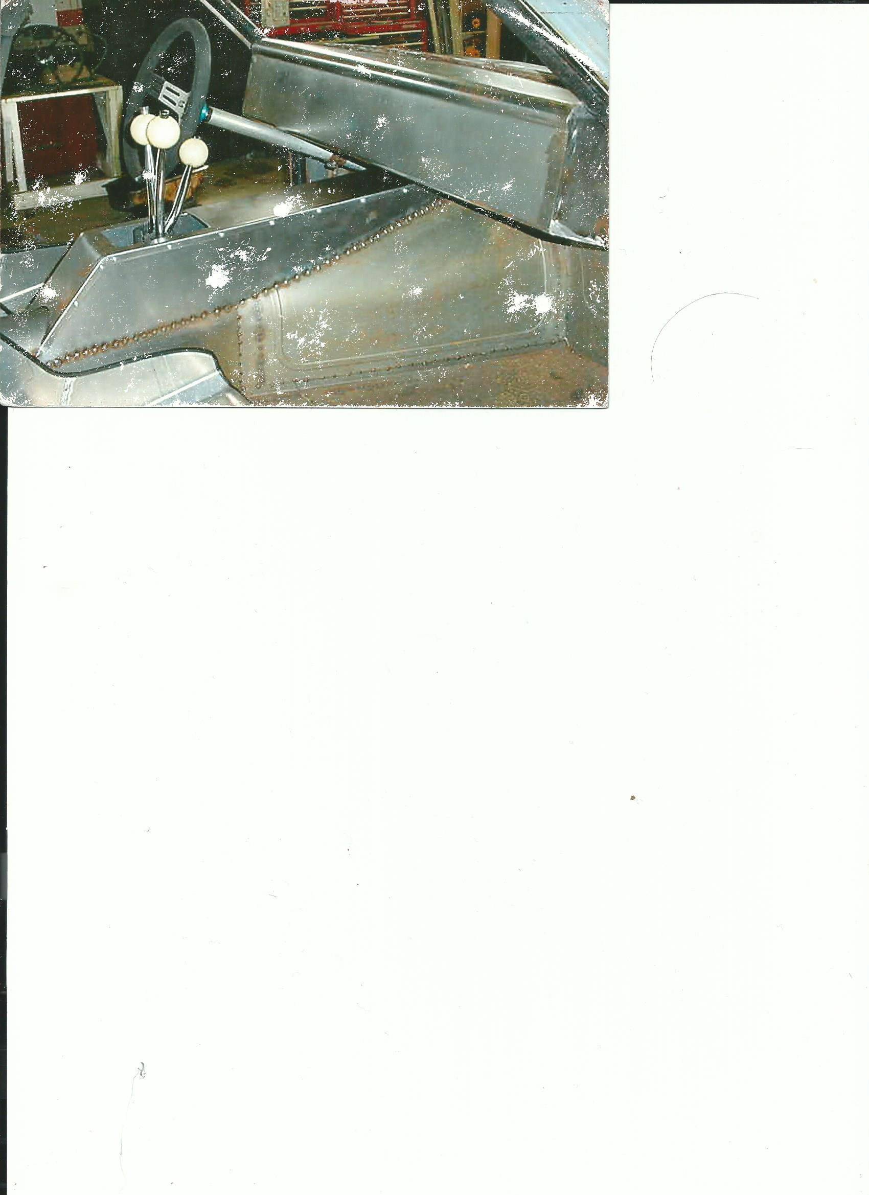

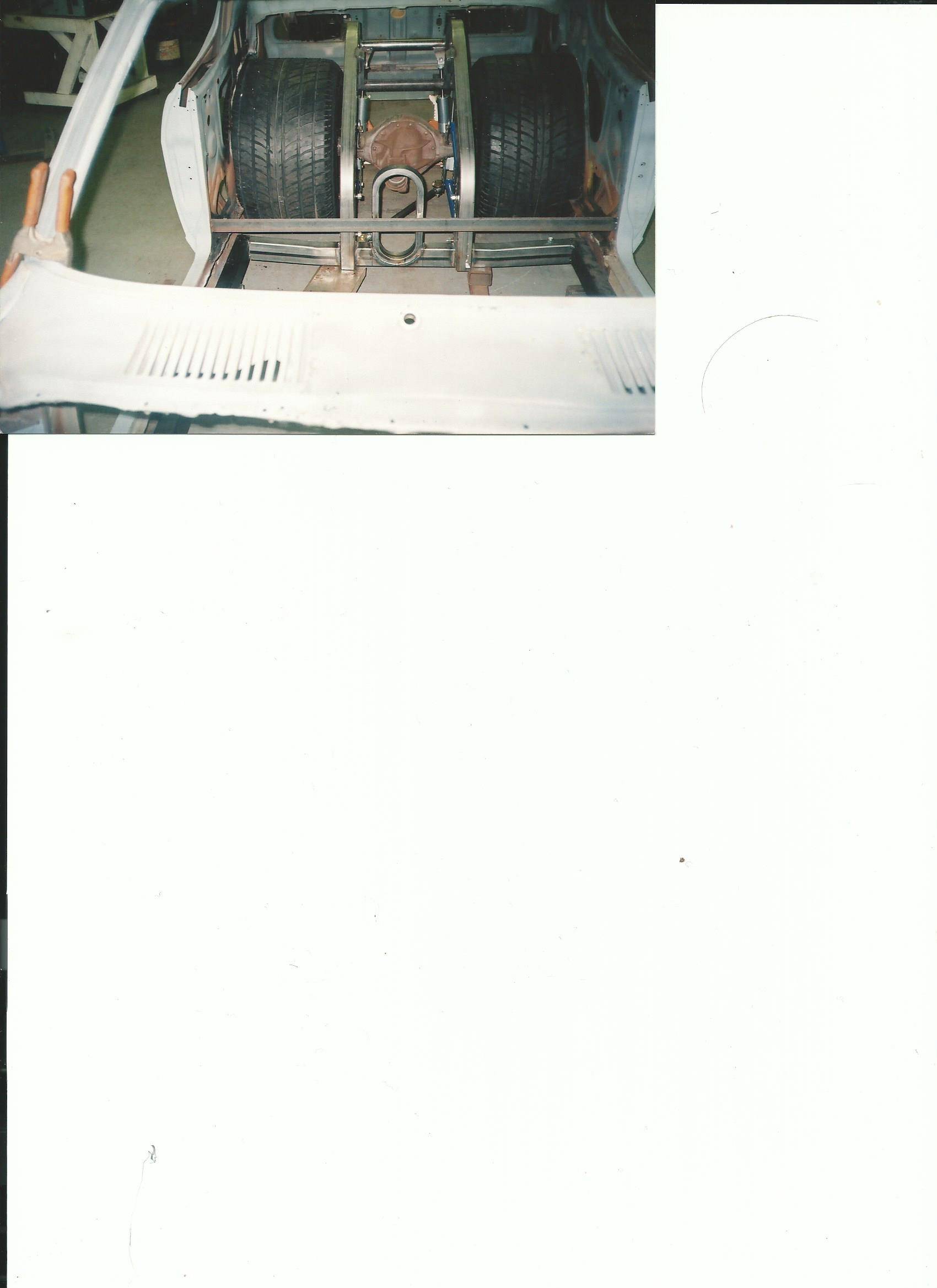

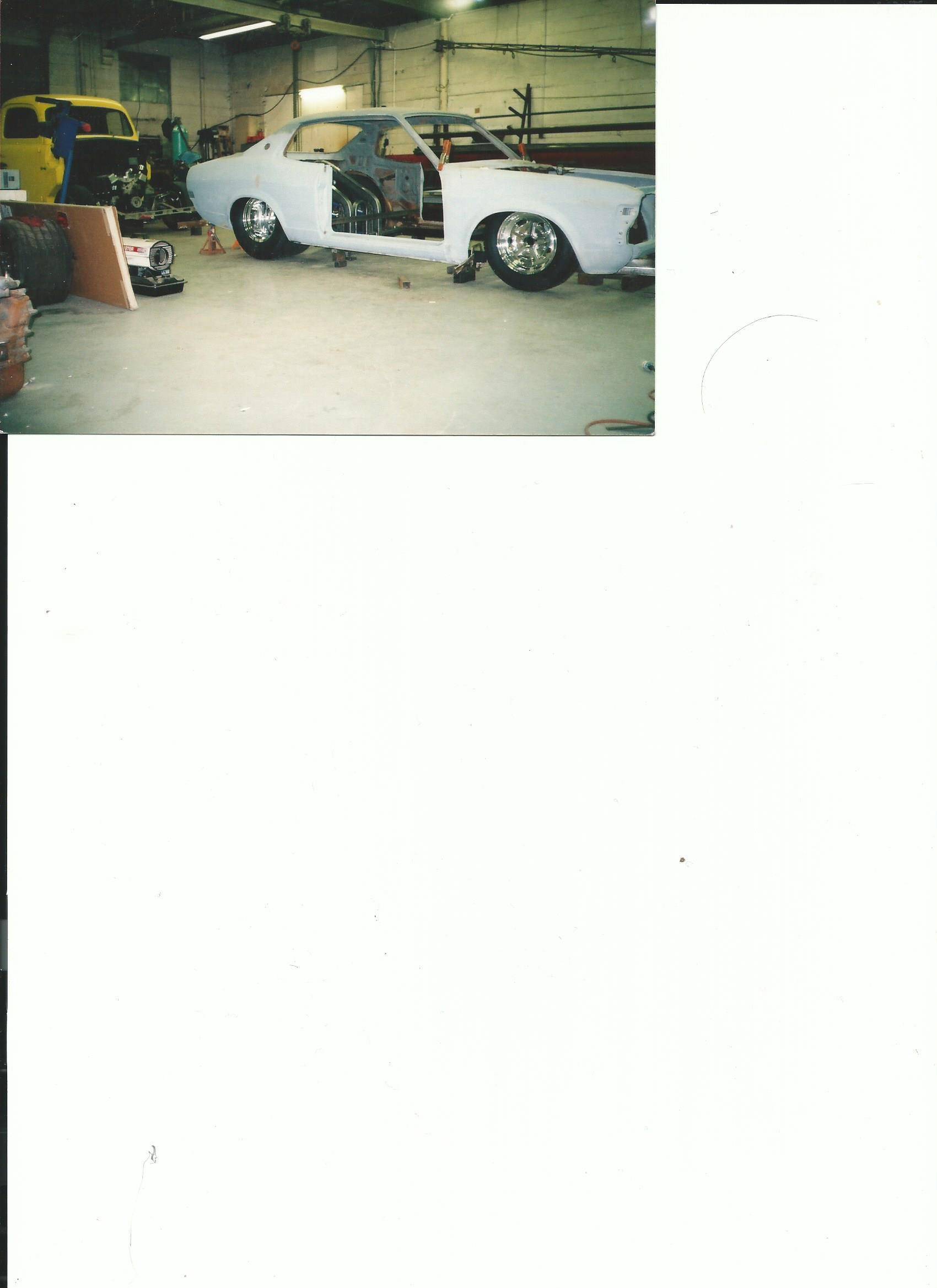

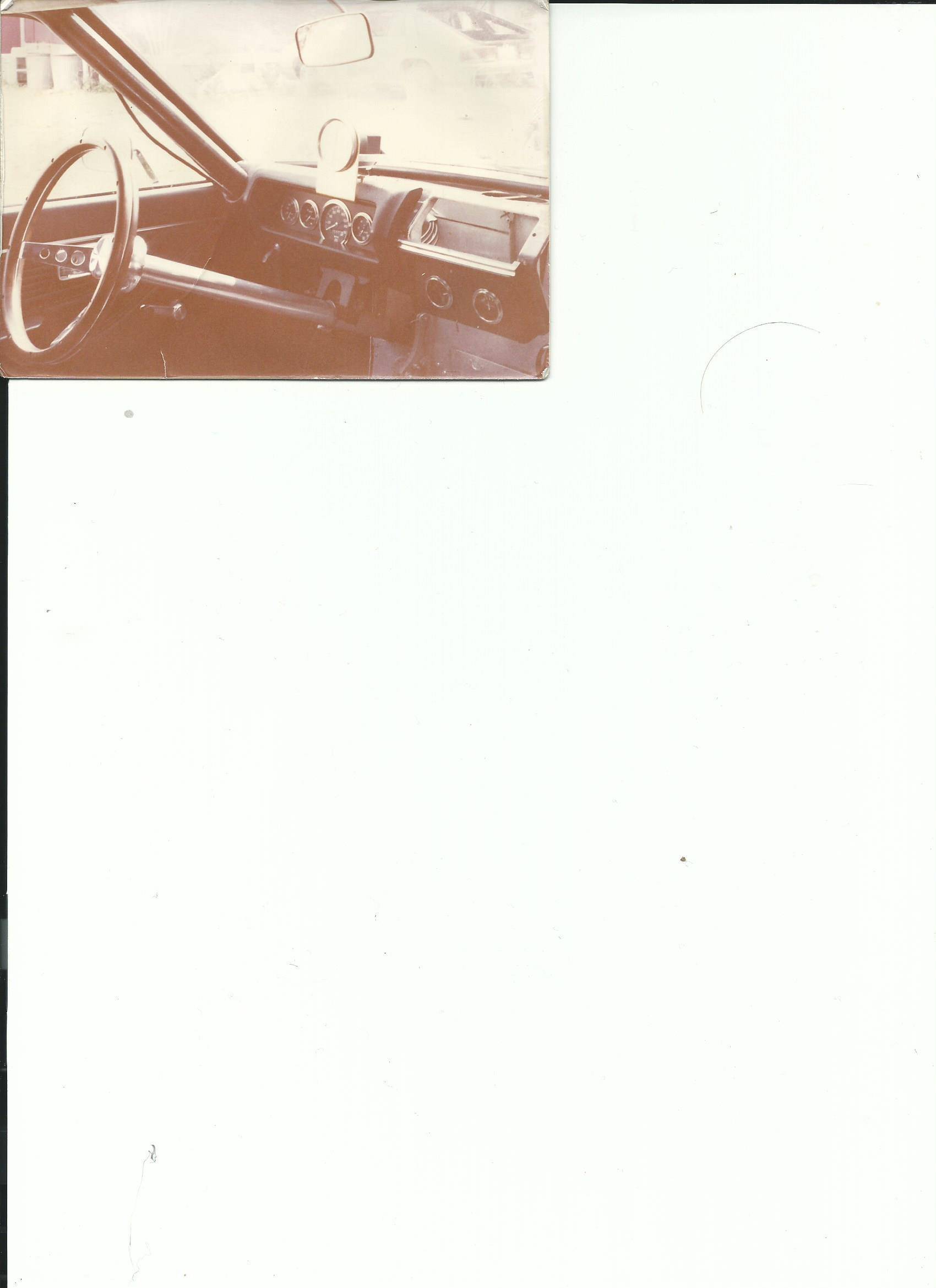

So the first pic shows that I took the firewall out and placed the motor in place where I wanted it and just built the rest of the car around it . Used Hedman headers had to cut and move 2 tubes to get every thing inside the sheetmetal firewall .pic 2 you can see a little more sheet metal work , had no metal brake so I used a 6 inch I beam and a big hammer , crude but effective ..3 pic you can see firewall , used a lot of pop rivets to hold it together . The motor in this thing was moved back 14 inches , cowl was notched almost to the windshield . Next pic shows finished product Msd6al was mounted on the trans tunnel . Take note in pic's I ran rollcage thru the fresh air vents . By the way the cage was made from 2 inch black steel pipe that I got from my work place .. used pvc pipe for a pattern for the bends and the muffler shop bent it for me for 50 cents a bend , see I told you I was cheap . next pic shows seats and if you look real close you can see the rear tire tubs , you could sit it the seat reach back put our hand on the rear tub and then put your foot on the front one . small inside . next I used an ARC control box with switches to start it up and run fans and fuel pumps ect. Next pic shows motor placement , used motor plates , take note U can see road sign I used for firewall .. redneck anyone ? Look at the strut tower , I moved the top of the strut rod over 3 inches and the lower control arm in 3 inches and used 1000 lbs helper springs to hold up the front end , had to do this so tire would not rub fenders . Flipped the struts from rear steer to ft. steer used a MGB rack set up .Redrilled the stock rotors for 4 1/5 bolt pattern . used stock brakes ,with std dodge rear drums in back . used a mopar master cyl. mounted under the dash with stock petal assem. I used what I had . Next pic looks a little better tin work in place . Will post this file getting to big to down load

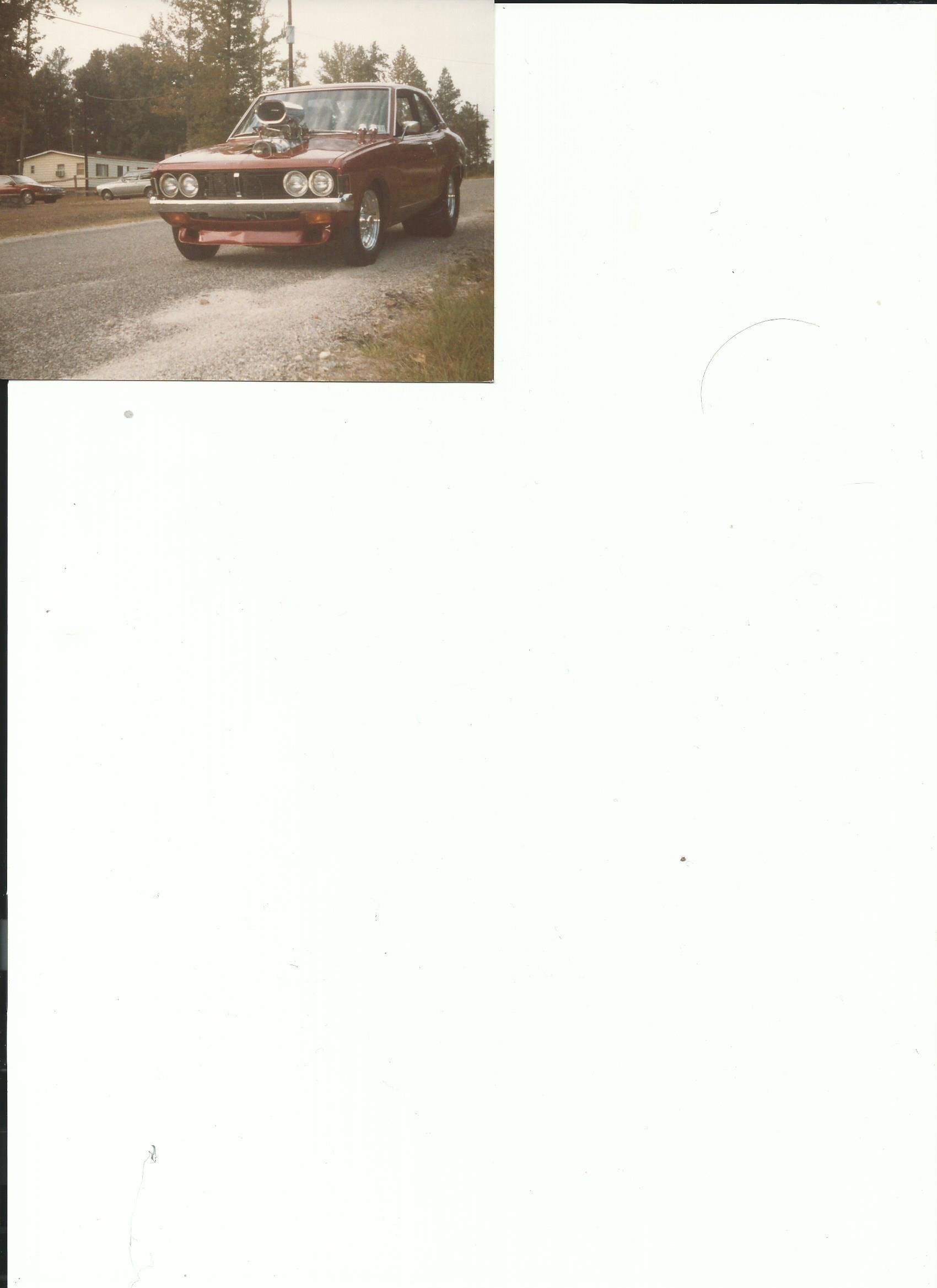

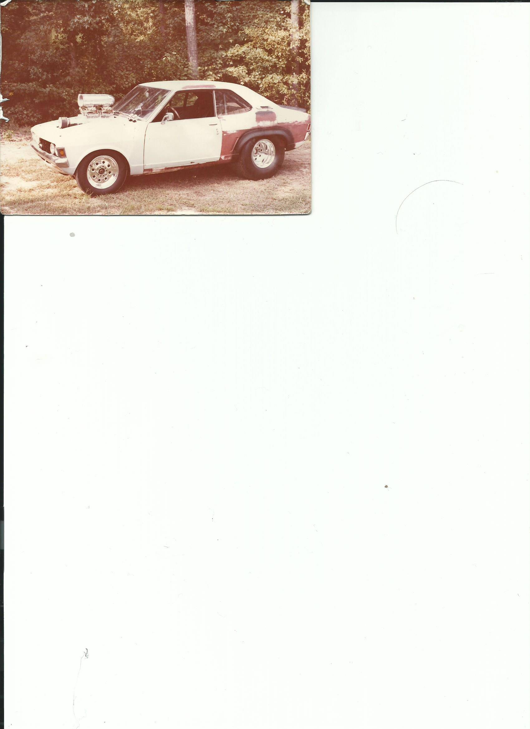

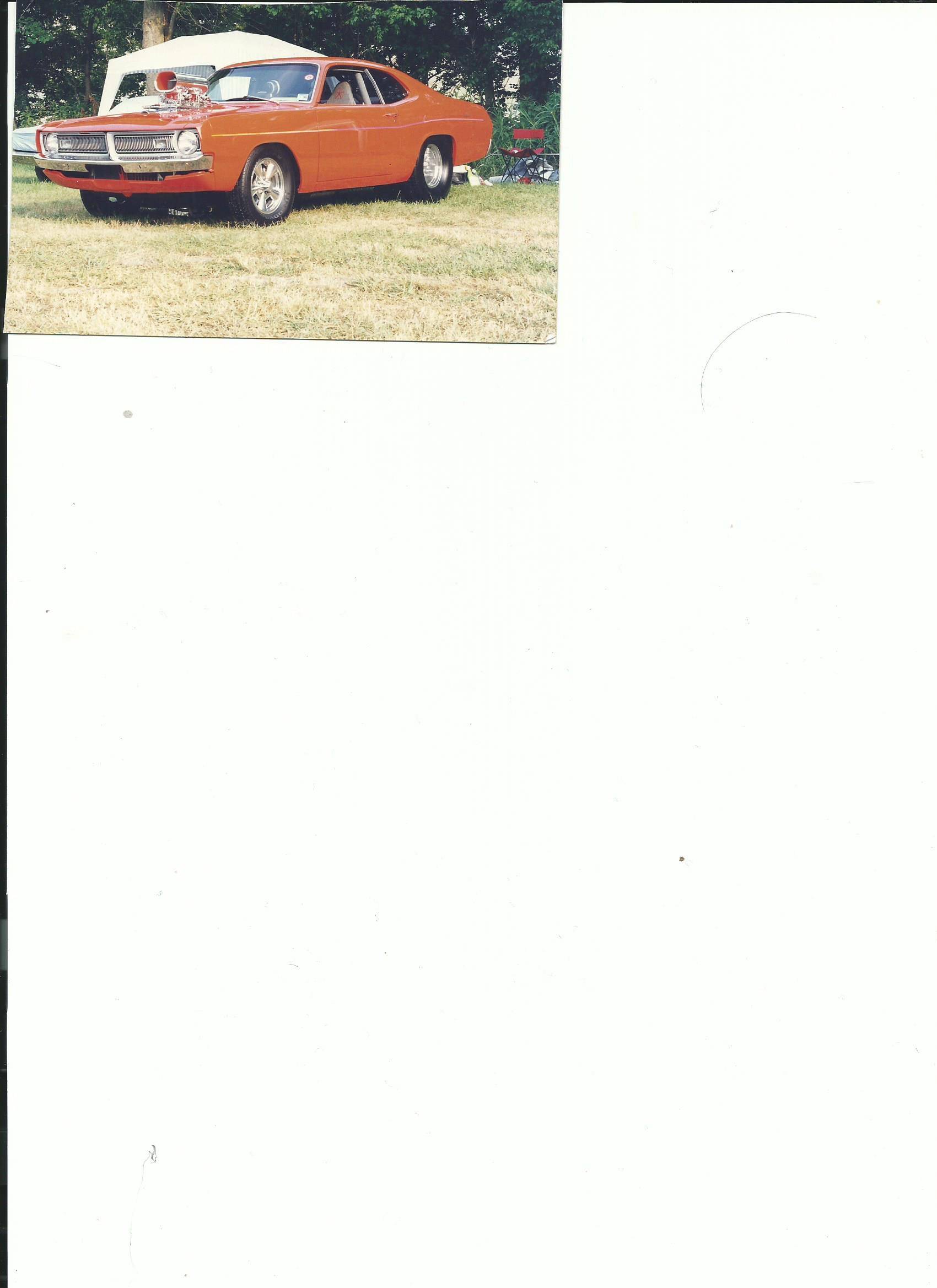

more pic's radiator was for big block Vega , the rear wheelwell opening flairs were half stock Colt and half fiberglass ones for a Vega cut off and spliced in the middle to get them to fit and look correct . My son at 15 he is 47 now . rear spoiler is cut down fiberglass AAR cuda spoiler with 13 inches cut out of it and glassed back together . Do not know size of gas tank , make a wooden buck of size and kept fitting it until it would go in the trunk , had a shop build it when you put it in you would have to pull the back panel back a little and it would drop in . ran 2 battery's . next pic before ft. spoiler you can see rack and bottom of radiator . note blower and where pulley sits . I changed out intake to a shorter one got about a 2 1/2 drop . It was not hard to see when driving , ran 5:60 x 15 VW tires up front and 19:5 x 15x32 in rear you could see over the blower with no problem .... If you see any thing that you guy's have a question on please let me know ....

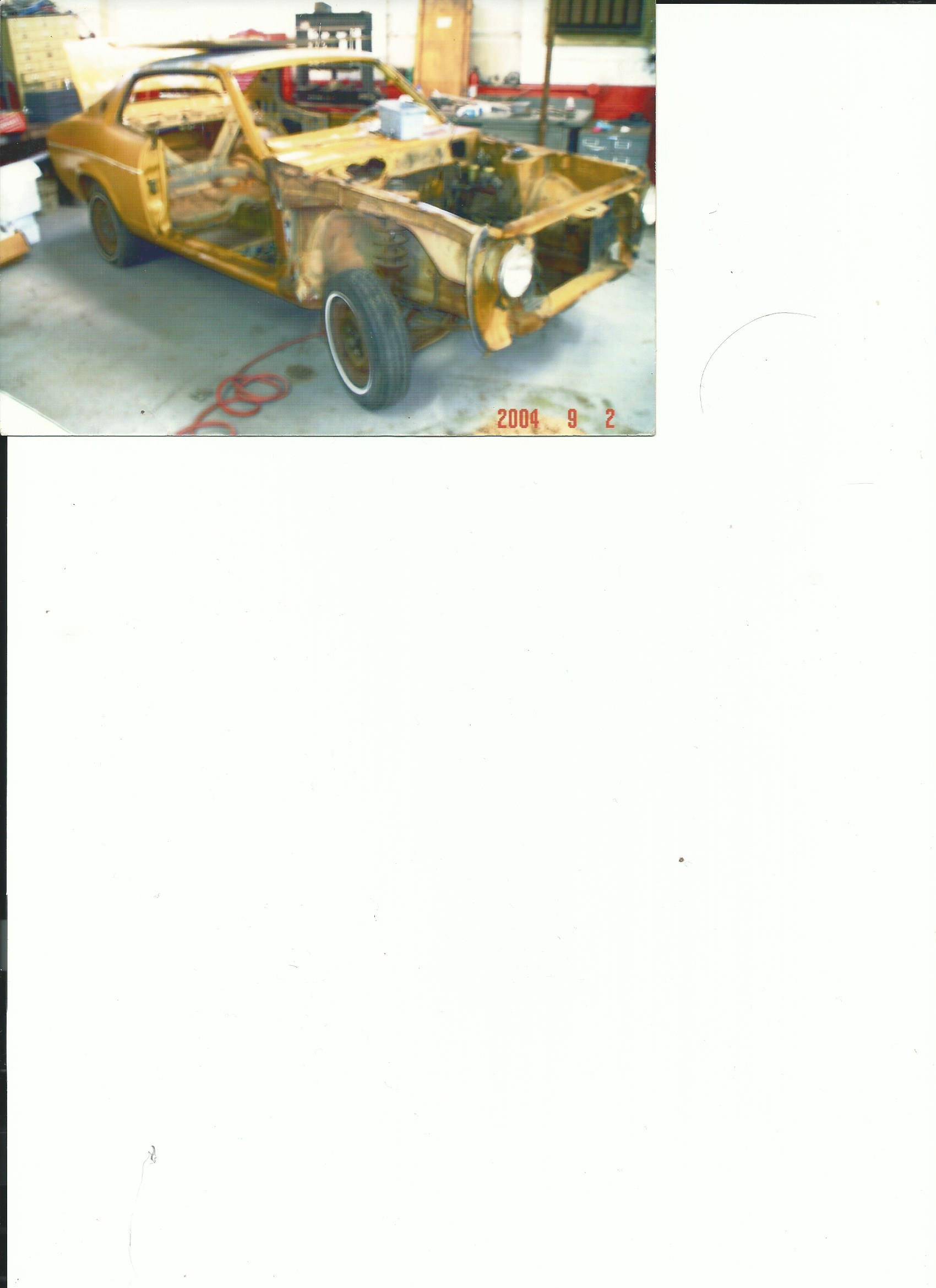

A few more pic's and another story about a 74 colt . After 8 years of building Pro street cars for mostly the Chevy guy's my skills got a little better , build this 72 Demon for a good friend of mine , was on cover of Mopar Collector's guide in 1992 won best of show at Bristol , along with editors choice for Mopar collectors guide and concours of Pro street . but he got tired of it and wanted a colt , so the only one we could find was a 1974 model . So this what he started with , something only a mother could love but with time and drive it came something great looking and running . I moved to Tucson about the time he started and Robert Early helped him finish it . I gave him a set of Lightning rods , the shifter balls were in bad shape so we used white cue balls for shifter knobs . 8 3/4 rear with 3:91 gears , used a small block for power .

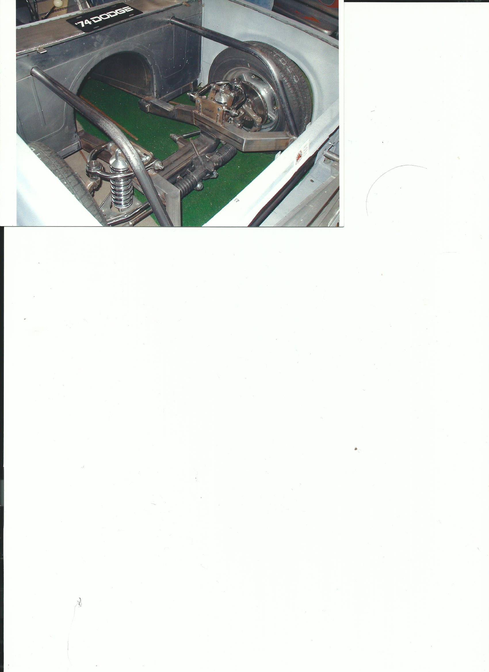

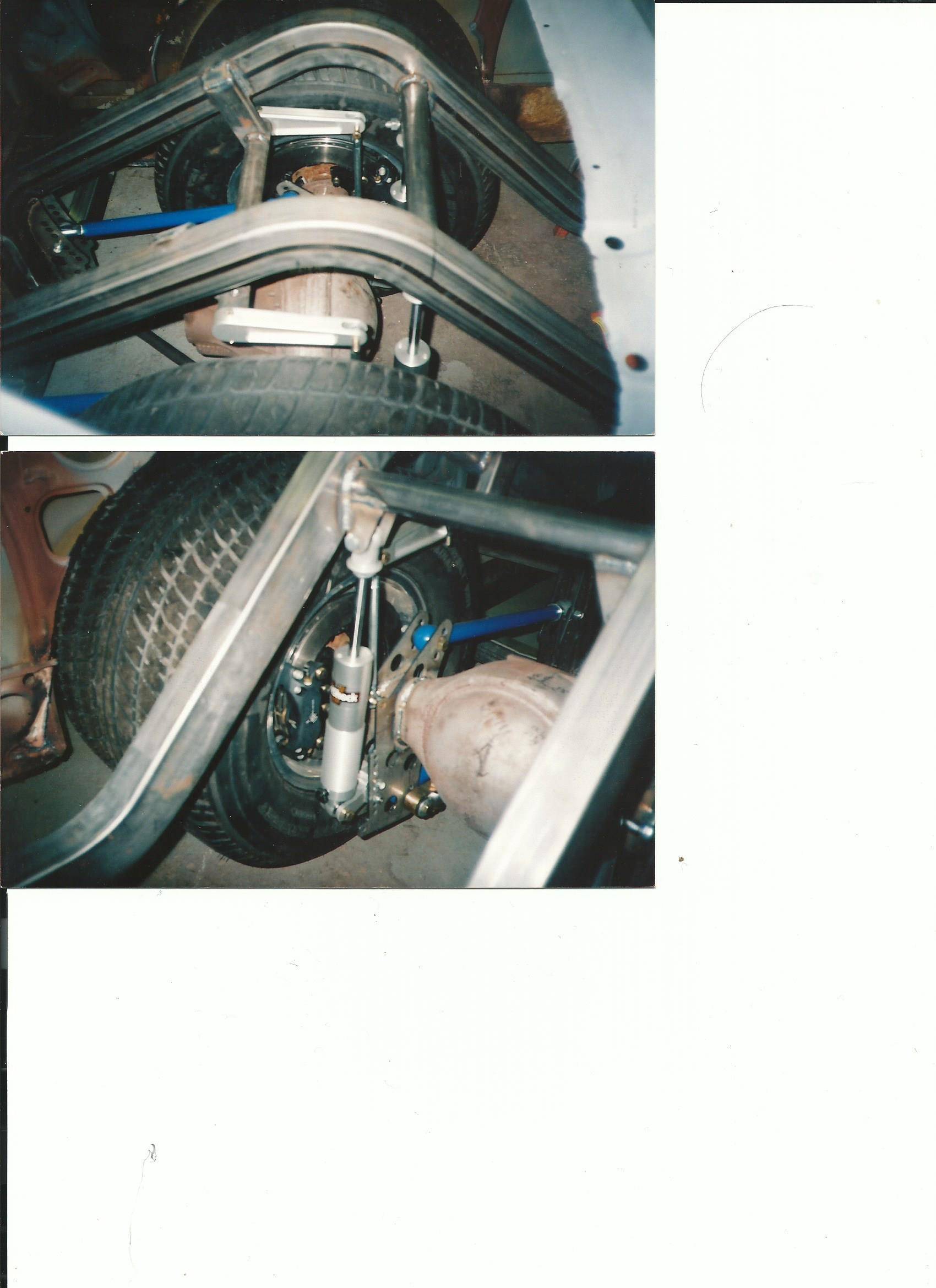

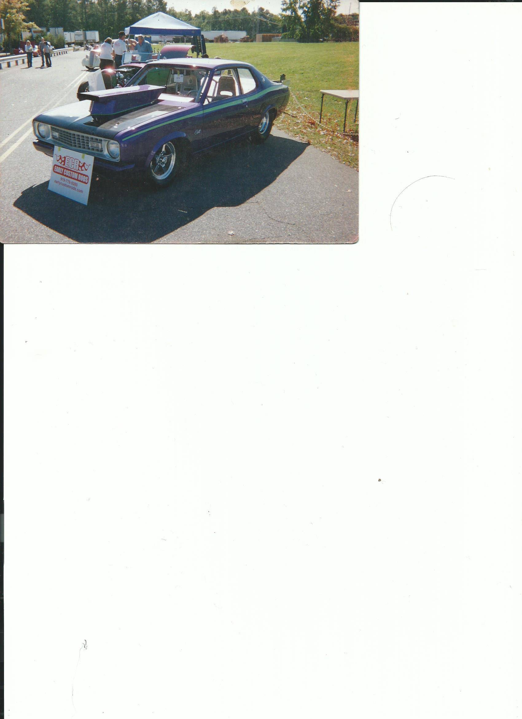

This is rear of purple colt. rear 4 link , anti rotation bar , springs are not on shocks in the pic and lower diagonal link on 4 link . the ft set up was a street rod kit for an Anglia narrow track ..

After making sure every thing lined up and worked , I cut a 3/8 round plate and welded it to the top of the strut tower and drilled a hole in it and bolted the top of the strut thru it . I welded a plate to the back of the strut tower and tied it to the roll cage under the dash . The car was real stiff you could jack one side at the back of the rear frame and pick up 3 of the 4 tires off the ground . In this pic you can see the top of the strut rod bolt , the plate was welded on top , the short bar on the left side was were I was trying to see where it would come thru the firewall and attach to rollcage and strut tower .
