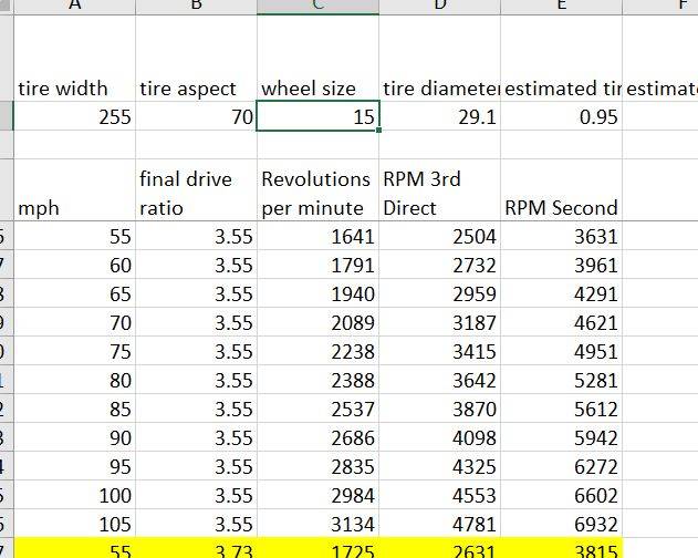

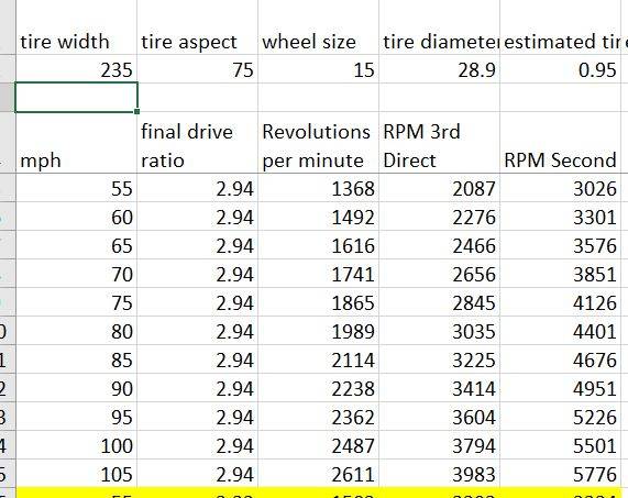

I thought the OD was 0.69, by the way. I built my spreadsheet with that ratio. Not that it matters much. Anyway, here's the revs at speeds for 3.23 and 3.55. I updated the tire size to the one you listed. Note that it assumes 5% trans slippage when the TC isn't locked and assumes a rolling radius 5% smaller than the calculated tire height. I also included 2.94s with 235/75-15 which is what most guys run here. For a stock 727, look at the 3rd direct column as that's the 1:1 3rd with no lockup.

You and I are coming from different perspectives. You want to drop significantly from 3.23. I want to get more acceleration around town than offered by a 2.94. So I look at things as just a small decrease in RPM from my stock.
Having said that, if you want relaxed high-speed cruising, you might consider either the revs you get at 2.94 or 2.76 (is that right? Is that the other standard "tall" rear end?). For reference,
3.23 is 2700 RPM at 65
2.94 is 2450 at 65
2.76 is 2300 at 65
With a 518,
3.55 puts 65mph at 1950 rpm
3.73 is 2050
3.91 is 2150
So 3.91s would be lower on the freeway than you have now, or any of the previous Imperial ratios. The thing I've been thinking about is what happens during kick-down to third direct then to second gear. That's what the other columns are. It looks like at any reasonable speed, the kick down to 3rd direct gets right into the meat of the power/torque even with 3.73 gears. If really needed, you could even get into second for a big pass on a secondary road (55 or 60 mph). The stock Imperial engine is (in '67 where I'm familiar) has a torque peak at 2800 rpm and a hp peak at 4500.
