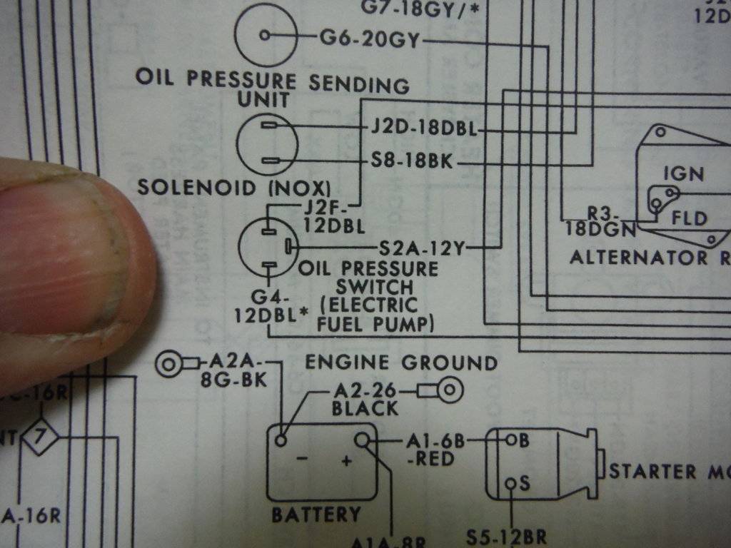

I've never heard of a factory installed electric fuel pump.

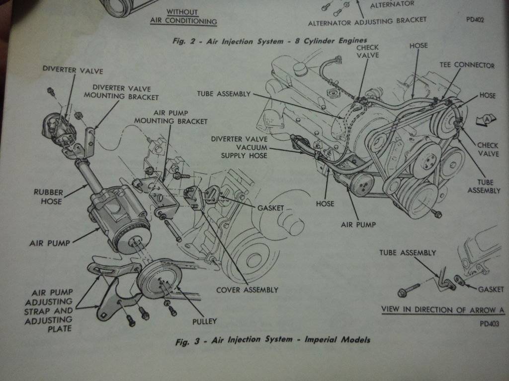

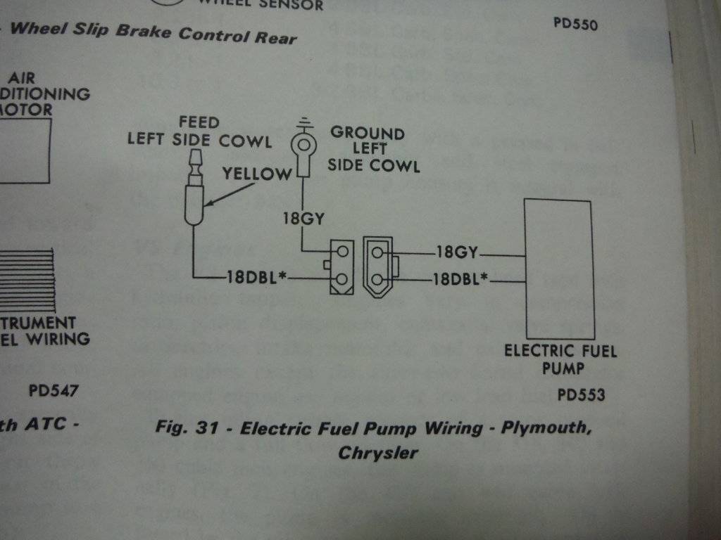

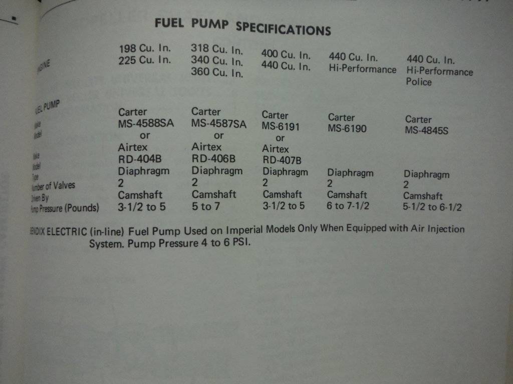

I've never heard of a factory installed electric fuel pump. I think someone put that in there. I just looked it up and the FSM clearly shows the air pump on the CA Imperials was under the power steering pump on the driver side.
Apparently someone doesn't have a 1972 FSM. Let me offer a little assistance...
It was rather difficult to hang a mechanical fuel pump off the engine when the factory used that position as a mount to hold the air pump.
Amazing, but true.

I should have known something like that was done. We all know how loud hard mounted inline pumps can be.
Sorry for the misunderstanding... I just never heard of it before, so I never had to look it up. I thought maybe some joker wired one up instead of the mechanical pump. Our cars get butchered pretty bad sometimes. You learn an awful lot on this site. Thanks for posting that info from the FSM very cool!

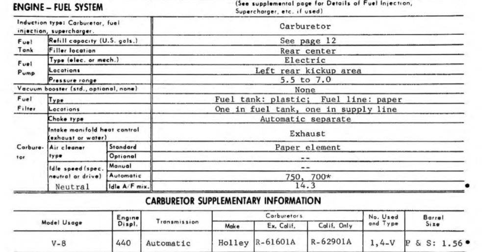

Here's another file. Automobile Manufacturers Association specs provided by the manufacturer (Chrysler) for all models produced in a given model year (Imperial for 1972, in this case). LOTS of numbers! Wasn't aware that, according to these, when Chrysler stopped using the 2.94 rear axle ratio on Imperials, they went to a 3.23 gear (like '71-'73?)
In any case look at the "Fuel System" area.

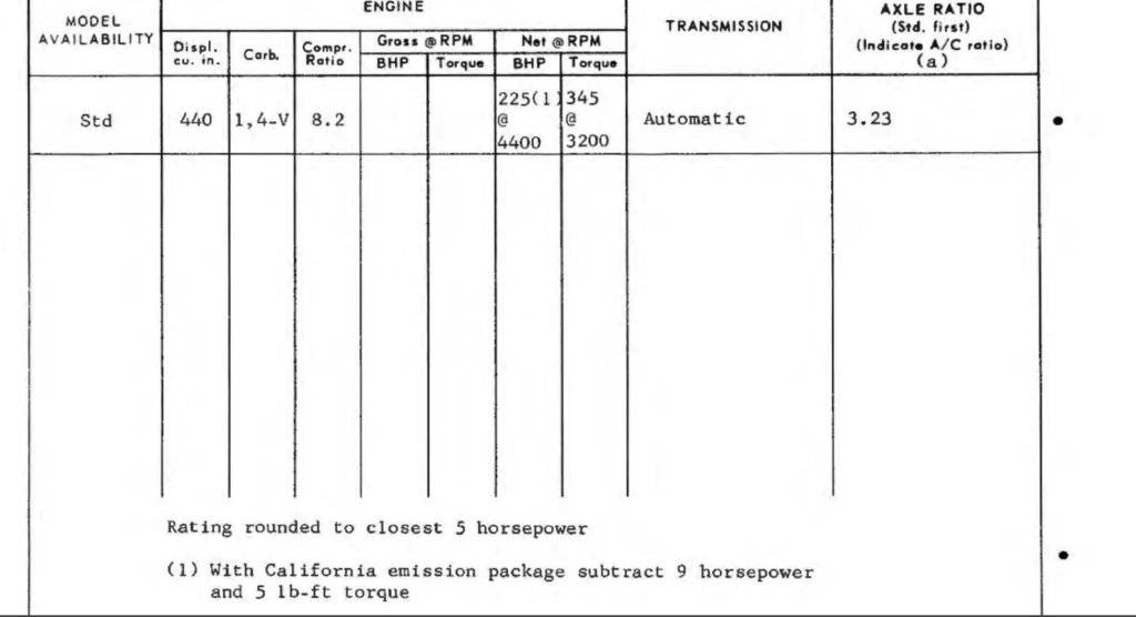

Very interesting. California Imperials only rated 216 hp (+-5hp) and 340 torque. The double wall exhaust pipe is also interesting, thought that to be a GM only thing.
Robert
CBODY67
The gear change to 3.23 happened in 1972 to help bolster performance with the lower compression motors.
Keep in mind that it really wasn't a 130 hp drop that year. Going from net to gross ratings accounted for most of that change.
