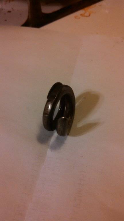

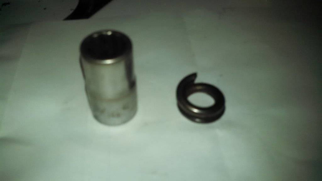

Here is the little bastard and his 5 other coils he was part of causing my Peterbilt's clutch problems. The others are stuck in the spring side of the pressure plate and in bell housing, this one and another decided to get between the floater and the rear disc.
Here it is
I had that happen rolling up to a red light went to knock it out of gear but had waited to long, pushed the pedal and did not release at all, once I hit the key I got it out of gear and stopped. This one was not locking but I could not get it in gear without shutting it off.
The clutch plates on this one are not even half worn, it has never acted right it came with the engine must have been a crappy reman, the new one is new not reman.
I was at US Customs on the north side of Houston clearing a bond and I couldn't get it in to gear. Figured the clutch brake had packed it in. Wrong...
Got to the port and it had miraculously healed itself.
Now not only do I believe in miracles, I depend on them but I knew this would not last. Drove it for another couple of months tho until I just ran out of nerve.
Did away with the auto adjust Solo clutch and put in a new not reman Eaton ez-pedal. I didn't get dirty tho...
