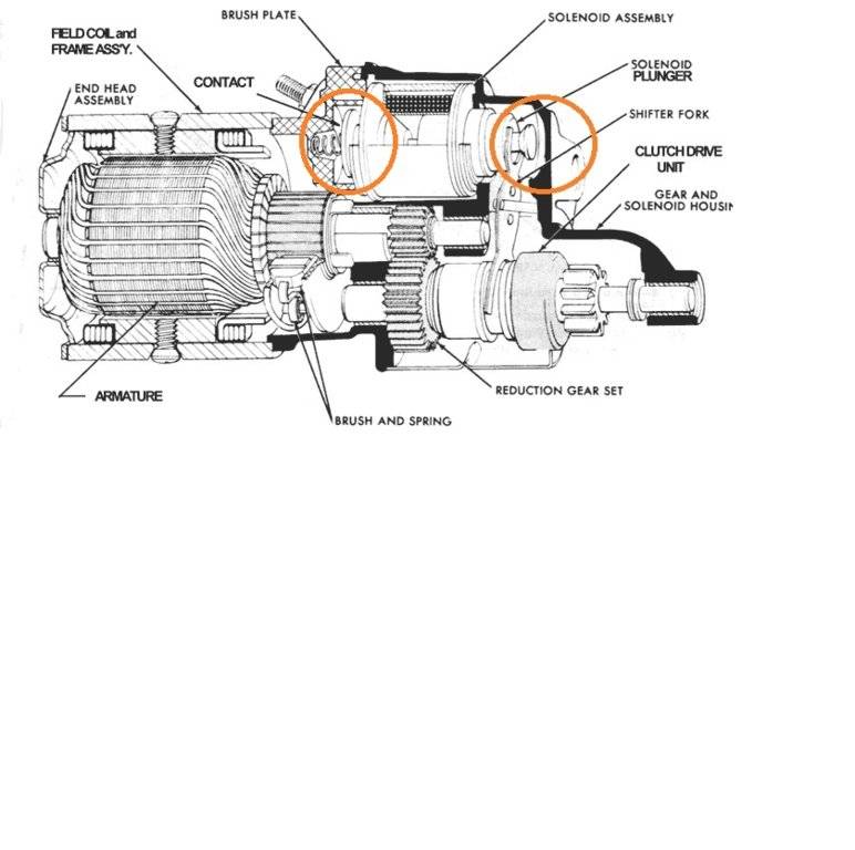

There's a couple misconceptions about how relay makes the starter work.
The relay passes current to the starter that activates the magnetic coil in the solenoid. It pulls the rod in the solenoid that is attached to the drive gear and makes the connection internally to make the starter turn over.
If the starter is drawing too much current while turning over, the relay isn't affected. If it draws too much current at the solenoid, then yes, that does run through the relay, but generally speaking, the starter is giving you problems at this point.
So... While it's not a bad idea to check the starter, that isn't the source of the issue.
I'm going to say it's more likely the new relays are just crap, but I would check all connections etc.
The current to turn the starter runs through the circled plunger and into the stud on the back of the insulator.
Insulator
Stud
Plunger.
