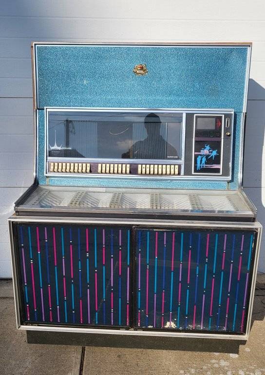

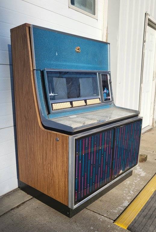

The blue one, a Seeburg from 1968. I picked up yesterday, too good of price and super clean, and a mech I'm very familiar with. Also this was the exact model in my local Pizza Hut through out my youth. Played it more than any other jukebox.

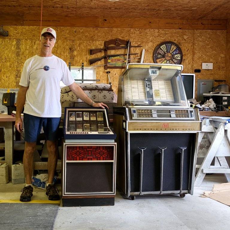

I have managed to accumulate a bunch over the last few years.

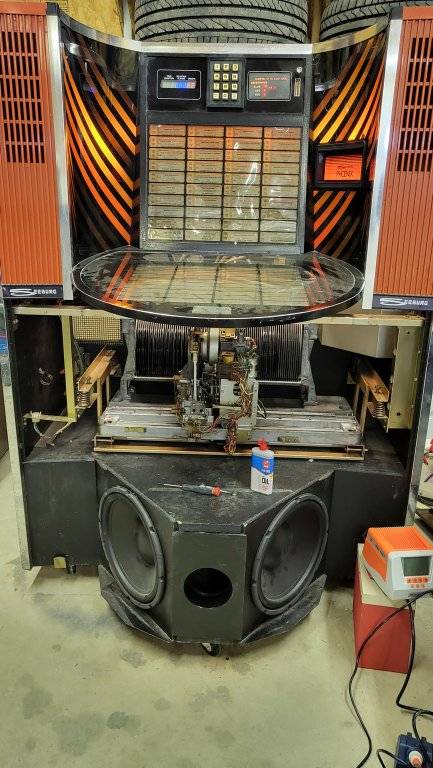

Going through adjustments on my "rat box" today. Just got it running a few weeks ago after giving me fits all last winter. I must say it was worth the effort it sounds incredible.

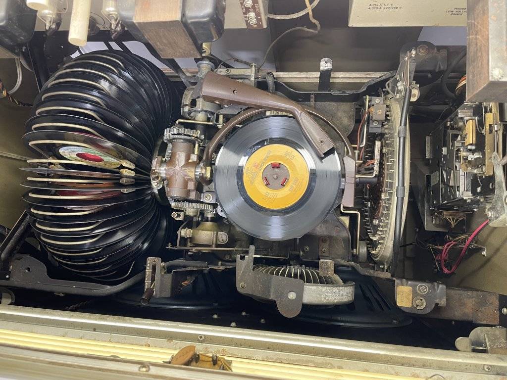

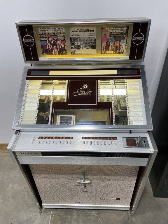

My Rockola Starlit 429 has successfully space traveled from the bunker in Illinoise to a hill in Arkansas. I’ve been able to spend some time with it waiting out my 413 machine work.

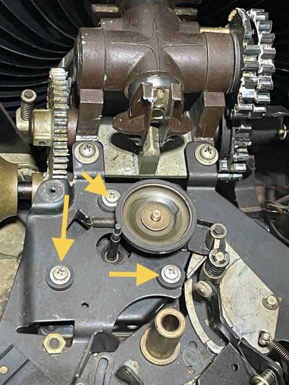

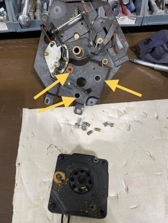

I figured out the reason for the turntable not constantly running. It was the grommets supporting the motor and replaced them with similar size rubber ones.

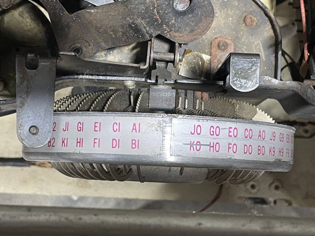

There was an issue of not playing the “0” selected 45’s up north but down south now the “1” selections are a problem. Every so often as a song is playing and another selection is made the inside right hand disk just spins. The fix is to shut the power off and turning it back on.

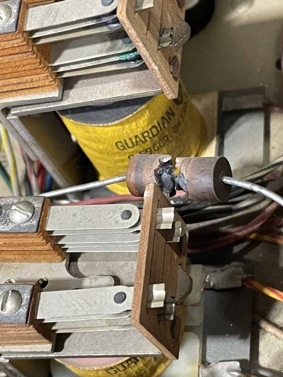

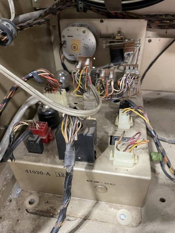

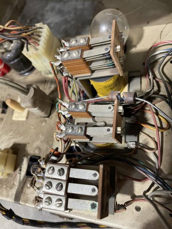

Well looking around a bunch more I found this burnt up resistor that’s either a 100 ohm or 1500 ohm part according to the manual. I remember the color stripes indicate that information. But for now it’s mostly playing.

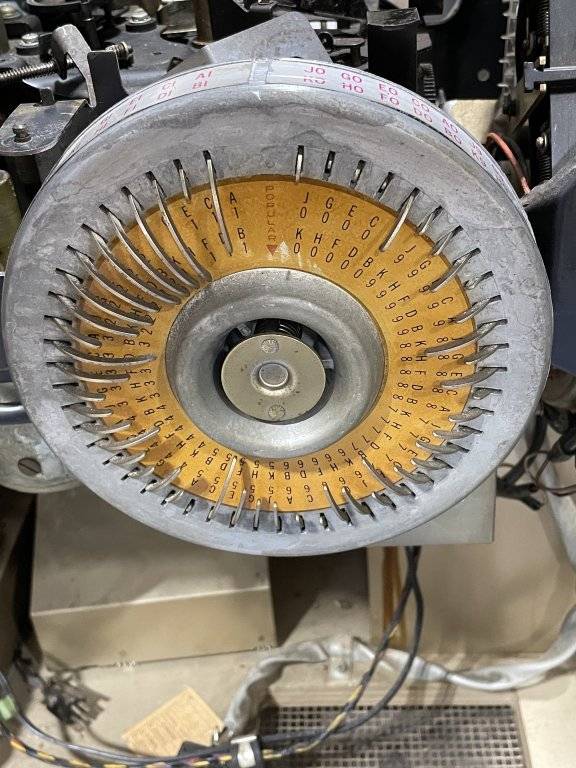

The “popularity counter” needed the playing record number strip re-glued but I can’t figure out how to reset it and get the fingers retracted.

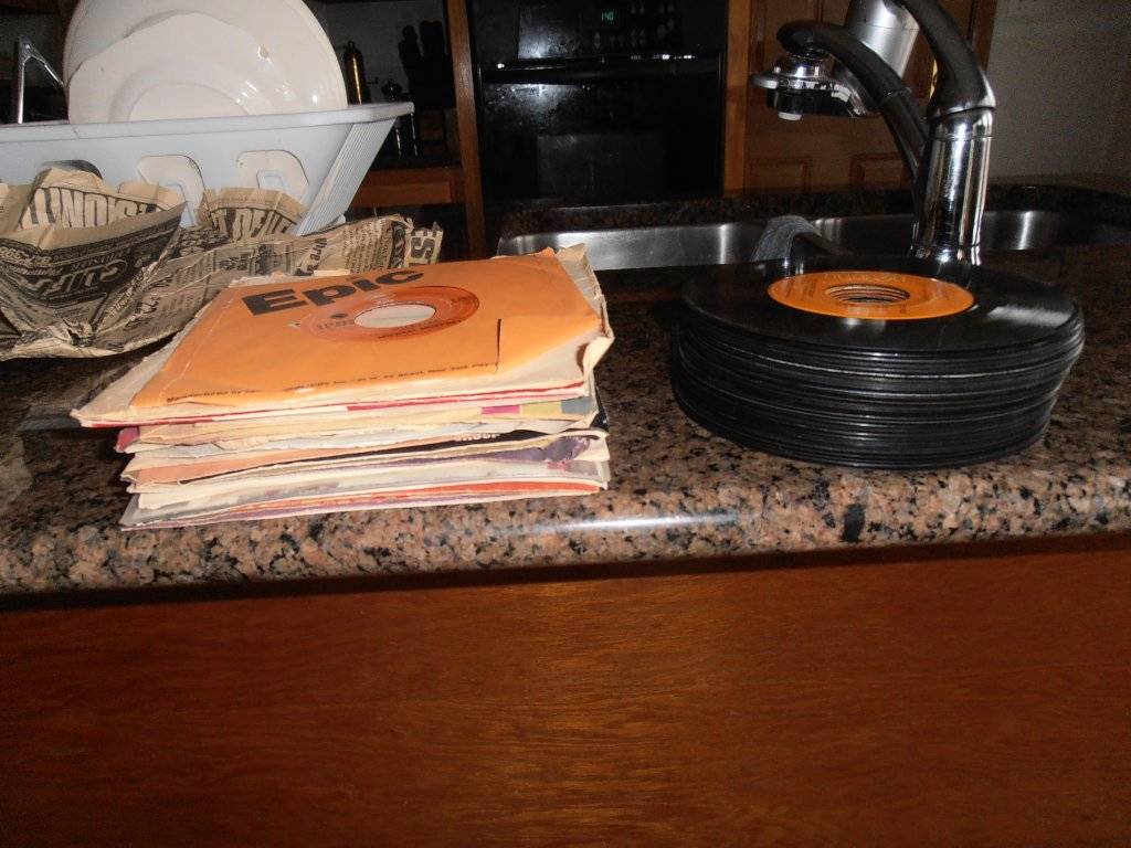

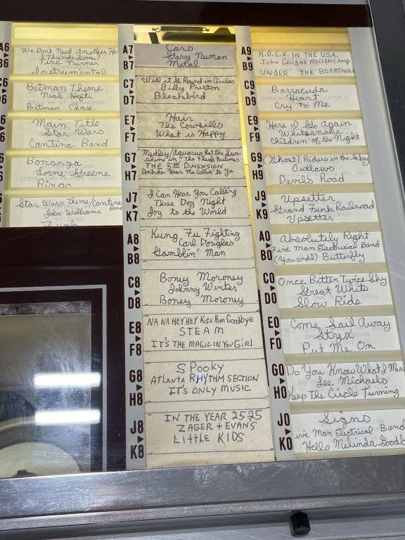

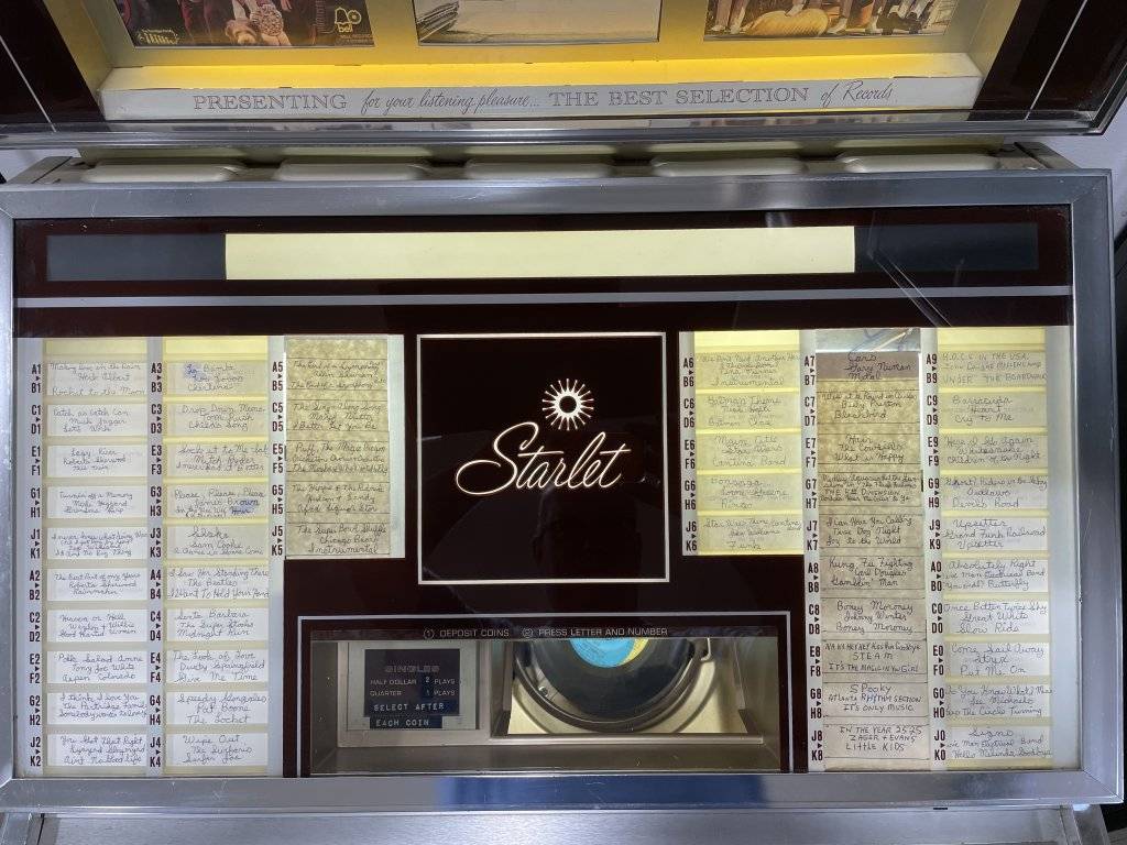

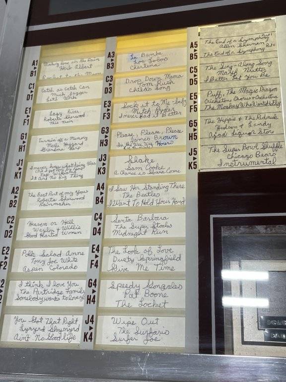

Here are my 50 records and 100 songs that are now gracing my ears and motivating my next moves in the que.
