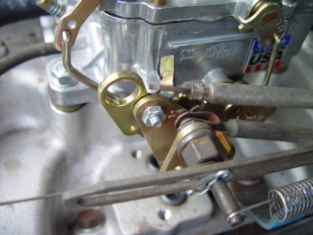

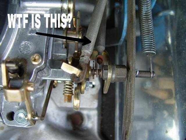

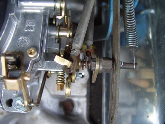

Bob has asked me for pictures on the correct way to attach his cruise control to the Edelbrock.
Here you go, big guy and thanks for the help you gave me:

I called the Edelbrock tech line about that cruise control mount years ago and they even sent me a Chevy part (that didn't work anyways) and were baffled that I even called to report that problem on Mopar applications.
