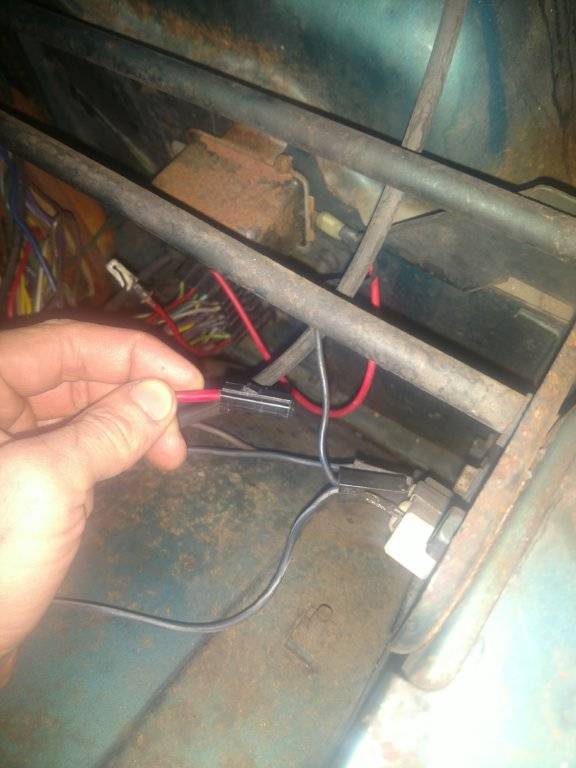

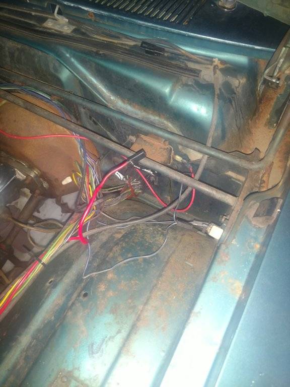

Ok! I got the vehicle running. After switching a bunch of spark plugs and wires and adjusting the distributor it runs. But! I had to hotwire it to get it running.
I bypassed the dash by plugging in the 12v wire that goes to the fusable link to the ballast resistor. Then I jumped the posts on starter solenoid.
When I turn the key to the on position the fuseable link starts smoking. And the coil isn't getting 11v now.
I don't know why it's burning up. I re-wired the car a few months ago because the ammeter failed. I butt connected the ammeter wires together and it fixed the problem. I also wired the alternator wire to the positive on the starter solenoid. That way I don't send 14v back through the entire dash.
Any thoughts about why my fuseable link is burning up? I'll try to answer any questions you can come up with.

The second problem with the fusible link can only be excessive current draw. Most likely it's a short somewhere, but it also could be something else that overloads the link. Any chance you have a high powered amplifier?

So I think the fusible link was burning up because of excessive current draw because I had the ignition in the on position for awhile. I made a new one real quick and everything worked fine. I kept touching it for about 10 minutes after I started the car and let it run. It was not burning up. So I'll call it a win.

One of the problems with ammeter gauges is the firewall connector terminals. drawing 50-60 amps through the connector causes them to oxidize and eventually burn out over the years. It's why relays are used for the headlights too. They are not sealed and moisture gets in them and causes corrosion also.
In the 70's chrysler changed to a wire going from the alternator to the battery under the hood. a couple small wires were spliced in at calibrated points and the ammeter was changed to a voltmeter. Looked the same to the customer but solved the connector issue. (A voltmeter draws very low current.)
