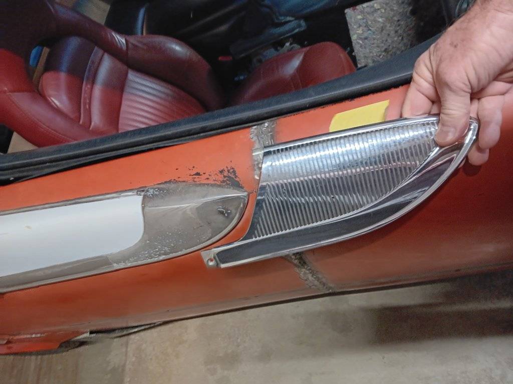

I said take the fifth, not DRINK the fifth! Ok, fifth time's a charm... I think this panel is a winner. I took Mopar's cue and hid the seam under the trim that they used to hide the fin seam. Just gotta figure out how I'll cut and blend in the forward seam..
In other news, I dug out the replacement pieces I bought for those pot metal, arrow looking things on the most forward part of the fin... Surprise they don't fit. I bought them as 1959 Coronet pieces, but it appears they are 1959 Royal Lancer parts... I knew they were longer front to back, but didn't realize (til now) that they fit the fin differently. I'm guessing the Royal Lancer stainless trim is on the top of the fin where mine is down in the valley.

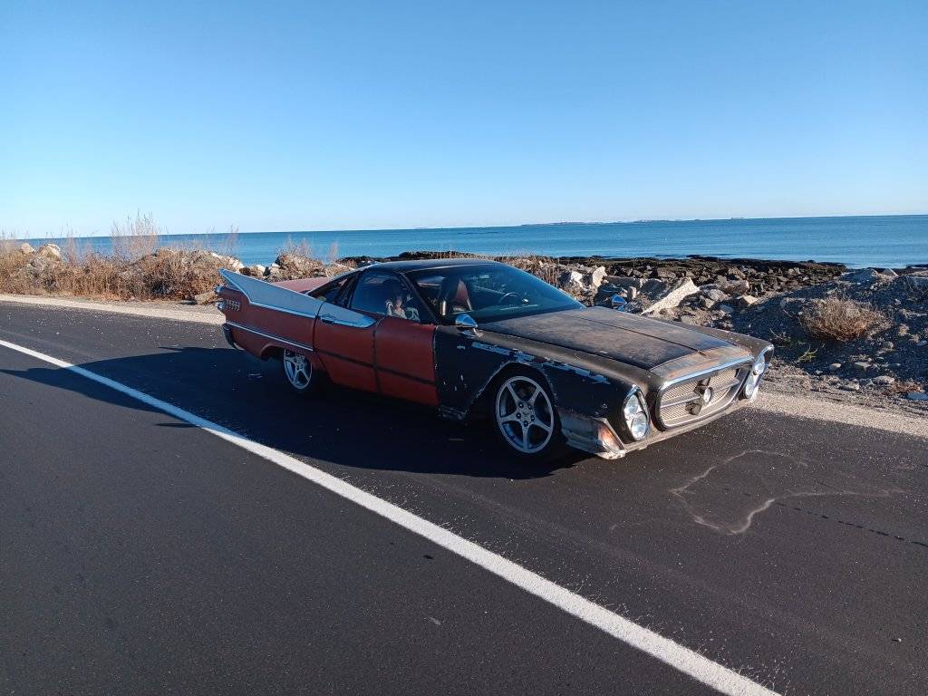

Heavy rain recently had pretty much washed the salt off the roads... Took the opportunity for a drive to the ocean...
