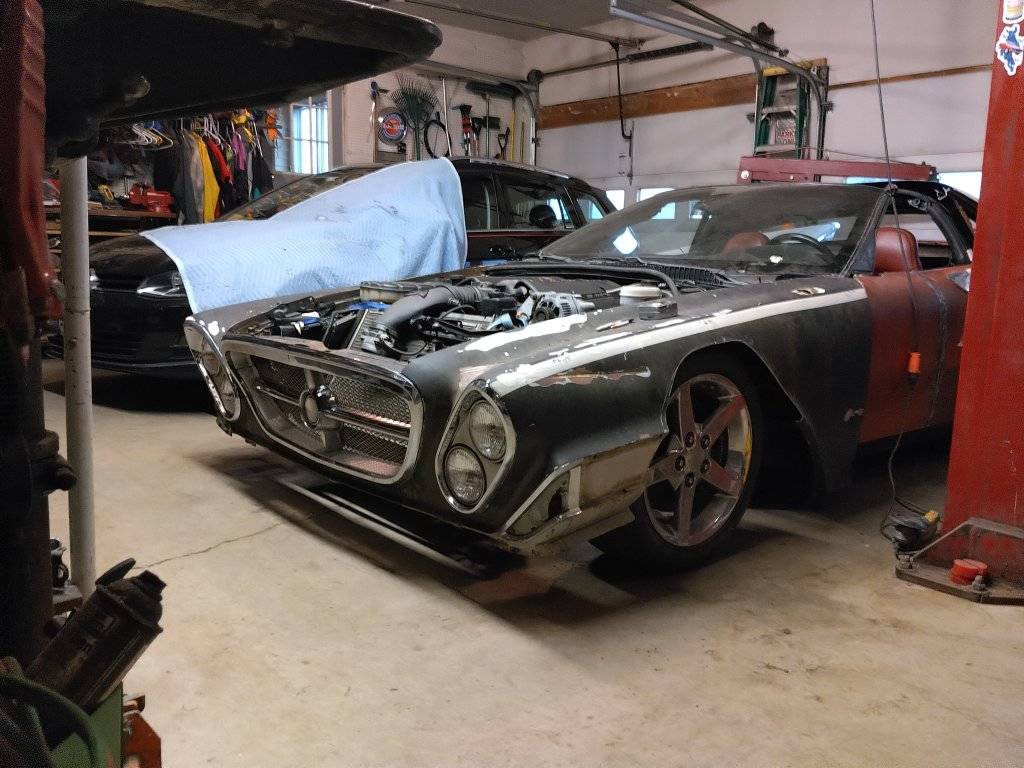

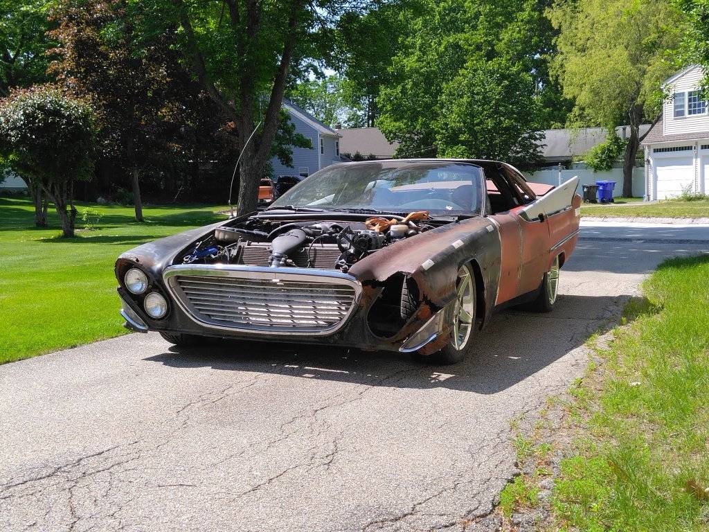

Not much happening recently... 300 grille shined up pretty nicely, one small crack in it but I think I can hide or disguise that enough to run the piece as is. New fenders and grille mostly bolted on and cardboard template applied to right fender.... Maybe cutting this weekend... (my garage time gets pretty short during the summer as it competes with other activities)
Cut the fenders again. Very happy with the forward contour now, less happy with the upper rear contour. I suspect I'll live with it since welding a small piece back in to soften that angle will make it difficult to add back the flare.

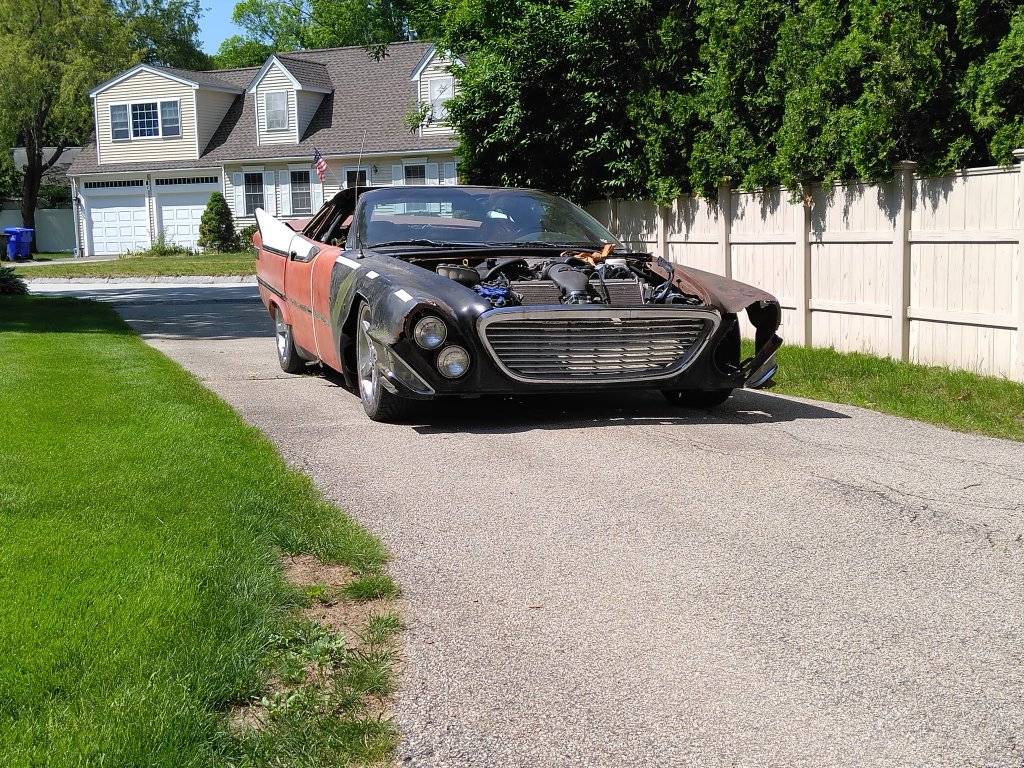

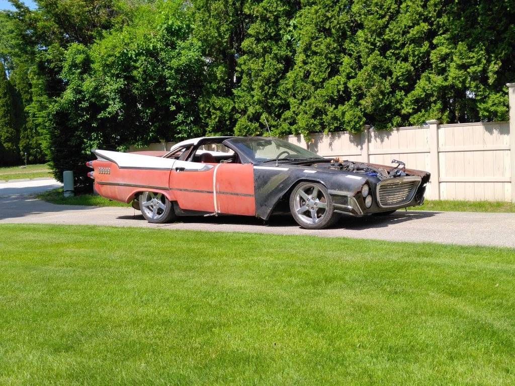

Teaser pic with grille and headlight trim in place... Next it goes outside again once the freakin rain in New England stops for a moment...

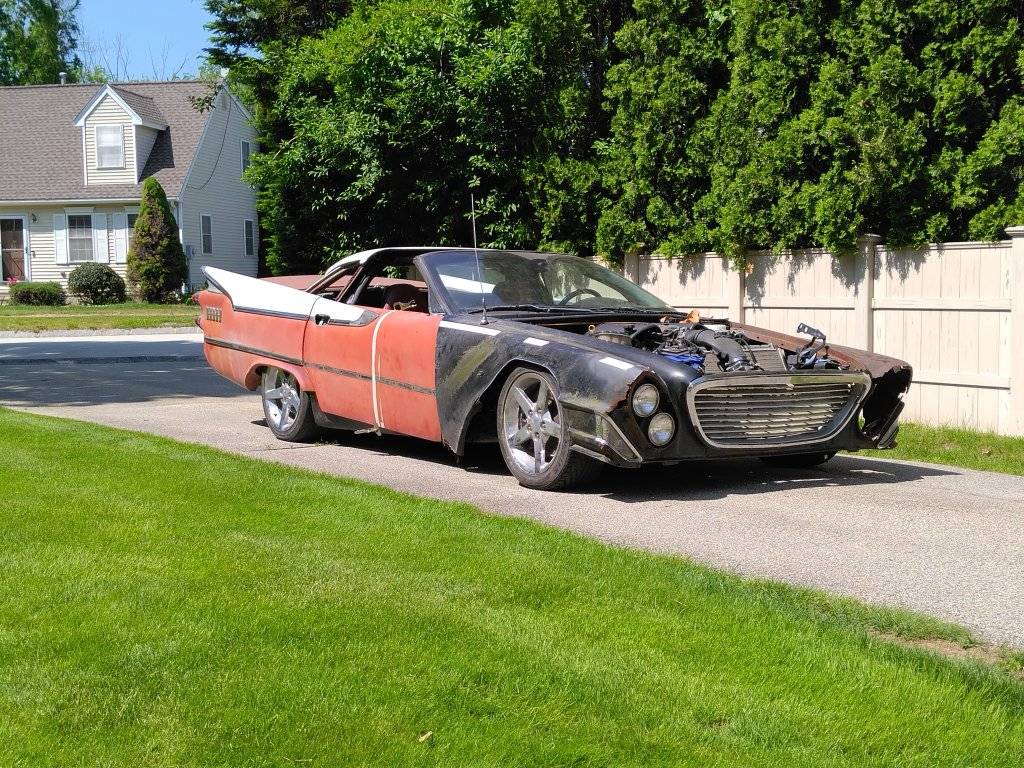

I decided to make sure the doors open before deciding on final fender placement and cutting. Good thing I did... I learned that modern doors ala 1998 corvette turn their leading edge IN but 50s vintage do not. The 59 Coronet doors have the hinge point much closer to the leading edge of the door than the 1998. I scratched several body parts wondering what I might do to solve this... I took a hammer to the 90 degree flange on the trailing edge of the fender and changed that 90 to about a 45 and it worked! The door opens now swinging it's leading edge into the inner fender area.
As an added bonus, the latest alignment might allow the hood install without cutting a hole..

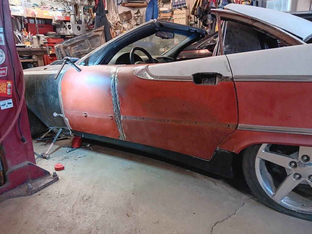

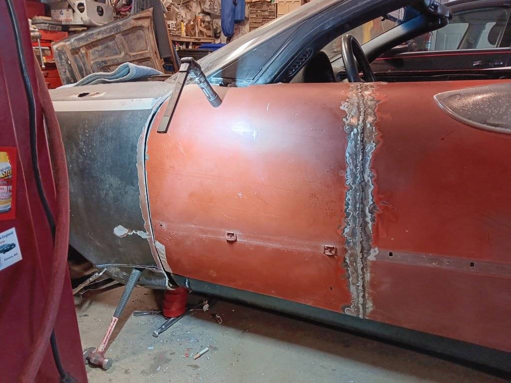

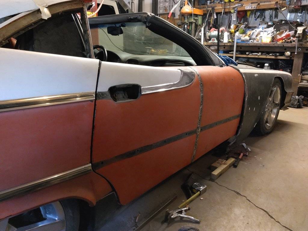

A little progress yesterday. Got the right door skin just about ready to weld the 2 halfs together... For some reason yet to be determined, the Corvette window glass clears the 1959 sheet metal better on the right door than the left. I suspect just a little different curve along the top from one to the other....

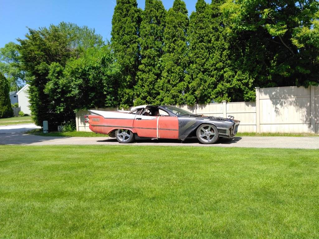

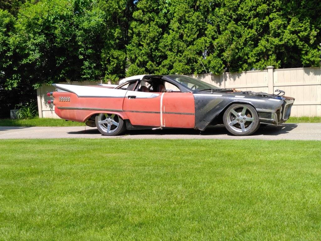

Right door finally trimmed and tacked together... Began on fender leg that needed to be shortened to align with Corvette rocker panel..

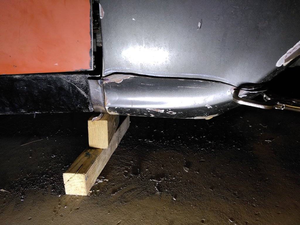

Made a small piece to fill the gap left by the Corvette front fender and to transition to the Chrysler fender. Next I'll slice that body line on the Chrysler fender back a couple inches and flatten that area to meet the new piece. Should work...

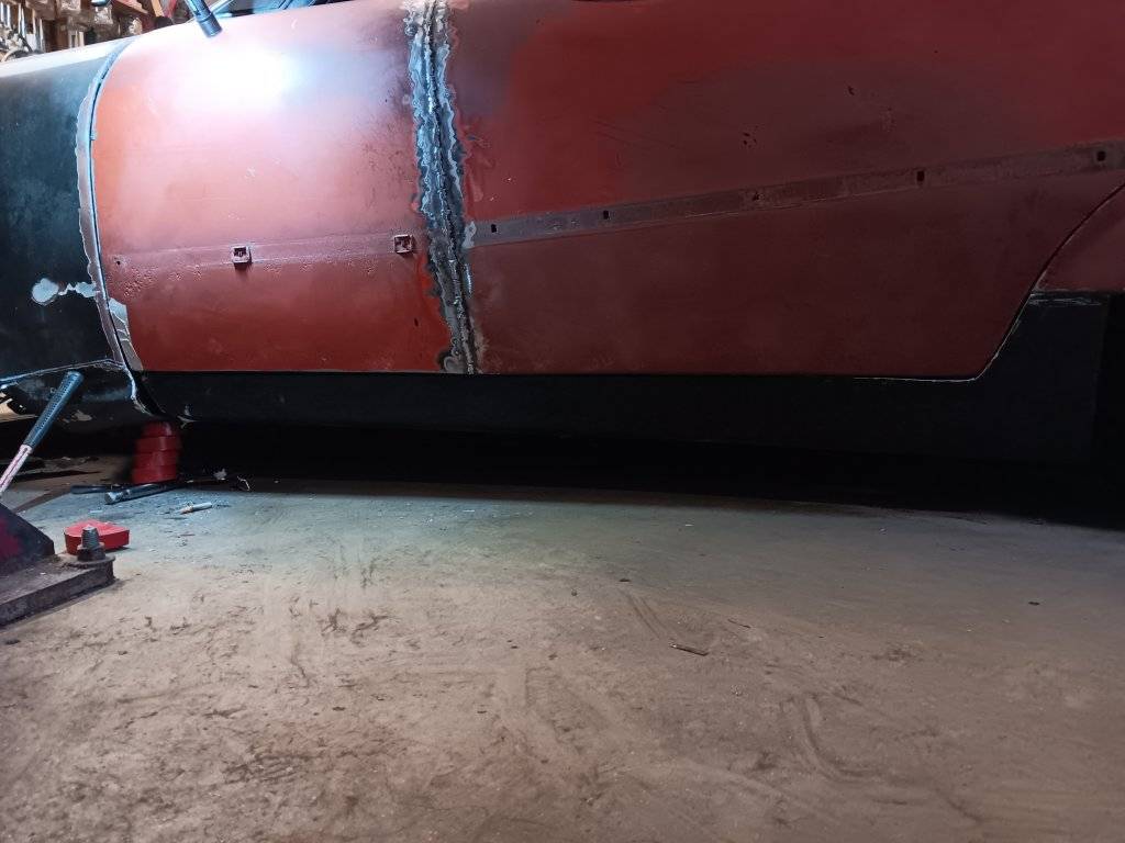

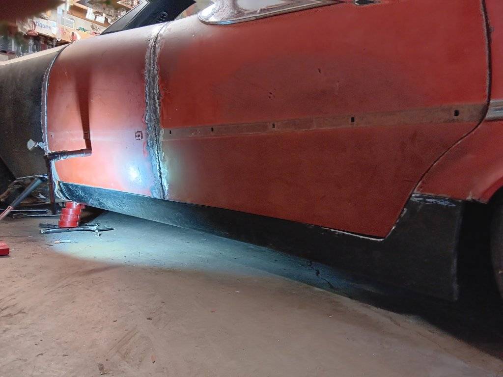

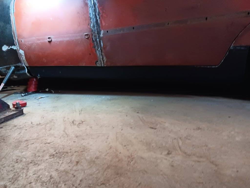

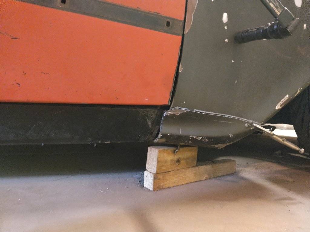

A little progress on the left fender and door. Alignment getting better. Fender trimmed at the bottom and mocked up. Filler piece like the other side next. 2 minor surprises today. The flange on bottom of left door was too low. Pretty easy fix, knock it back straight and rebend it in the brake. I had to crimp it onto the Corvette door structure to know where the fender should bolt on. Then I notice that while the bottom of the door (the newly bent seam) is straight, the corvette rocker is not.. It's curved inward front to back. I'll noodle this a bit, but current thought is cut the FG rocker and make it straight to match the door. Door matches quite well lower front corner and lower rear corner.

yup, fiberglass rocker. Should be pretty easy to slice it and shove the middle section out. I have a ton of FG work in my future anyway with other fixes and making the door structure fit the skins in a few places...
