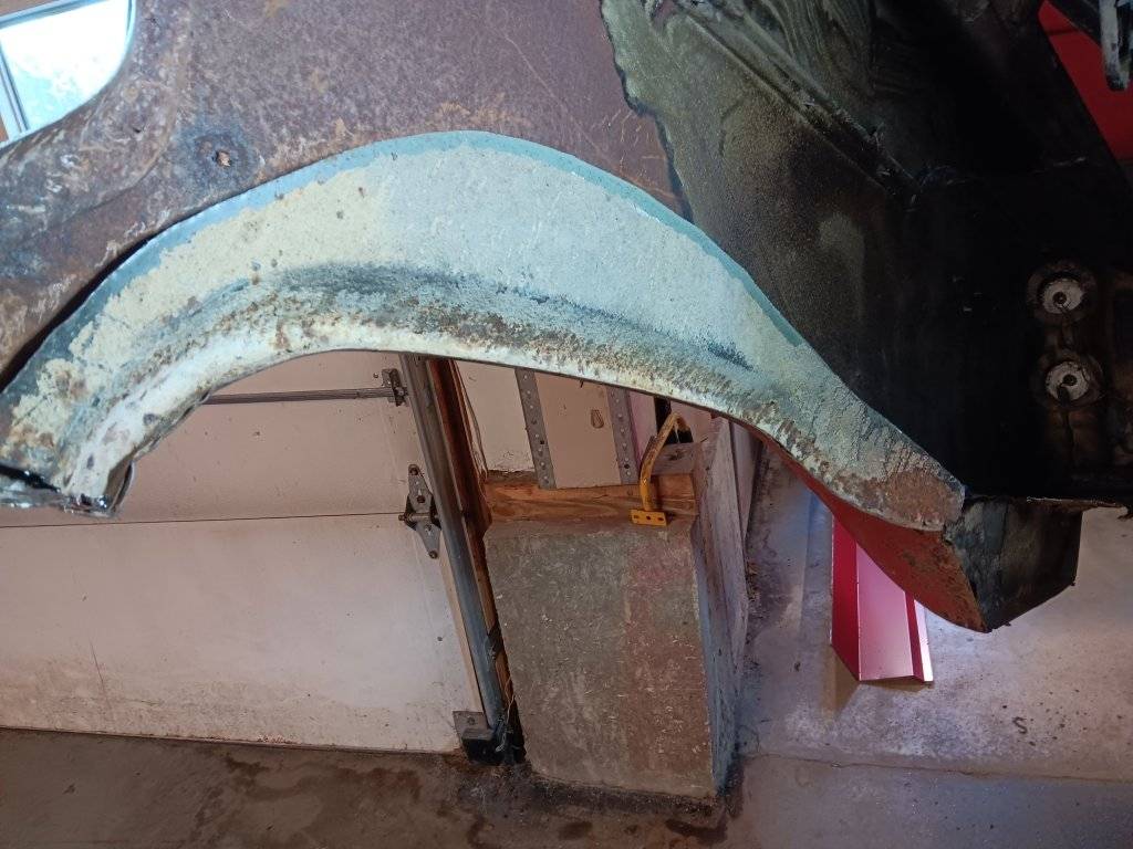

Boris got his frame pieces in place ready for welding and all his Mopar sheet metal removed in preparation for a trip to the welding shop. His rear inner fenders contact the tires a bit. I thought I'd just remove the small amount of the inner fender that remains, but I'm not sure it will get the job done. Here's where it's rubbing..

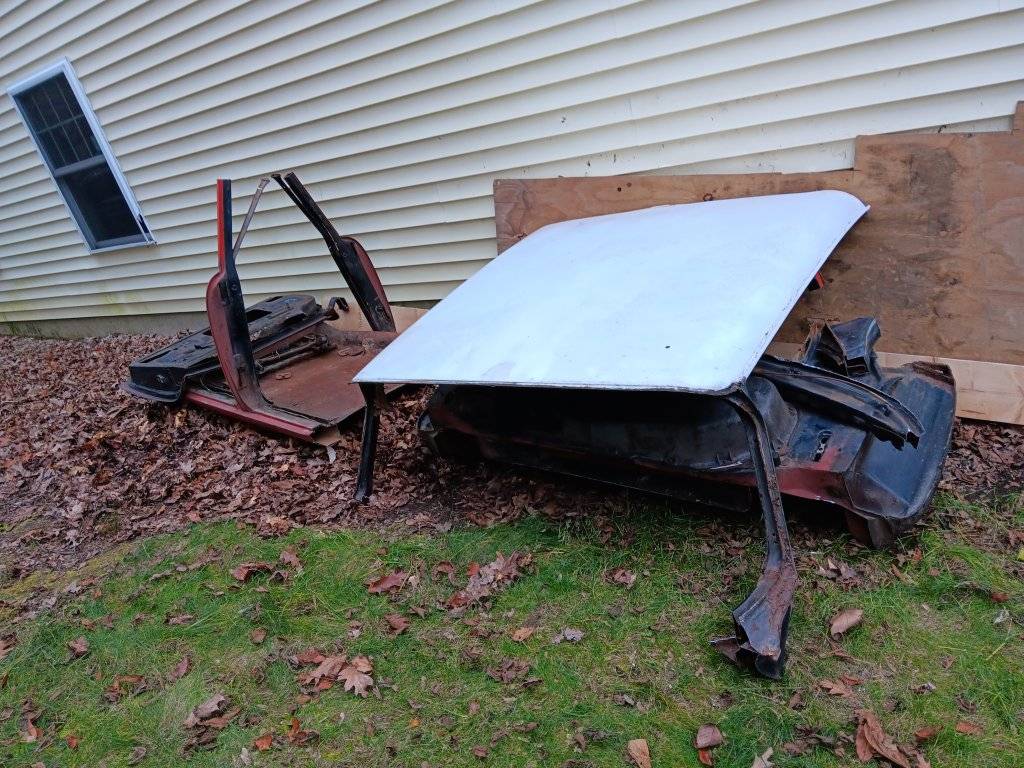

The remains cut up into bite size pieces.. I'm keeping the WS frame area in case I ever get the bug to replace the C5 windshield with a 59 model...

I think I may have a solution to my tire rubbing problem... I swapped the front 17x8.5 ET 56 wheels/tires from the front to the rear replacing the 18x9.5 ET 58 models. I get a shy half and inch further away from the inner fender and it seems to clear the calipers and suspension just fine. I think that will work, I'll just run 17s all the way around and it supports my process of making the car continually handle worse than it did as a stock C5 Corvette. :thumbsup:
