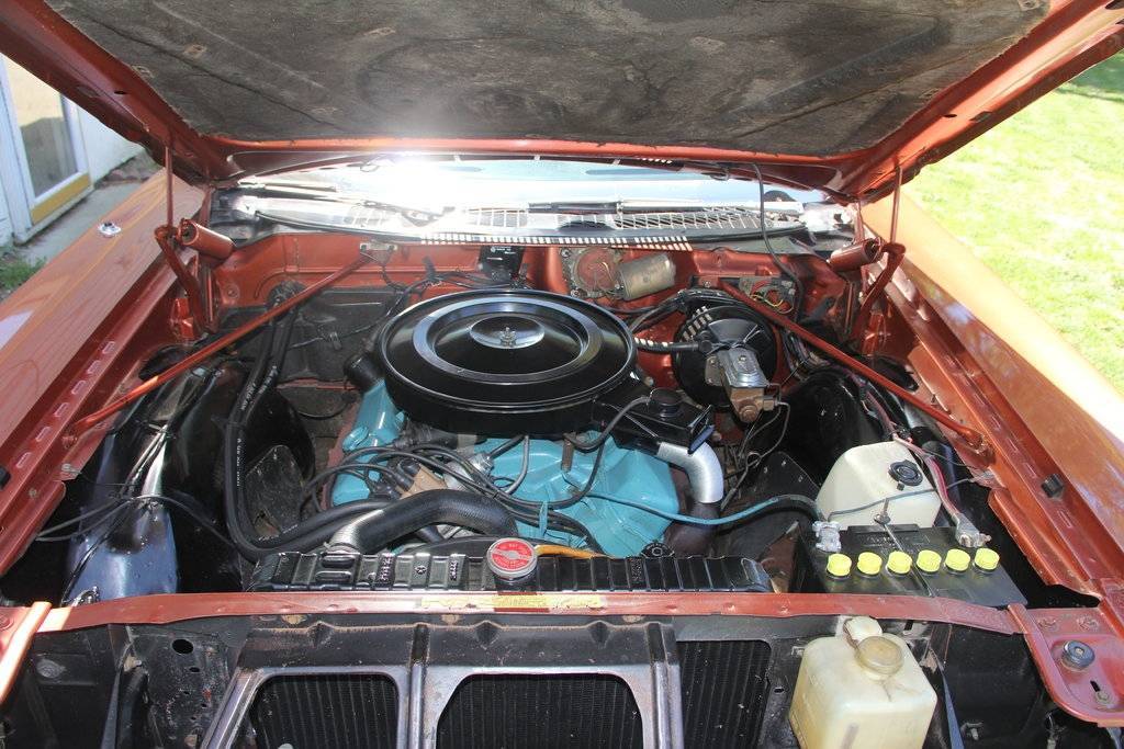

Restoration batteries simply look betterView attachment 140272
