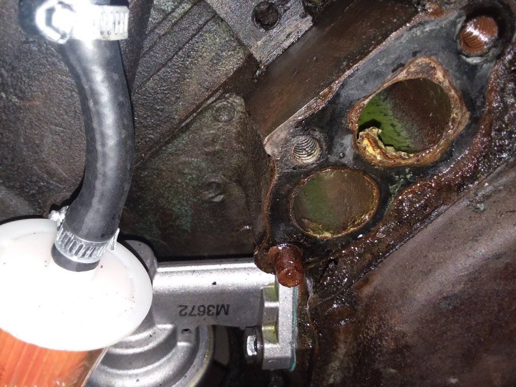

I got the water pump housing off and got extremely lucky. Look at the broken off bolt stud at the bottom of the water jacket. It's sticking out far enough, think I can get it out.
I soaked it down with ATF and waiting now.
Tried moving it with vise grips, no luck yet.
Not trying to force it yet. Taking my time like @cantflip said.
Mighty fine! Yes. Take yer time with it. If you can get some heat on the area around the broken bolt (do you have a torch?) and a lot of PB Blaster on it, you may get luckier still. . .
Thanks RIP. I need to pull the gas line off tomorrow then I'm going to heat it. Safety first. I have Mapp Gas and hoping that will work. Just ordered new water pump housing bolts. Hope they ship soon. I tried AeroKroil, no luck. I'll try PB and some heat.
Worst comes to worse I have a friend who is a machinist and he'd do it for a good steak dinner on me.
