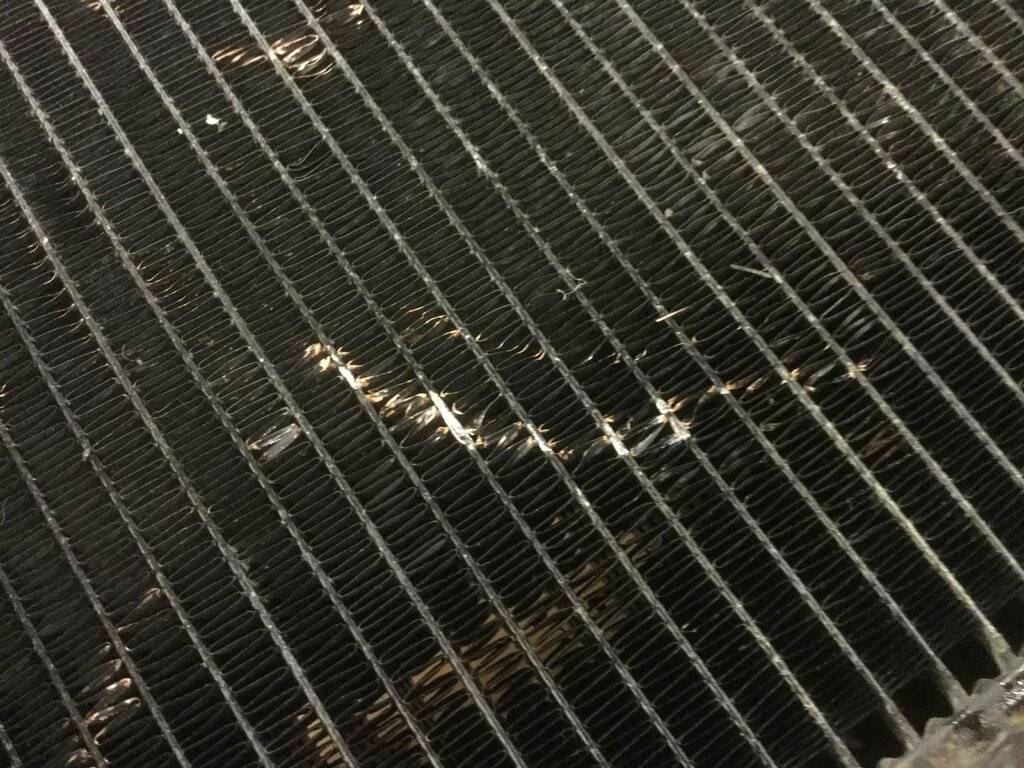

Just got word from Jimmy at Valley Radiator. Looks like the fins/tubes of my radiator had some sort of calcium build up them which he said would decrease the efficiency. He is ordering me a VistaPro radiator. Said he didn’t believe in the aluminum radiators as much as he did the copper/brass ones. He mentioned the grounding issues, ph issues, electrolysis, etc. He said they weren’t bad... but just recommended the “old school” style since that’s what was in there to begin with. He emphasized that Chrysler engineered things to work the way they were supposed to for the cars they were made for. He also said not to get too involved with aftermarket things such as thermal fan clutches, lubricant additives, etc. I guess Modine was bought out by VistaPro and pretty much kept up with the quality. LMK what everyone thinks and thank you all for being such a big part of my decision process!

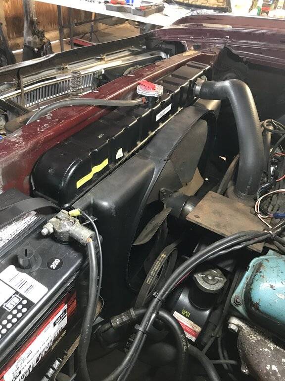

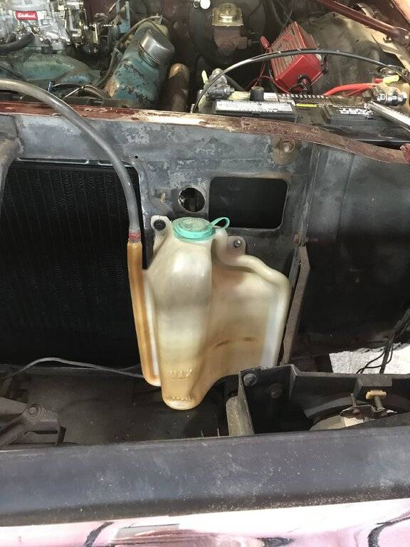

So here’s where I’m at. New VistaPro radiator installed. I’ve been told that this car didn’t have an overflow... is this correct? If it didn’t, is there anyone that has a ‘69 300 that can suggest a better one than I currently have and where the best place for it is. The line I have now going from the radiator to the tube is where it was when I got the car but obviously I will be rerouting it so it doesn’t get pinched.
Also, seems as though (using same mounting holes as when I got it) the radiator is not level with the cars frame. It is tilted downward on the drivers side... if anyone has pictures of the mounting holes they have please lmk. I’m not exactly sure what is original and what holes have been added over the years.

Get your money back from New Vi$ta Pro. Stuff like aligning the mounting holes for the radiator support on a given automobile model is BASIC! If they screwed that up, then WHAT ELSE (OK, I ADMIT I'm begging this question.) did they screw up. Kwollitee with Kapital K bro.
So, yoke was designed for 22” radiator because the car wasn’t designed for a/c. What I got with the car with was a 26” radiator, so, I got another 26” radiator. Pretty sure that’s why mounting holes don’t line up exactly. Must have been the plan of the previous owner(s) to put in a/c (hence the bracket) and therefore the 26” radiator. So... I leveled the radiator, drilled a couple new holes, and voila, im all set.
I met that ccas doesnt sell a radiator for cars that came with a 22 inch radiator
The MOP753a, ( https://www.coldcaseradiators.com/product/68-73-bce-body-16x22-auto-aluminum-performance-radiator )which I have is rated for the 22" carrier, and does bolt up, BUT, its a 16x22, NOT an 18 x 22" surface. Despite that detail, it has greater fluid volume and cooling surface area, with the high fin density and 1.25" tubes. Mind you, they have an 18x22" radiator, the MOP751 ( 62-74 A,B,C,E Body 18x22 Manual Aluminum Performance Radiator | Cold Case Aluminum Performance Radiators) which would work nicely on early C bodies, '62-64, BUT, due to the smaller return hose port, WON'T do well for much later. I've begged them to take the core for the MOP751 and weld the tanks and hose fittings from the MOP753 onto it, which would make a PERFECT 18x22" C body radiator which would utilize those extra 2 inches provided by the 18 inch radiator mount which my '66 Newport, like MANY mid 60s C bodies really needs! If others of you besides myself start yelling at Cold Case to MAKE SOME 18 X 22 INCH RADIATORS WITH THE 1.5 INCH INLET ON THE TOP RIGHT, THE 1.75" OUTLET ON THE BOTTOM LEFTm then I think they would find MANY CONVERTS FROM THIS FORUM AS WELL AS OTHER OLD MOPAR BLOGS!
The pity is, Cold Case makes an EXCELLENT radiator, with high fin density, combined with dual rows of 1 1/4 inch tubes that can cool a B/RB motor even in city traffic during the 110 Fahrenheit summer days of Southern Arizona, but for want of a little innovative design and marketing, they're losing business they SHOULD be getting. I notice Speedcooling is making the very size radiator I'm describing again, though he uses only 1 inch tubes, and is somewhat irresponsive to his potential customers in different ways.... SIGH!
Good job! Making do is something we all CAN do with our C bodies. I've been tempted to cut my 22 inch yoke, but would prefer to get one meant for 26" radiators. The way the sheet metal is rolled to give support and all makes me think twice about cutting. Of course, yours came that way, so you have nothing to lose. Stay Cool!
