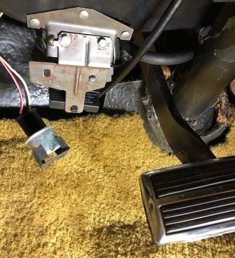

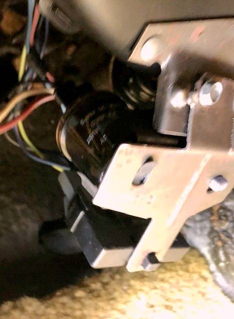

Found it. It is not located on the top of the steering column, but on a steel bracket located on the Heat/AC duct, behind the brake pedal. See the photos, hope this helps.
