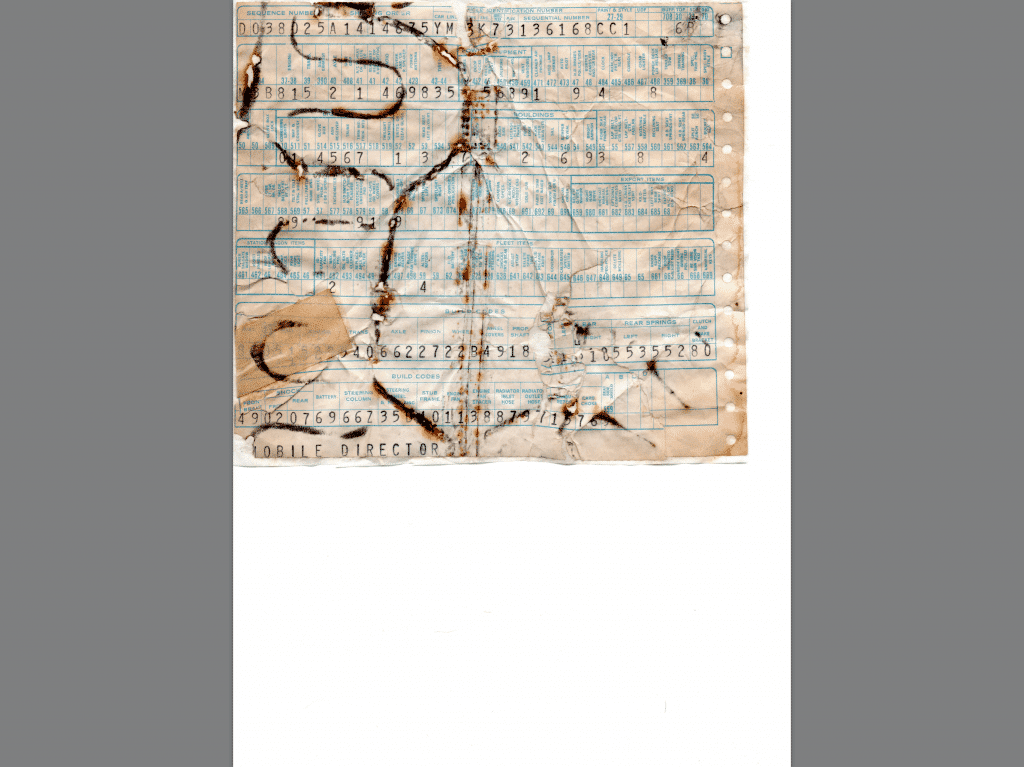

Big Blue's build sheet was under the rear seat for 50 years. Carefully removed from the car, the paper was disintegrating, crumbling. After studying up on how the U.S. Library of Congress preserves things like this, I laminated the build sheet pieces to a sheet of Japanese Mulberry paper using homemade wheat paste adhesive. Barring fire or flood, the document should now last for at least 200 years.
I'm going to go out on a limb here and guess thst it is in a 15th Century Italian Renaissance frame. . .
Do you have a pic of it? I would love to see what you have done to it.
I have the preserved build sheet as a PDF document. I'll try to attach it. Still looks like hell, but at least it won't degrade any further. I think you'll have to download to see it.
  • IMP BUILD SHEET.pdf
I can expand that on my screen and read it all just fine.
Big iPad and readers...
Love the Mobile Director in big print at the bottom. Some how I missed that it was an actual Mobile Director Imperial. I thought you made it just because it would have been an option and really cool.
The main reason I bought this Imp is because it is a real Mobile Director. Had to recreate the table because the first owner lost it or stored it somewhere his widow couldn't find it.
