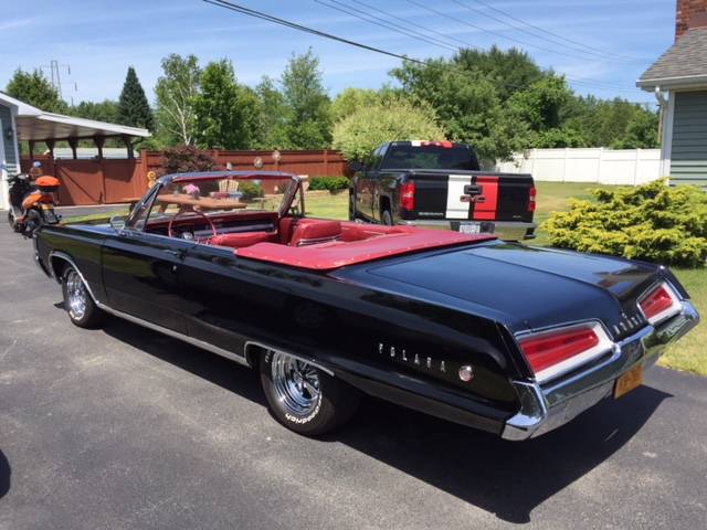

Hey guys, I got some 15×8 slot mags for my Polara and was wondering what the biggest rear tire I can fit is? I'm going for the sleeper track car look. Photos of yours are appreciated.
Thanks,
Gabe

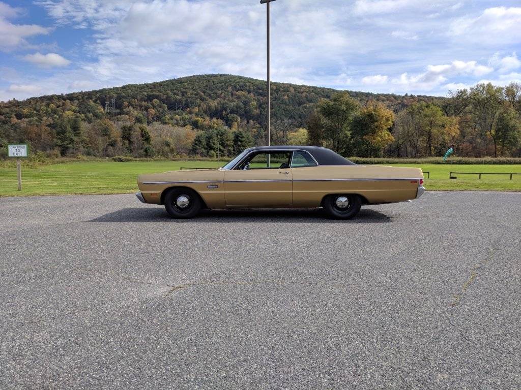

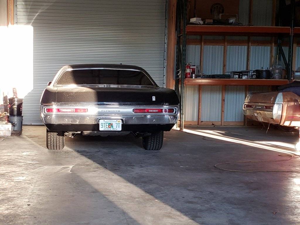

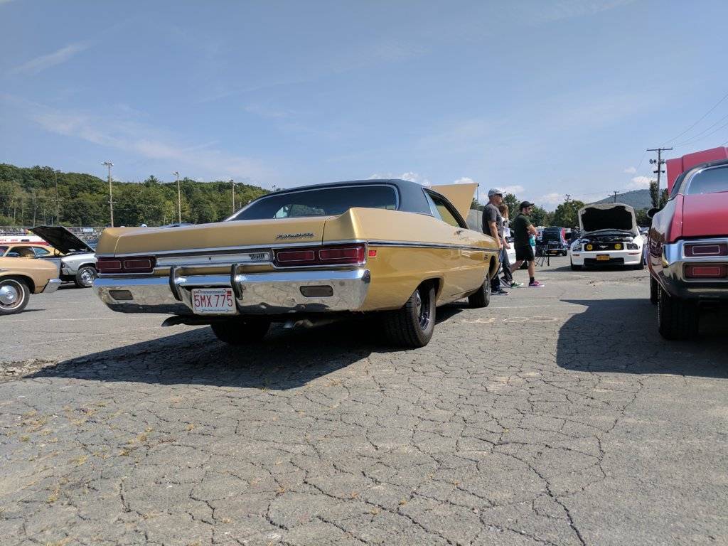

I fit in my 69 Fury III in the rear a 275/60/15 on a 4 1/2 inch backspacing if that is what you are asking. Your results may vary,,do your research.
