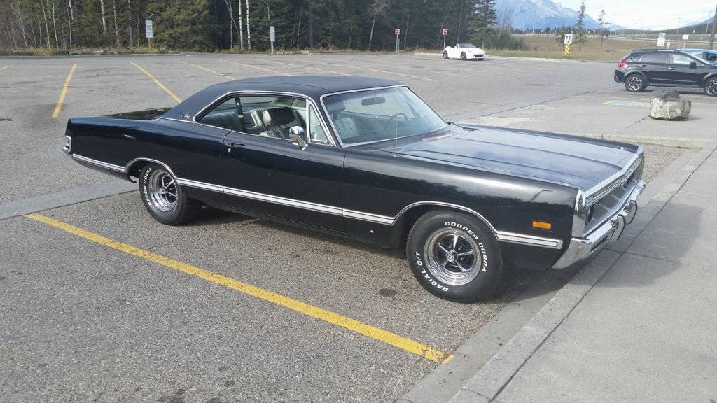

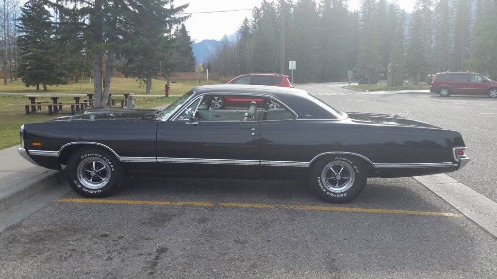

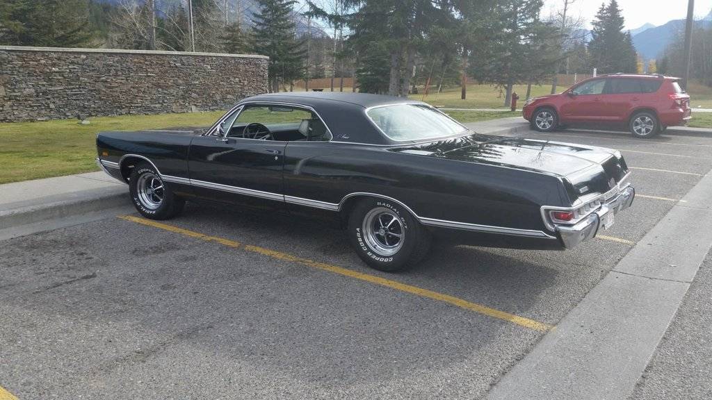

Hi ALL :)
I'm looking to raise the rear of My Newport ( to get that 70's - 80's Street Machine Look )
& am looking to see if anyone know what is the widest & tallest tire I can put on the rear axle , with out tubbing the car?
I would really like to put a deep dish 15 x 10 wheel in the axle
Picture below is the look I'm going for... but in My C Body.

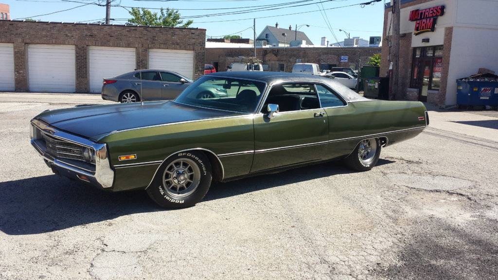

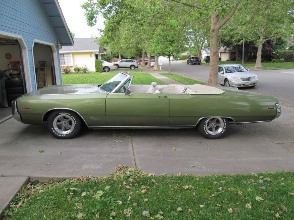

I would suggest that you use those mopar rims you have and place on the rear 255/70R15 and on the front I would go with 235/70R15 this gives you just over an inch height difference(total diamenter) on the rear vs the front. You could also go with 225/70R15 on the front that is another half inch front drop but a 225/70 might be to small looking (IMO) for a full sized fusie. You could also and 1 extra leaf spring on both sides with the cargo shocks(coil-over) this combo will give you an inch and a half alone. A slight rake is fine for a c-bodie (IMO) but only 1"-2" max but what ever floats your land yacht. I will include a couple of pics of a 69 Monaco with 255/70's on the rear and 235/70's up front and a 71 New Yorker with the added leafs and coil overs shocks. Tires on the 71 are 235/75 out back and 225/75 up front. Slight rake only. Torsion bars can be adjusted also for height but you might be playing with havoc on your front end components..you could also get rear air-shocks if you want to really raise the rear if you were to go with 10' rims out back you would have to go with sir shocks to clear the fender lips but that kills your comfort and ruins the look (IMO)
