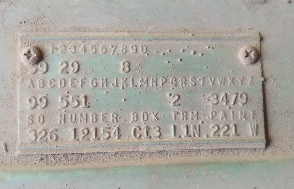

Can somebody please help me decode this body tag? I can't seem to understand how it's done.
What year make and model?
The bottom line is SO sales office number, number body number, bdk body style eg convertible and in the Fury line for example probably indicates series like Fury 1, 2, or 3. Trim is upholstery and color - L "may" indicate leather, paint is self explanatory.

Here's a reference that works quite well
1965 Mopar Fendertag codes
Yeah, what he said. That's where I was headed. It lists most of those codes, easy to use, just match the letters and numbers up to the list.
But I'm case you can't wait.
2=2 Fender opening reveal skirt
3=9 variable wiper w/ washer
AB=99 standard cid engine 8 cyl ( w/ positive crankvent system)
D=5 automatic
E=5 heater w/ defroster
F=1 Power brakes
Q=2 a-m astrophonic deluxe
V=3 back up lights
X=7 front retracting belt
Y=9 fender turn light
3/26 Build date Chrysler Low price class 4 Dr sedan
Low trim level cloth and vinyl Black and White bench interior
Sage green monotone paint, white top(?)
That's from the internet, so a grain of salt.
When you use the reference tool. the ABC codes read with the alphabetic character first, then the number, for example from you tag A9, B9 etc.
