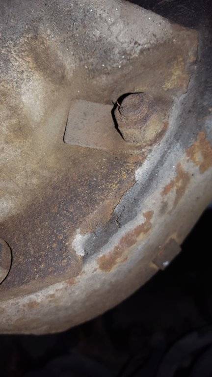

The previous owner (Waginator) mentioned that at one point he needed to replace the entire axle. He bought and had one shipped from a junkyard in the Southwest that parted out an Imperial. Not sure on the model year it was pulled from, but if I'm to believe the tag it's a 3.23. And if it's a sure-grip something is malfunctioning, because in the snow it only spins one tire.
I also see ``3.23``, which means that the ratio is correct for 72-73 Imperials because they were not available with other rear axle ratios.

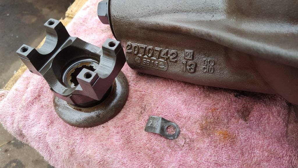

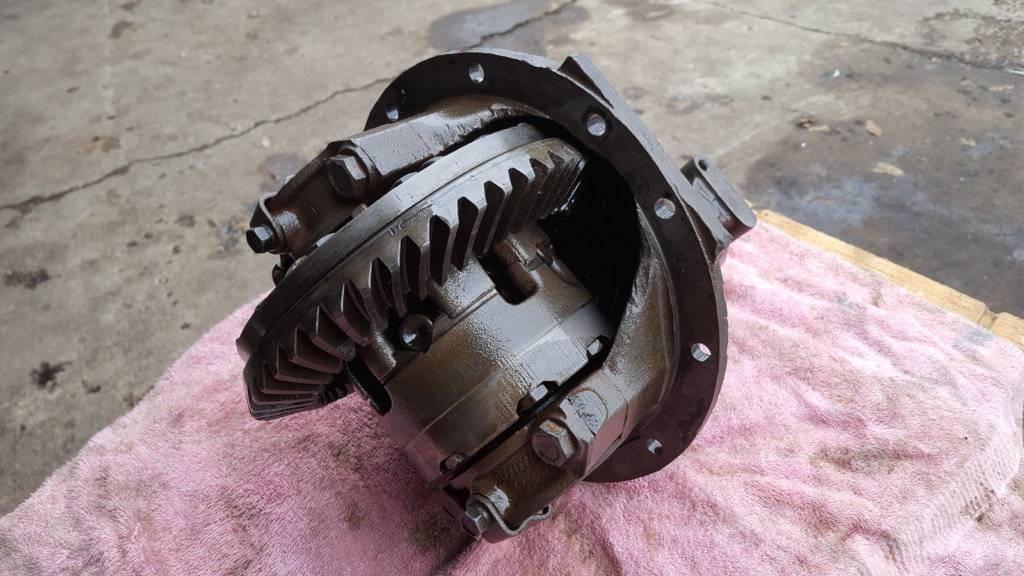

It's ironic that you asked because on Sunday I bought this 742 carrier that is optioned with the clutch type Dana "Power-lok" sure-grip. Blimp was difficult to get going on any type of incline in the snow and ice. This should do the trick. :D

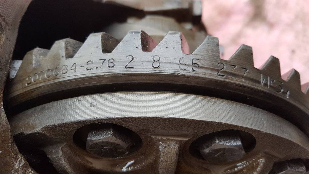

I assume the ratio is 2.76:1 based on the tag.
Yessir it is, should be interesting to see how much of a difference it makes on the highway. I'm going to guess that the numbers stamped 2 8 65 is the date when the ring was machined.

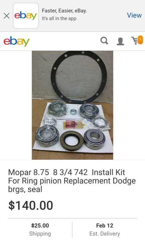

In the process of ordering a rebuild kit for it too.
