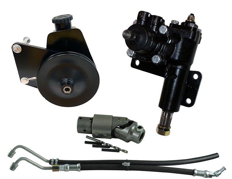

Yes I have done two swaps on an E-body and a B-body for clients. One promptly returned to have me install the stock firm feel set up. The box makes a pressured hydraulic sound up the steering column. On a c-body it might be better as C-bodies have the rubber isolator joint in the steering column. I would use the kit from Peter Bergman of

The BAC kit is A well thought out package for Mopar, Peter has developed the correct coupler for the shaft, so no steering columns need to be cut. Two thumbs up.

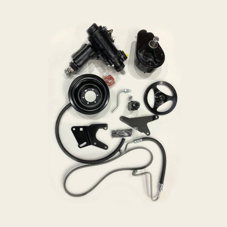

With the Summit kit you need to cut the steering column. No going back after that if not happy with the feel and sounds.
The Bergman Auto Craft kit is a no cut install.

Yes, my client bought the complete master kit so that he would have no issues with the instal.
The kit installed perfectly fine, for an after market kit it is very well put together. The only thing I remember having to do was clean some powder coating from inside the slide coupling.
If you have not bought the kit, I would go with the large sector shaft, will be easy to buy new pitman arm.

If you are ordering the steering box with large sector shaft then you will need large sector pitman arm. Moog K7076.
Small sector shaft pitman arms are very hard to find, if you do find will be expensive
