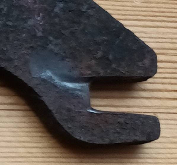

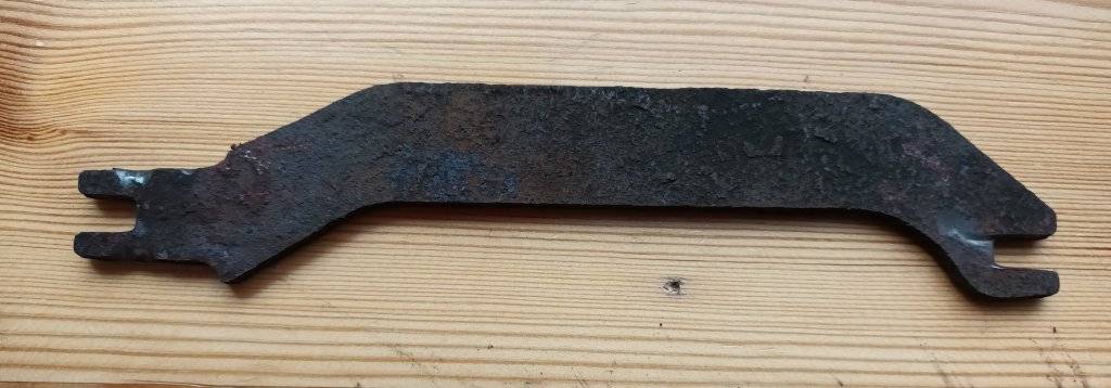

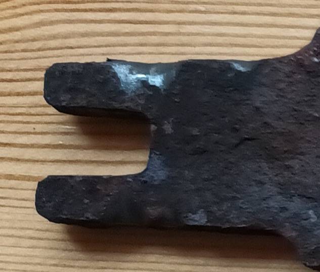

I think my bars are usable here's a coupla pics, there's just 2 small gouges, if you think they're too bad please say so.

Those Emergency Brake Bars are acceptable --- they don't get much wear....
See, if Ross agrees that they are " okay ".....
If not, put a thread out asking for some --- as I mentioned, they (whoever "they" is) can send them to me, and I will put them in with your goods......
