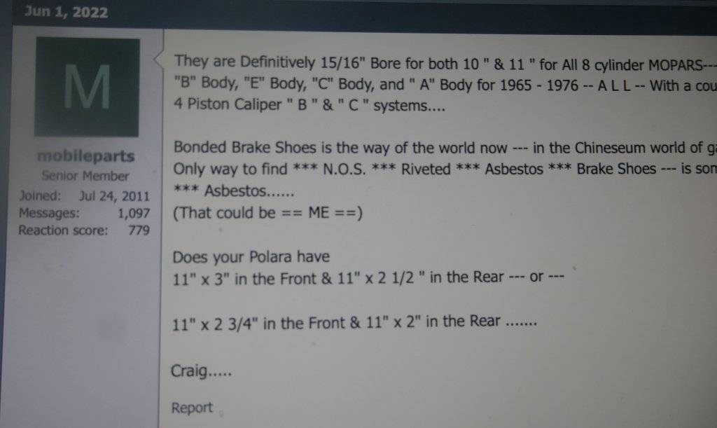

So, of course, from the Factory , when the Polara / Monaco was a " B " or " Pre B "
In 1962 - 1964 ==== they were ONLY 10 " x 2 1/2 " Front & Rear........
In 1965 - 1973 they became a " C " body , and were
11 " x 3 " in the Front with 11 " x 2 1/2 " in the Rear ---- O R ----
11 " x 2 3/4" in the Front with 11 " x 2 " in the Rear......
So, the bottom line is, what do youhave, what do you need, etc., etc....

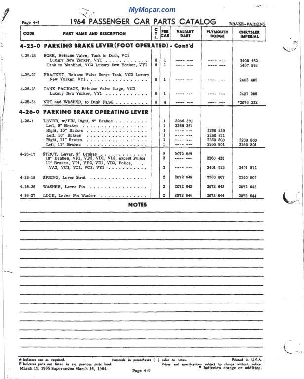

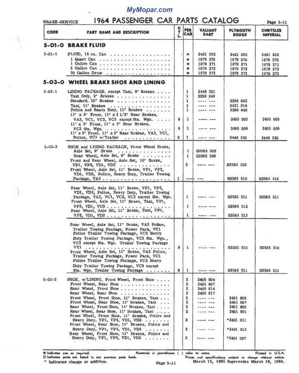

@mobileparts - Craig, I hate to question you, but your statement above has me confused, as my '64 parts book clearly shows that only VALIANTS and DARTS had the 9" brakes, and that the bigger cars (including the "pre B" Polara) had both a 10" AND 11" brake option, presumably based on engine size and such.
With the utmost respect to your knowledge and experience, perhaps your info that you've been working with over the years has led you astray, and perhaps doesn't include the export cars having 11 brakes (for what it's worth, there was a USA market 64 Polara at Desert Valley in Az with 11" brakes - I was looking for parts from it recently, and they confirmed the brakes size).
I have included pics of the brakes pages directly from my 64 parts book that shows the 10" and 11" option for brakes:

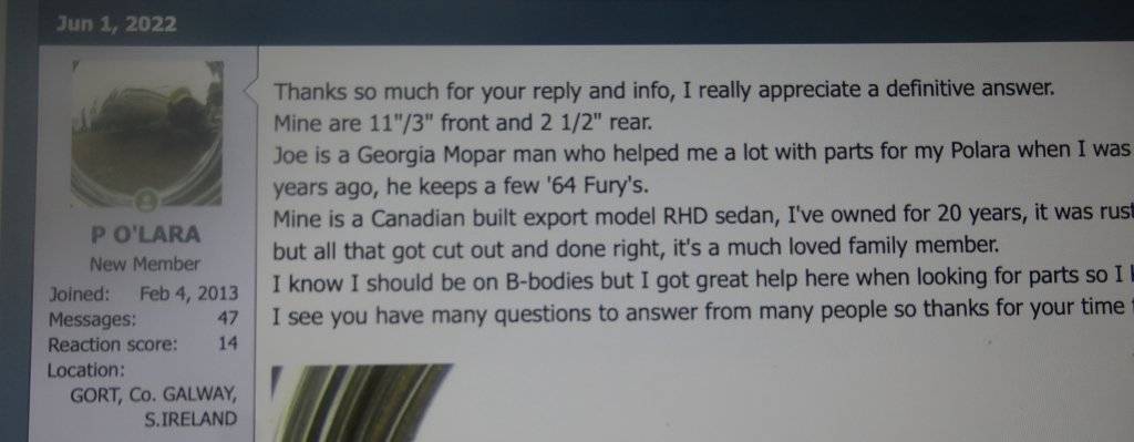

According to our correspondence, as pictured above, on day 1, June 1st, you asked me if I had
11 x 3 front w/ 11 x2 1/2 rear or 11 x 2 3/4 front w/ 11 x 2 rear, to which I replied 11 X3 /11 X 2 1/2.
This is what my car came with from the factory and I do not believe that this was a Canadian model only deal either as I have bought brakes for it before with no issues over sizes.
Hi Craig, The pics show what I have, the only things I can use are the rear wheel cylinders and the emergency parking brake bar springs.
What I need is 11" x 2 1/2" brake shoes and all hardware for left and right, back axle only.
