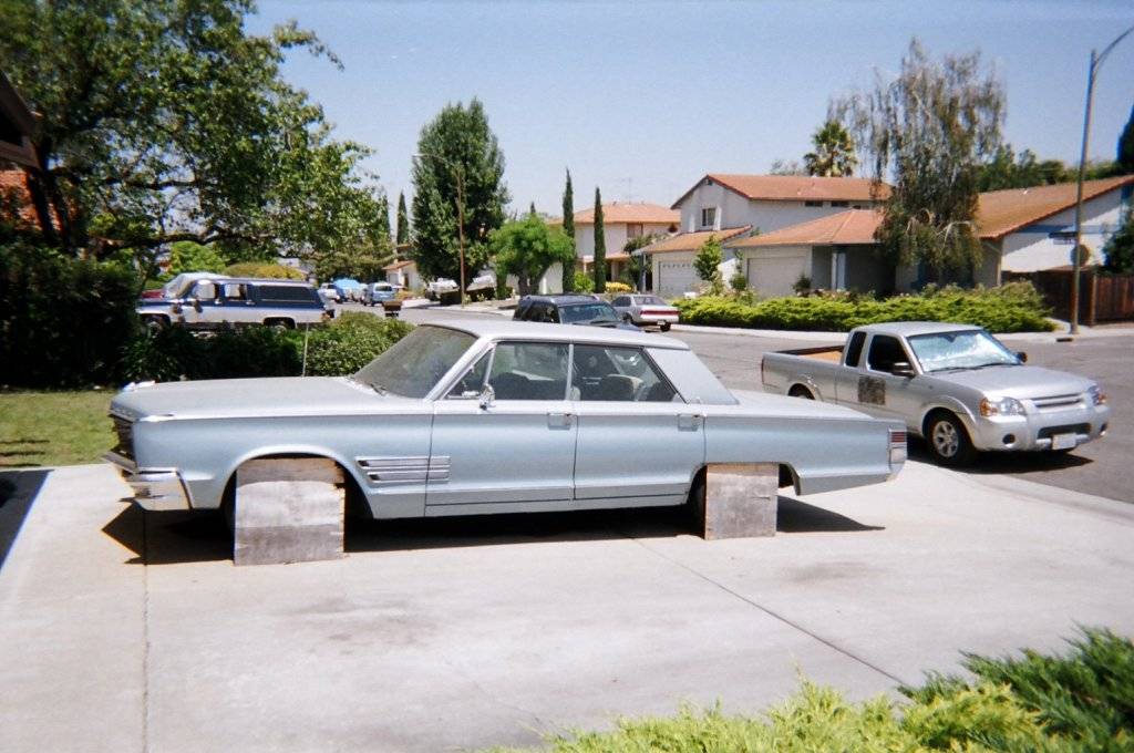

I wonder if those are rear shoes that for some reason ended up in the front? Don't know how to tell the difference on a C-body. Also I think there are two trailing shoes on the other side, another piece of evidence of not so skilled maintenance in the past. Now I'm super paranoid, and will tear into the rear brakes as soon as I'm done with the front whenever that will be. The car is out in the driveway since I figured this would be an afternoon's work, and I want to button her up before moving on to the next task. Best laid plans...
