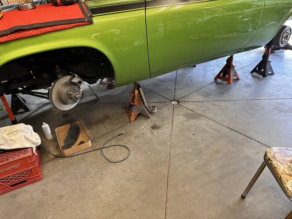

You can just see in the picture with the green GTX the forward jack stand. The GTX kinda felt too saggy to just support the frame rails at rockers.
This is a forward location I support because the C-bodies have so much hanging out there.

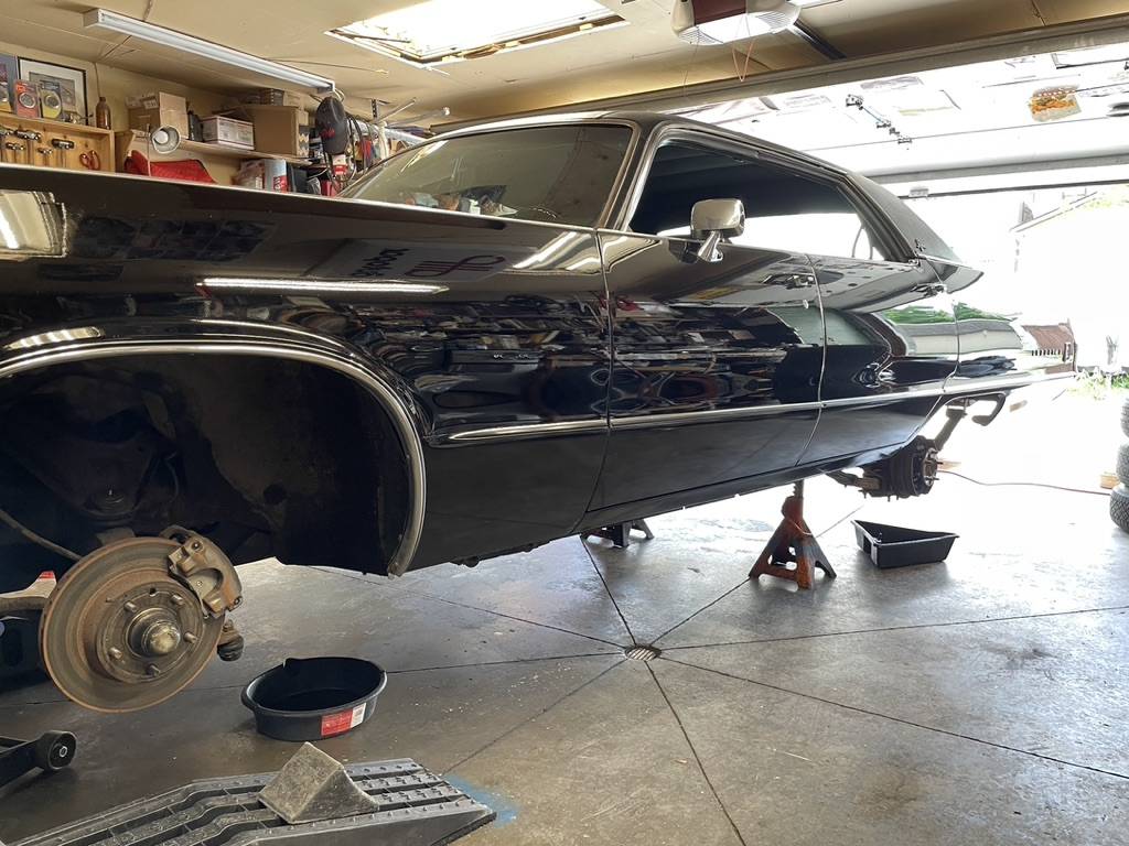

Used the forward support on the Imperial, I added a couple of stands under frame rails for under carriage work.
