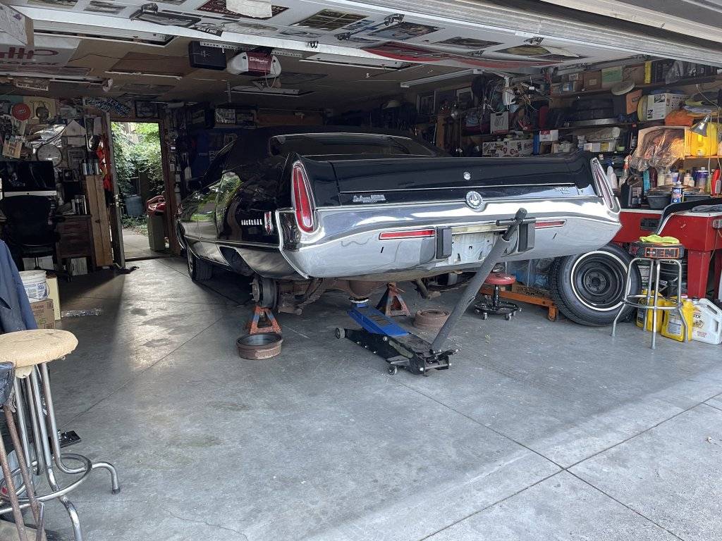

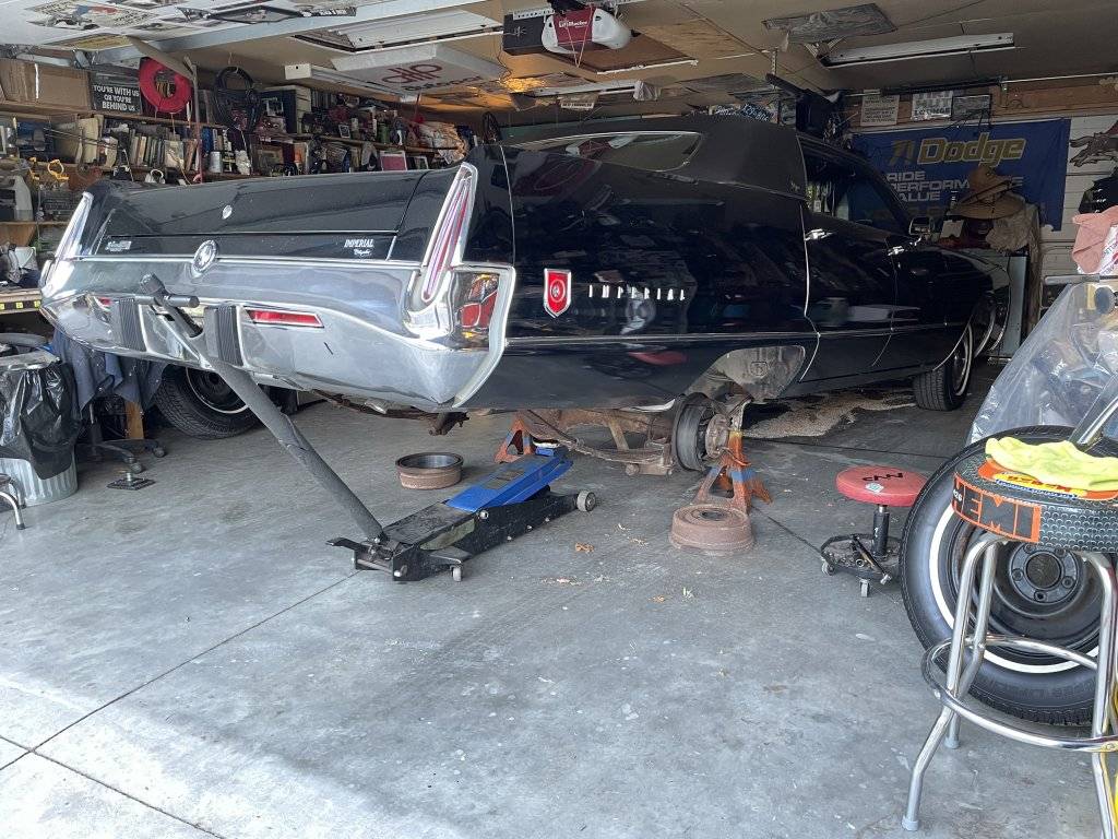

this is how i lift it now. View attachment 583378 cut to the chase and get yourself a lift while you're still young. note: the lift that Big John bought for his garage is a no brainer for anyone that has reservations about buying a lift. i'll let him tell you about it if he so chooses.

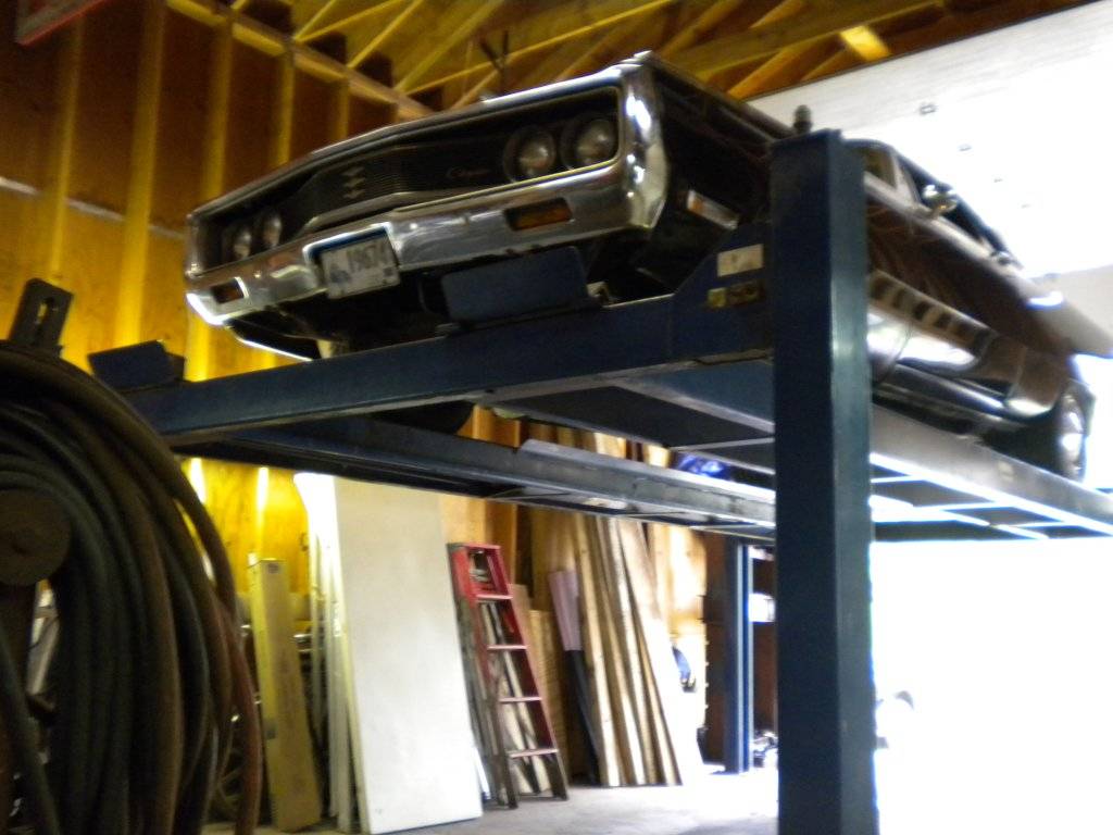

BTW, I have a Wildfire lift that I really like. 4 Post Car Lifts | Safest, Highest Quality On The Market | Four Post
Yes, you can lift under the stub frame and rear. (the C-body doesn't use a "K-Frame, it has a stub frame).

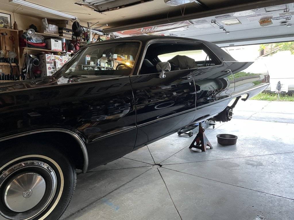

This is all awesome info - thank you customsportsman for asking - as I was going to ask about this myself since I have to replace my trans gasket. Just to clarify, it's ok to jack up on the rear pumpkin without damaging anything? I'd like to have a hydraulic jack front and back as well as jack stands. My wife also wouldn't notice the silence of a catastrophe until well past dinner time...
I can slide under my truck for whatever I need and her Equinox goes up on ramps. I admit raising this one scares the sh*t out of me.

I sometimes used ramps to get me started. I would drive up on ramps, then lift the rear to that height and place the jack stands, then go to front and lift some more, then repeat until I was at desired height.

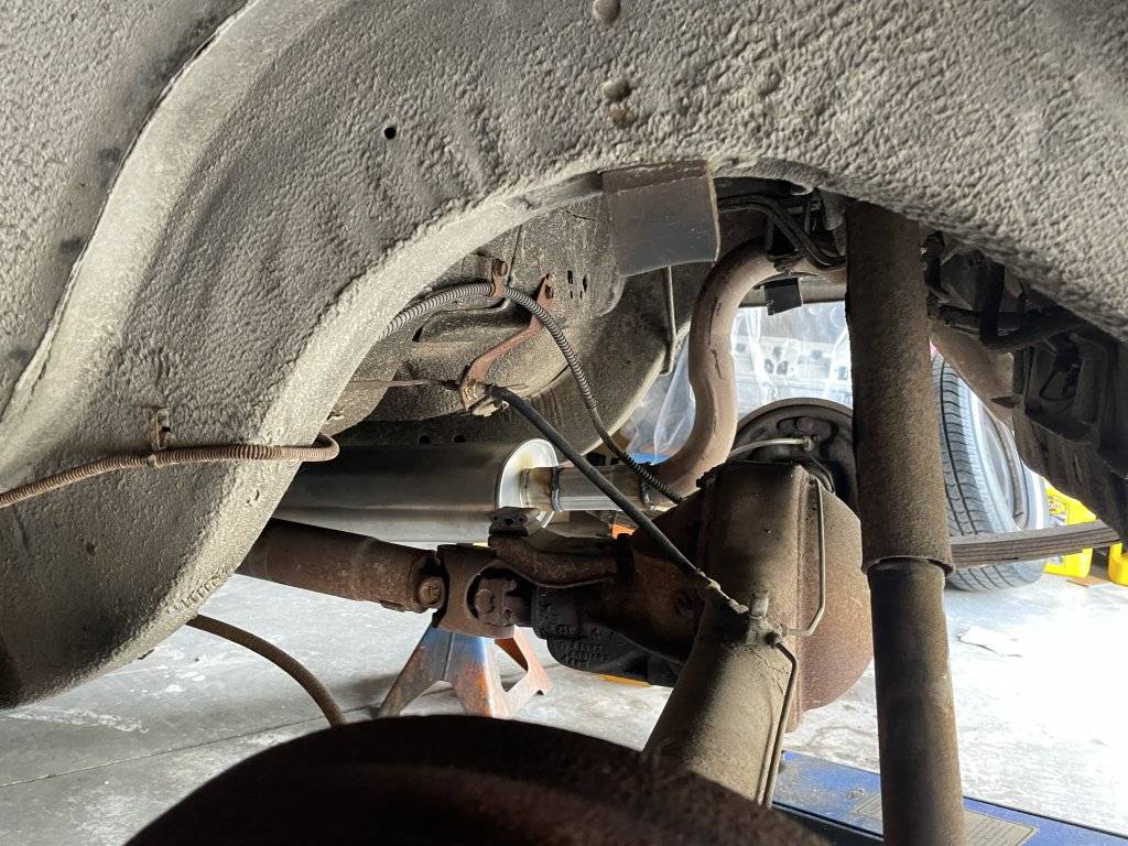

Here is a photo of the stretched rear flex line when you let rear axel hang. I change to 72 pick up truck rear line to stop the stretch.

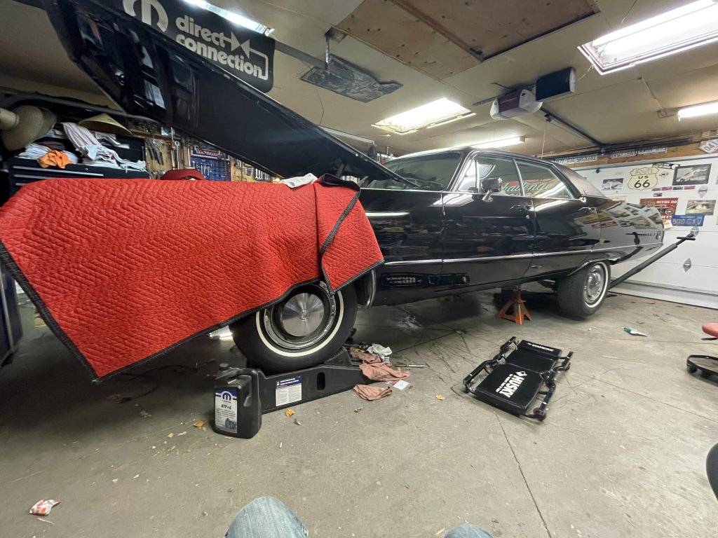

Just wondering if anyone has used ramps on all four corners and going by what Big John says of lifting one corner at a time I think it's do-able???
Right now I have ramps under the front wheels oriented backwards and I'm wondering if I can use ramps for the rear wheels as well oriented with the ramp towards the rear so the ramps are opposite orientation.
Seeing that I have the front up, can I possibly just use the floor jack on the axle pumpkin and slide 2 more ramps under the rear wheels?
Somehow I would feel safer under ramps than just jack stands.
I'm sure a combo of ramps and jack stands would possibly work also, maybe?
Would appreciate some input before I consider doing it.

No matter what you support the car with, the two major concerns are first SAFETY, then access. Each method of support will restrict access to some part of the vehicle. Ramps have a large footprint. I use jackstands under the frame for some proceedures, but cribwork (like Big John suggested above) under the tires is better for other service.
I might note that I use a large "hockey puck" shaped piece of rubber in the saddle of my floor jack to prevent dimples in the frame. I also have flat bar tops on my jack stands that interchange for the usual saddles. The flat bar is (about) 5x2x3/8.

I mentioned that the bumper jack does lift one corner at a time... If you are doing any more than changing a tire, you really don't want to lift the car much with a bumper jack.
It's much better to lift one end of the car at a time and minimize the twist to the convertible unibody.
BTW, I'm not a fan of ramps. I threw mine away years ago. They slide on concrete floors while driving off or on to them.

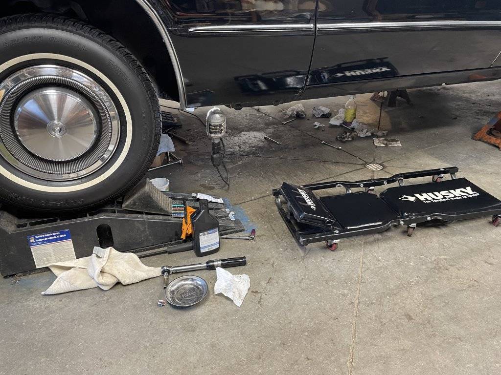

What I'm wondering is lifting the car with a floor jack and then sliding the ramps under the wheels as opposed to driving up onto them. Did the fronts one at a time with ramp portion towards front bumper, but wondering if I can lift the rear at the pumpkin so I can slide 2 more ramps under the wheels with ramp portion towards rear bumper so that the car is level. Ramps are oriented to not interfear with access to the underbody.
I hate ramps for the fact they slide also, just wondering if I can put them to use seeing they've been sitting in a corner of the garage for years.
