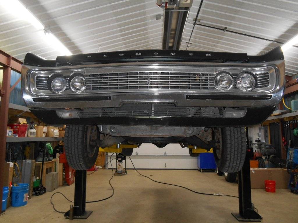

I have a 2 post lift and I've picked my Fury a couple of times....rock solid.No change in the door gaps at all.I put the pads right where the FSM says to and yes I have safety stands for both ends.

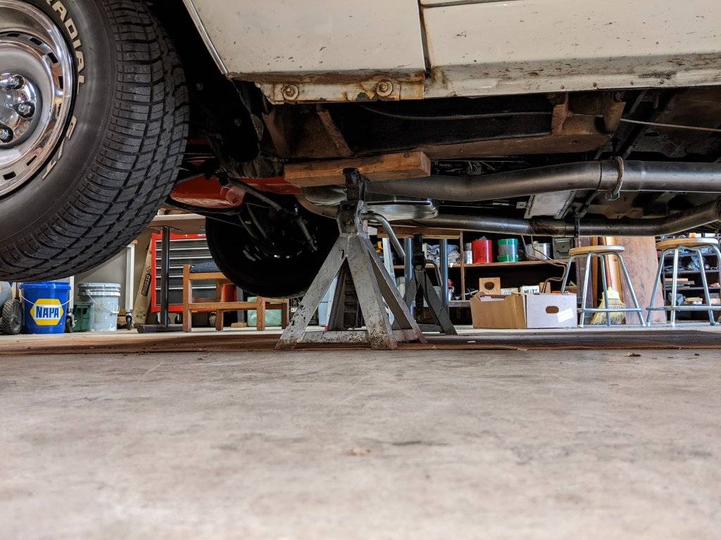

To jack the front of the car I put the hydraulic floor jack under the engine cradle portion of the front subframe. Jackstands, I put them under the front subframe to the rear of the front wheels. I usually use 2 by 4s on top of the jackstands because otherwise the ends of the saddle on each stand will leave small dents in the bottom of the front subframe.View attachment 584164
Like the 2× to spread the weight on the stub frame. Thoughts on improve this, a steel channel that fits over the jack stand saddle with a receiver welded in to prevent the saddle from moving. But with clearance to enable a little movement?
A steel fitting to hold the 2x4 would stabilize the set up further. I usually don't have the car more than 3 inches above the jack saddle, so if either end of the 2x4 tilts up, it contacts the subframe rather than falling off.
