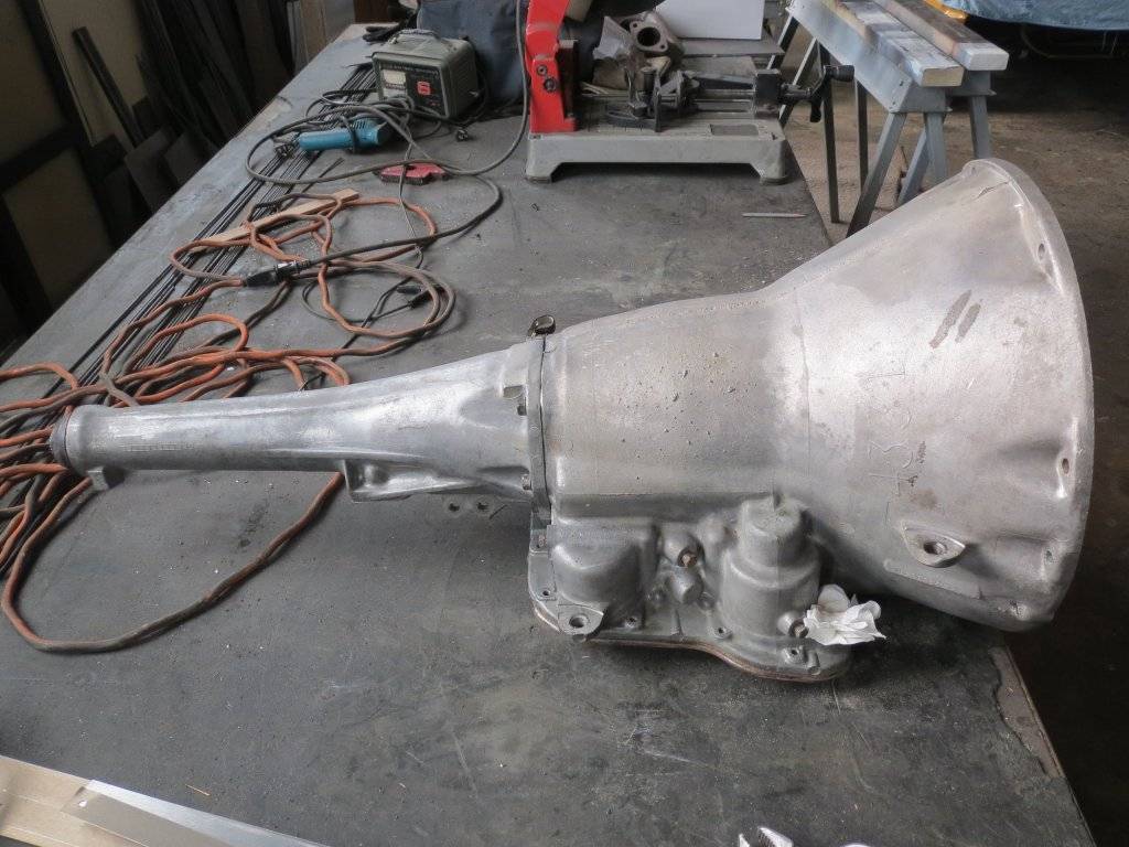

Here’s what I did to this one.
Here are the highlights
Here are a few of the improvements made to my trans. I found a used late '90s 46RE on Craigslist as a doner for some of the mods. The valve body got a shift improver kit and the oem steel check balls were replaced with the composite ones from the 46RE as they don't beat up the separator plate like the steel ones.
New TCI HP intermediate sprags.
New style dimpled input bushing in pump housing for improved oiling.
Replaced main output shaft bearing.
Back planetary set was replaced from the oem 3 gear set to the 4 gear from the 46RE.
Front clutch pack springs went from the 9 originals + 3 reds from the 46RE to = 12.
Front clutch pack bushing replaced with new updated grooved style for improved oiling.
Front clutch pack discs changed from 4 oem to 5 Alto-red .062 discs.
Back clutch pack discs changed from 3 oem to 4 alto-red .062 discs.
Kick down apply lever changed from 3.2 oem to 3.8.
New front and rear bands, good ones.
6 1/2" washers used as blocker in the low/reverse apply piston assembly.
Removed casting flashings from case(one was dangerously close to falling off which would have been disasterous)
This was all done by a close friend of mine whose a guru imo and I'm really looking forward to experiencing the performance of this trans

Wow! Where’s this guys at? I’ll send mine in for a freshen up..
Well unfortunately he’s retired but I don’t think any of it is rocket science. You could probably direct any trans guy to do the same if you provide the doner parts or it’s been said that they’re easy enough to diy with the right tools.

That picture looks distubing...maybe not a Hemi tranny????

You have to be careful mixing and matching planetaries from different years. The spline angles were changed at some point and while the parts might physically fit together, the spline engagement will be off.
From A+A's catalog:
Tech: 727 has three different spline angles, which is why we will ask what year the transmission/output shaft is. (1962-75, 1976-93, 1994-Up)
Kevin
Well the trans works very well but I will mention that to him next time we talk.
