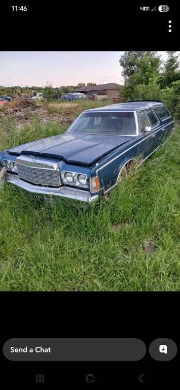

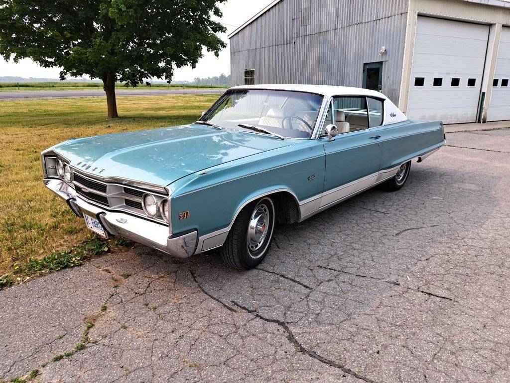

I just had a 74 Chrysler Town and Country fall in my lap. Will the the front disc brakes and control arms work on my 67 New Yorker? My 67 is a factory Budd brake car

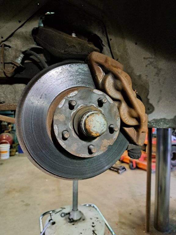

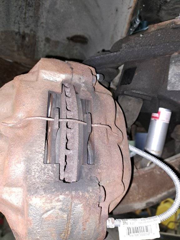

So, the 74 brake parts won't work on my car? Has to be 69-73? Its a complete car and everything is there.You can also source a '69-'73 C-Body disc setup and go that route. You will need to replace the spindle and lower control arms on you vehicle with the '69-'73 parts. The master cylinder and brake booster will also need to be replaced. The correct Bendix dual brake booster '68-'70 is getting hard to find. and you will probably have to have a junk yard unit rebuilt.

The Budd Brake systems use a different spindle and LCA. On a drum conversion, only the spindle needs to be changed. Chrysler went to a different brake system in '74 with a new caliper and mount. It might be possible to make the '74 system work if you changed everything, that is one I never tried. I am sure that the '74 booster will not fit because the shift linkage and valve cover on a big block will not clear.Maybe someone can correct me if necessary. I thought you had to use a 73 spindle only, to change a 67 68 drum car
