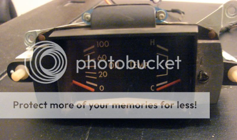

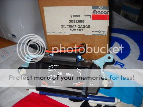

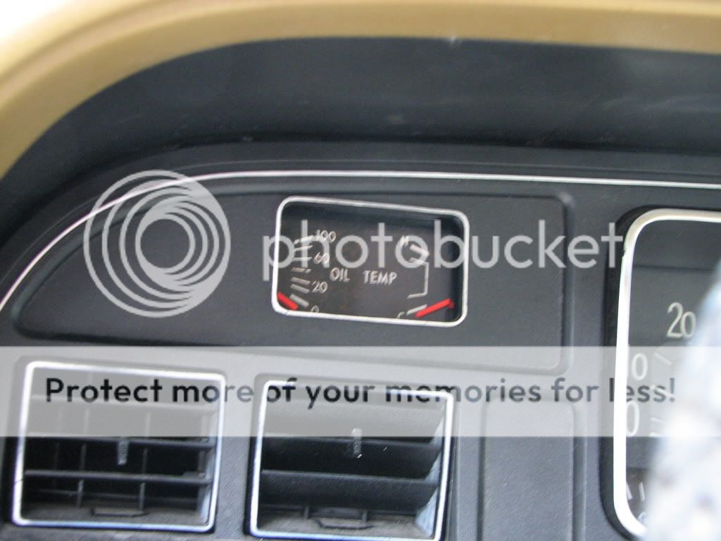

SONNOVABITCH
There it is.
An oil and temperature gauge right where the clock is supposed to go!
I bet nobody has ever seen one.
I was already looking before scrolling down to this post. LOL!
What's the part number for the oil pressure sending unit?
Don't think knowing a part number is crucial. Just ask for a sending unit for a car with a gauge and not an idiot light. Gauge sending units are big suckers, while the light senders are those little ones most cars have.
One last question on this '74. Anybody have the owner's manual for the car ? Do you still get a light when you get the combo gauge? If so, then you'll need that lovely brass tree that screws into the block and has threaded fittings for each of the two senders.
