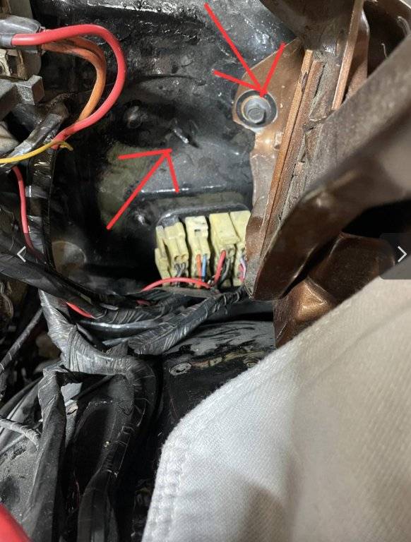

Where does this shield go? I can't find a picture (yes, I looked in the FSM and parts book) where it attaches or even if this is the correct piece. It's supposed to be a shield to protect the bulkhead connector and I first thought it went above, but I think that's wrong.
Anybody?? A picture would tell a thousand words here.

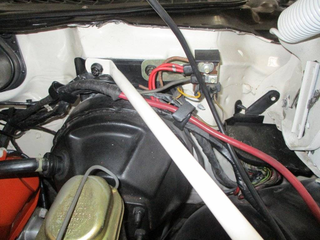

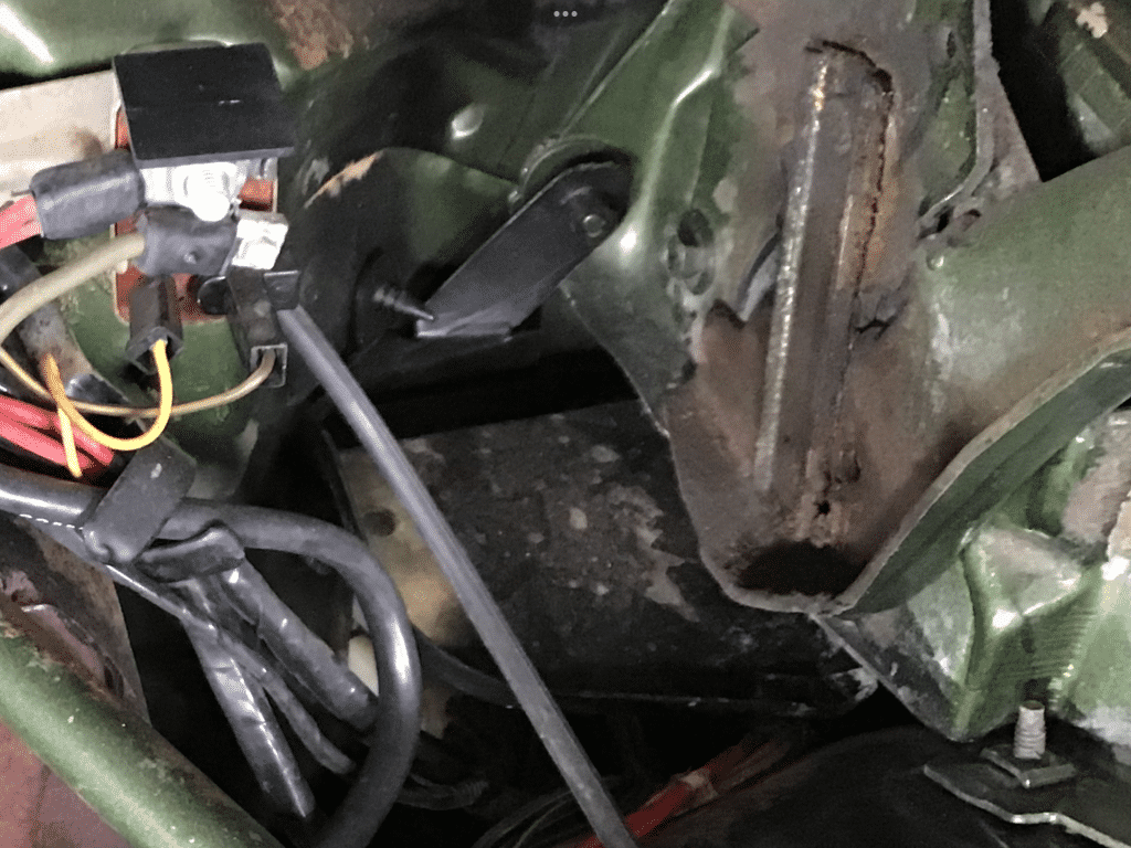

One hole snaps over that hinge bolt. The other grabs the pointy plastic stud holding firewall insulation behind the dash.
You know, I looked at the plastic stud and said "no way" would they attach something to that. Ah well....

I swapped the bolt for a stud that I procured from my box o' bolts. The plastic was cleaned and a quick coat of black.
It all fits nice now. Seems easy to remove and replace as needed and reasonably secured in place.
