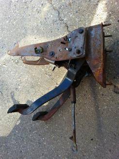

I have to disagree Stan...Here's a set from a 68/69 B-body...
attachment.php
Close but not a match.

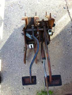

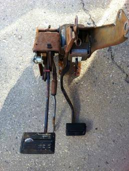

Here is a set up I personally pulled from a 1970 Sport Suburban wagon, It was manual trans, manual brakes, manual steering, radio delete but has Climate control. I converted it to an automatic with power steering/brakes. I was going to use this swing set to convert my Sport Fury GT to a four speed. 20140616_102441.jpg20140616_102505.jpg20140616_102516.jpg20140616_102532.jpg
