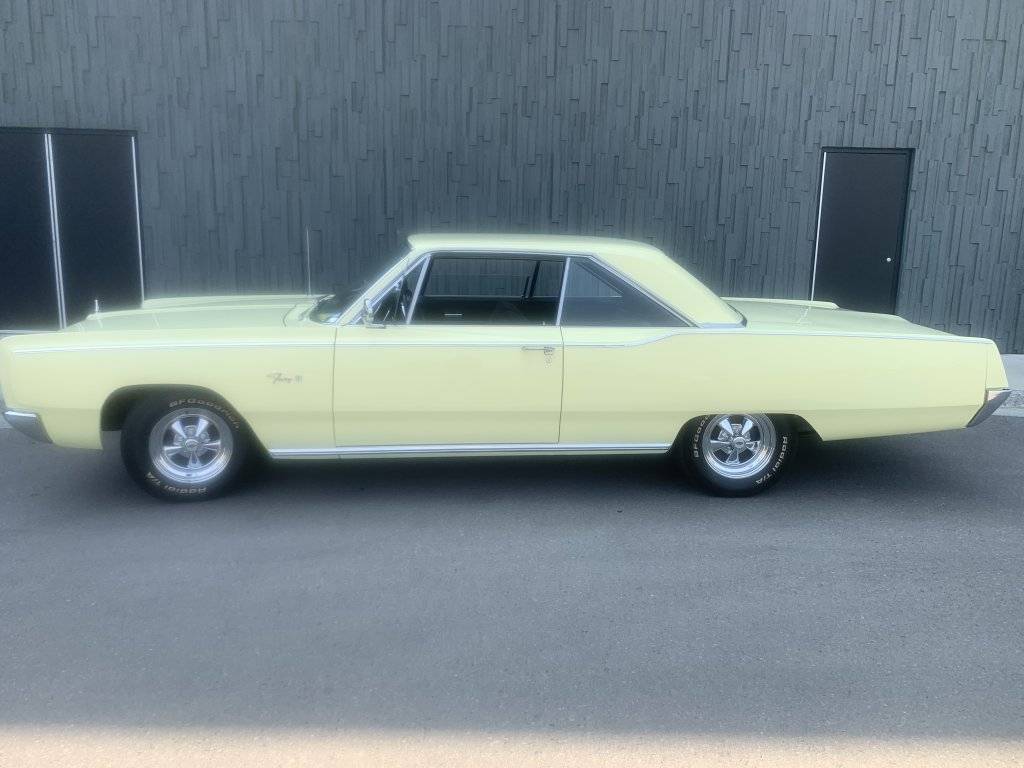

Figured I had better post a picture of the ride I have been talking about!
Oh I have the hubcaps with redline bias ply radials that were on it when I bought it.
Believe it or not....even have the 60yr old original spare tire.
Yeah not really looking to teplace the Poly yet.
Just trying to change things on the exterior without changing anything on the interior engine components.

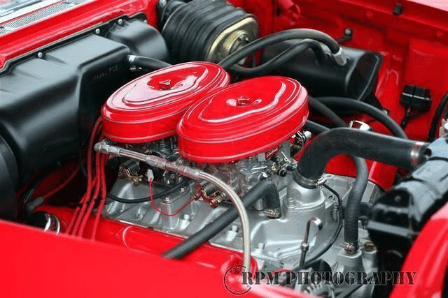

getting the factory oval air cleaners would nice. the carbs sit so close together the diameter of round air cleaner housings is limited. this picture was posted by member @7mag Dual quads 318 poly feaseable?View attachment 608438
You can buy repops of them.
FRP versions Find FRP DUAL QUAD OVAL AIR CLEANERS MOPAR CHRYSLER PLYMOUTH 1958 1959 1960 1961 HEMI in ATHENS, Attica, GR, for US $290.00
Steel versions Nick's 1960 Chrysler 300F Page
Never did business with either vendor.
nice. the only thing to keep in mind is that the air horn diameter of the original carburetors is smaller than the modern carters. the first set has this note: *Includes two 5 layer frp bases (You will have to cut the base hole to the dimensions of your carburetor system.). the second set seems to be just o.e. dimensions. both are beautiful.
Yea, that's right. I didn't think about that the modern Edelbrock/Carter AFB clone would have a larger air horn.
I'd go with the FRP versions myself.
