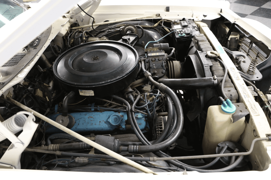

Just went through the photos, you have a great solid car to bring up to snuff. I would not swap out the manifold and carb. You can block the EGR by just capping the EGR vacuum line with a small ball bearing or some aluminum foil over the nipple, then slip the hose over.

I saw the missing belts. If the AC compressor is seized, that might be when I would go with a new AC conversion. But the Mopar electronic ignition is a very good ignition, and the Thermoquad can and is a great carb.

Thank you! You are the fourth person to say that and that’s the reason I took a gamble and bought this car. Streetside said the AC didn’t work and there was no AC belt when I received the car. A mechanic (that I trust) told me it was seized up and it would be better at this point to take it off. Upgrading the AC is a year or two away. I didn’t mention it earlier but I have a shelf in my garage dedicated to storing all the original parts.

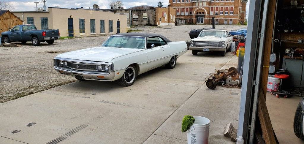

Nice looking car. Take your time. She will let you know what she needs next. I got my 69 Newport alittle over 2yrs ago. She sat for yrs in an old Indiana firehouse. Took us a month to get her reliable. When we put on the 4 bbl the fuel pump wasn't strong enough. Hold off on the big things for the months when you can't drive her. Next winter mine is losing the vinyl top and getting rid of her 20 yr old Earl Shibe paint job(found the touch up can in the console). Unless you are planning to flip her don't worry about what it's going to do to resale, make her yours. I've put 7k miles on mine and she runs stronger every time I have her out.

No, going to leave her white. May do something like this. If I remove the vinyl top, it needs some color to break up all the white. I have a set of 300 tail lights and back bumper to put on her.
