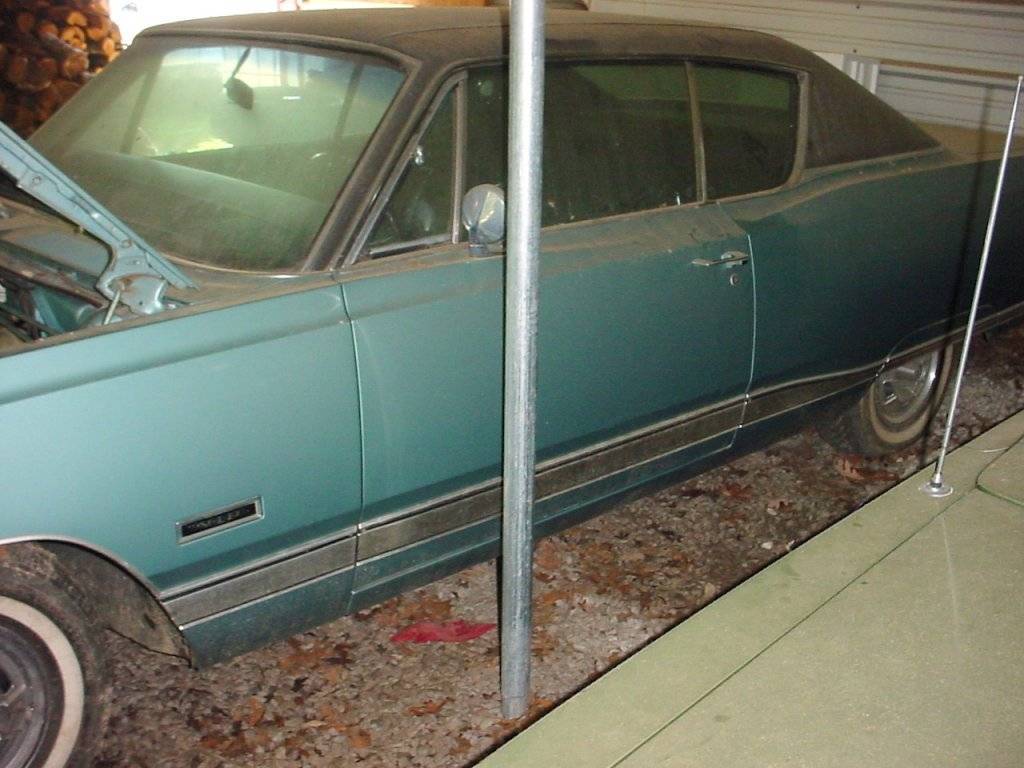

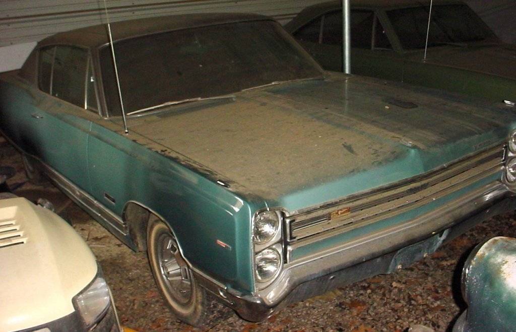

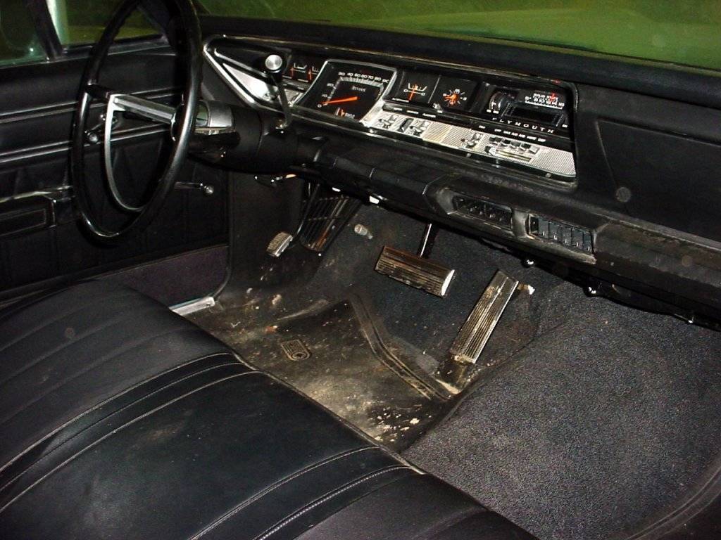

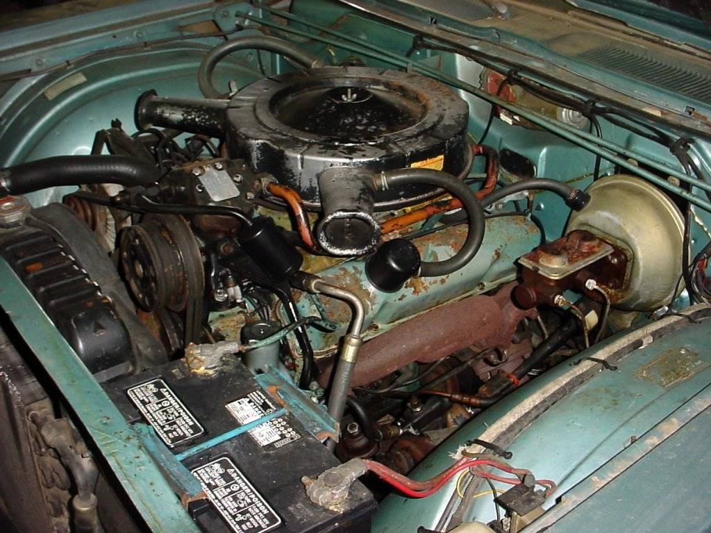

I have a friend in Crossville Tenn that has a 68 VIP. It's a nice original 20K mile car with one repaint. I'm sure he would sell and I considered it myself. I have no idea what he would want for it but, if interested, I could hook you up.
The car looks much better now. I shamed him into cleaning it and parking it in a building. It really needs a new home.
