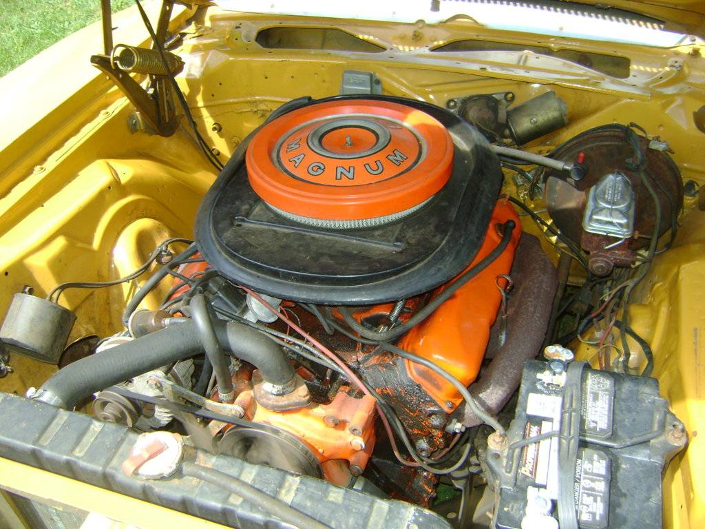

In the early '90s I built a stock 440 from a '75 Imperial with hardened valve seats, Street Hemi valvesprings and the P4286676 cam (272/.455/112) and it ran great! Loped a little cold but smoothed out nicely warm, good vacuum and great bottom end. I used it in a '70 D200 CamperSpecial with 3.54 (Dana 60) gears and a 727 with the 12" Imperial stock torque converter. Later a friend got it and the matched lifters in a trade we made, and used it in several 383's, including a 3.23 geared 4 speed '71 Super Bee.. :)
