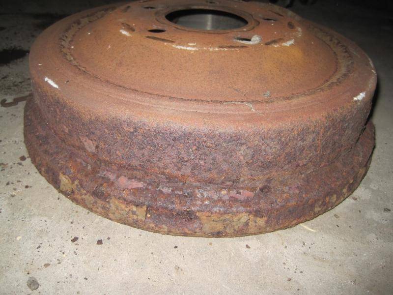

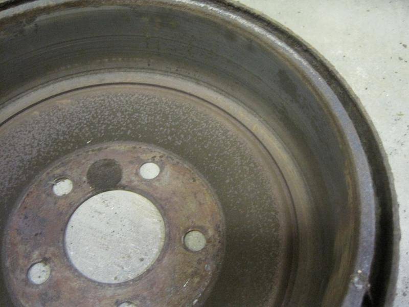

I got my rear drums off. The interior looks great I have turned and balanced other drums which were not nearly as good inside. My question lies on the exterior. There is a decent amount of flaking rust.
Next question, I was thinking of taking a wire grinder to it first, to take off any loose rust, and then have it turned and balanced. Does this seem logical and can you paint drums with a product like POR 15 or does that effect the cooling of the drums?

My #1 rule for almost 40 years as drilled into me by my mentor on every brake job, no exceptions:
New linings? Turn the drums. Nothing left to turn? New drums. period. End of story. He ran a tight ship, err... garage. So, good for you.
Paint? Why? I call what's on there now as a protective coating. Those drums are good to go after wire brushing.
