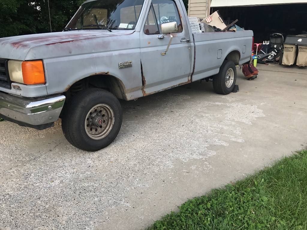

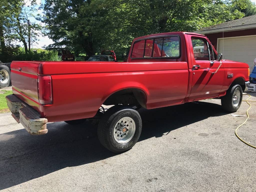

We painted my youngest son's truck when he was out of town to surprise him. Harbor Freight purple gun with Rustoleum thinned with acetone.
Truck got destroyed a month later when a woman ran a 4 way stop.
