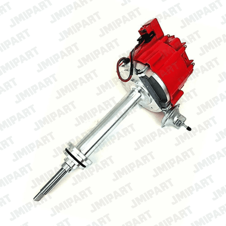

These GM HEI distributors work well in the Mopar big and small blocks. And, they accept the 7-degree while cranking retard module. All service parts are at the auto store up the street.
