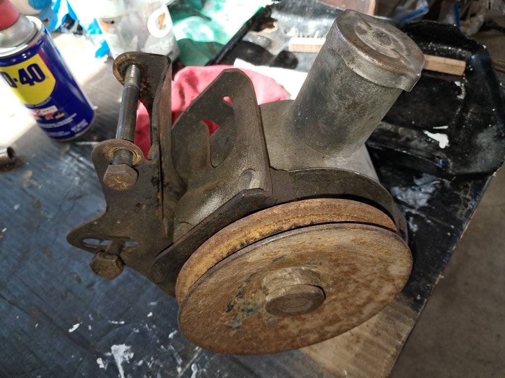

To complicate things further, there are 2 styles of TRW pump, large and small.
Large has hex fitting at center of pulley. Small does not.

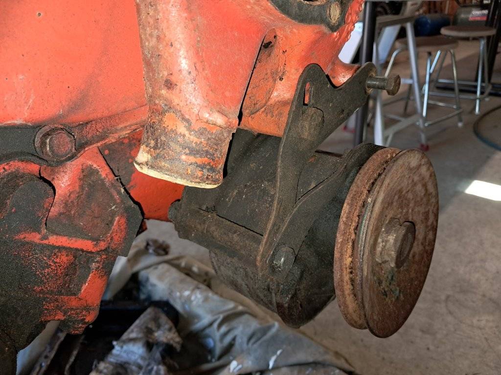

My 1967 TRW large style pump (pulley is bent, but hex fitting clearly visible):
