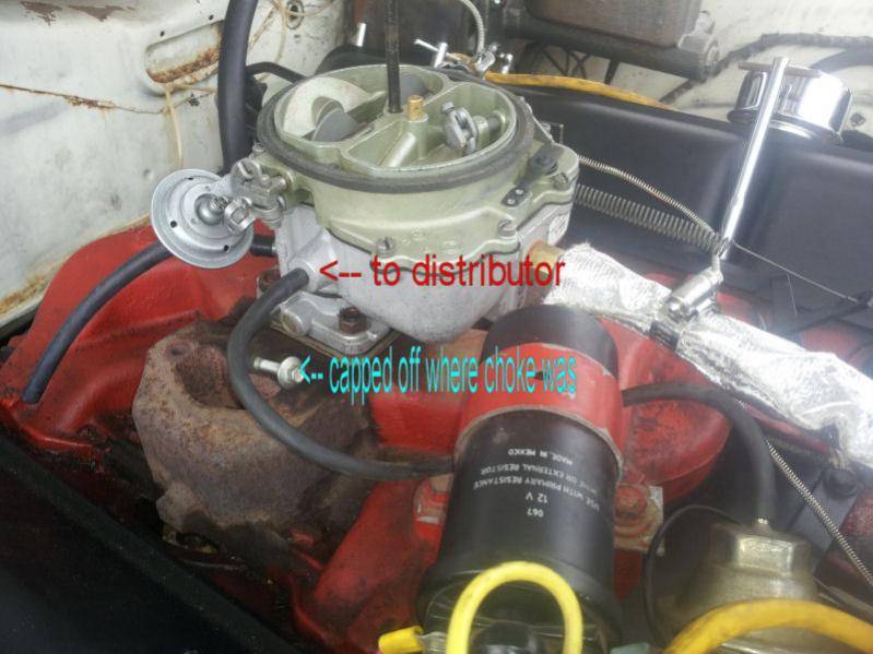

im guessing the choke is open, it had a manual choke rig on a wire mounted to under the dash with a pull knob before.
the replacement carb has a vacuum pot thing on it with a line going to a carb port - I haven't touched it from how it was shipped to me.

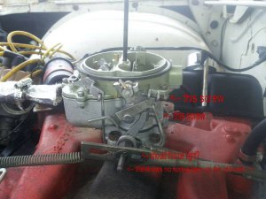

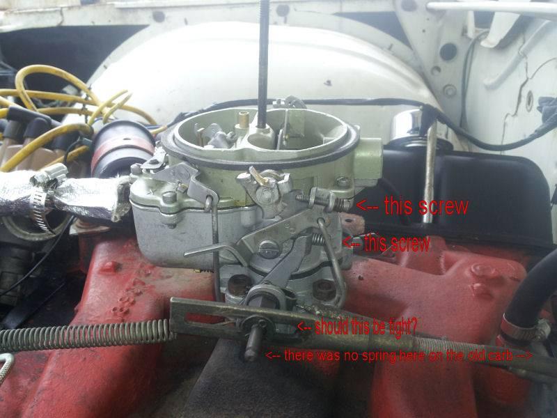

i cant get this thing to idle well. ive never adjusted a carb before. tried the settings as it came from summit. no good. tried adjusting all day long, still no good. I don't have a vacuum gauge, was trying by ear and smell.

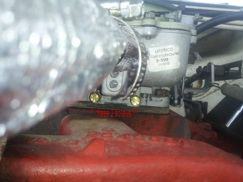

can yall help me identify this stuff in the pictures and discuss settings? Thanks !!
The two upper screws in the first photo are your idle RPM screws. The two in the next photo are your idle fuel mixture screws. Tighter is leaner; looser is richer. They aren't currently matching (and should be) so a good place to start would be to finger tighten both of them all the way and then loosen them both three turns and tune to suit.
The hose that should be going to your vaccum choke pulloff is currently going nowhere and probably leaking a bunch of vacuum. This is bad because your choke isn't going to pull off ...and because it is probably leaking a bunch of vacuum.
thanks! the mixture screws don't line up when both seated one is \ and one is -
this is a new carb from summit... should I send it back? I figured as long as they were both 'out' the same amount of turns id be good.
the choke connection is where the screw-plug is ...plugged on the vacuum side, the dangler off the choke is just a dangler, I think it has to suck in (vacuum) to do anything?
and I sucked on that line, and it pulled in..but pulling in did NOTHING with the butterfly valve.. its like backwards or something.. I don't understand it yet.
the choke pulls off or pulls on? should I just hook it back to vacuum ? the old one was manual on a wire... so I have no idea
Normally the choke is completely closed while starting and once it actually starts the vacuum pull off lets it come off just enough to idle. After that you should have temperature or electric pulloff that slowly opens the choke the rest of the way. Wide open means choke is fully off. You may need to adjust your initial pulloff. The choke should fully close and then open a little bit with the vacuum. There should be a rod you can bend if it is out of adjustment. (Some old timer feel free to chime and correct me if I'm saying something wrong: this is my best attempt at articulating my possibly limited understanding.)
As for your mixture screws, if they don't match then ignore what I said about them matching and just keep them the same number of turns from fully seated. (Now, if it were my carb and the screws didn't line up right... my selective OCD would probably be off the charts.)
when im idling in park, then put it in gear, the idle speed drops. what lever or screw makes this drop happen? I get it to idle OK in park, then put it in gear and it feels like it wants to drive away pulling, then dies.
The idle drops because the torque converter puts a load on the engine. How does it die? Does it get slower and slower and then quit with a raw gas smell or does it get rougher and rougher and then go kaput. The first would be too rich, the second too lean.

I put the choke pulloff hose back on.

on the 2 mixture screws in front,,,
are they a left side air/fuel and a right side air/fuel ?
or is the left side fuel amount , and the right side is air amount ? or vice versa?
well, update.
for the question above ^^ they are equal screws both need to be adjusted fuel/air mix. one is not fuel only and one is not air only, they are both air/fuel mix.
